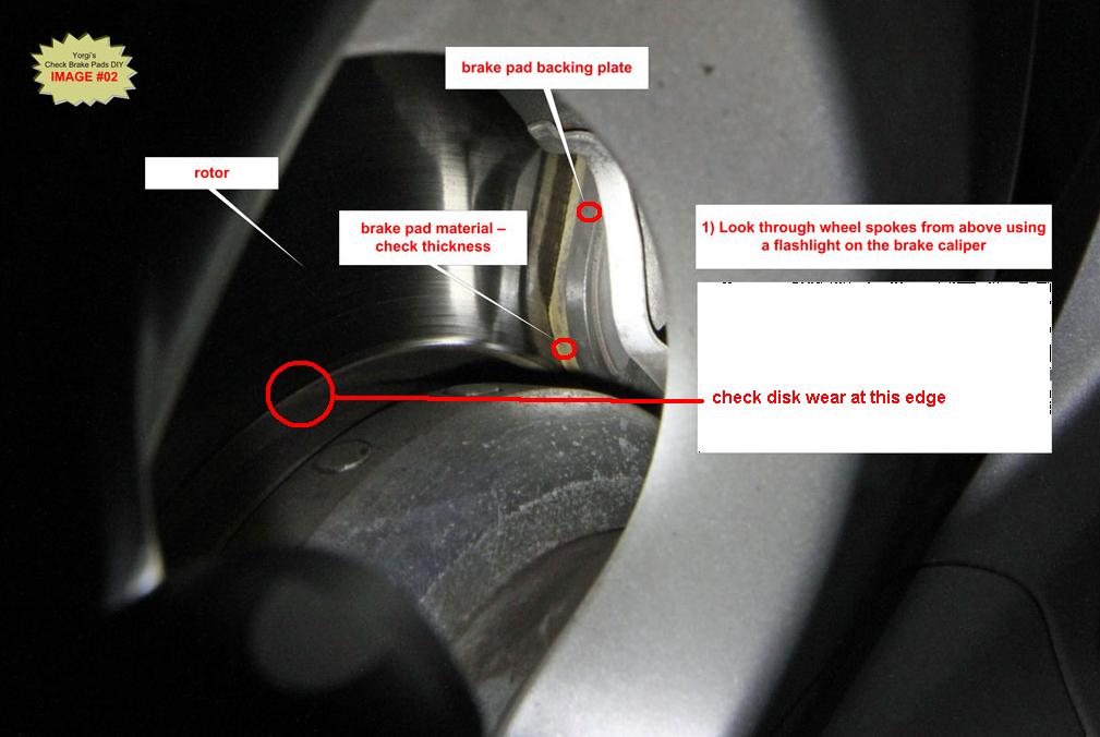

First thing to remember, replacing brakes is the favorite job a mechanic will 'recommend'. In other words, few people know how to check their brakes for wear, and garages will often times replace them when still good.
I'd suggest having a look or taking a picture and uploading it here. There is no exact mileage where brakes need to be replaced on a specific car. It all depends on how the car is driven. I can drive a car for 100K with the same pads and discs in city driving. Another driver may need new pads after 15K miles.
The pads are easy to inspect for wear by looking through the wheel spikes. Same goes for the discs by looking how deep they wore comparing the center portion with the inner side portion (where the pads don't touch). In my opinion, if the discs are still good, there is no need to replace them just because new pads are installed.
