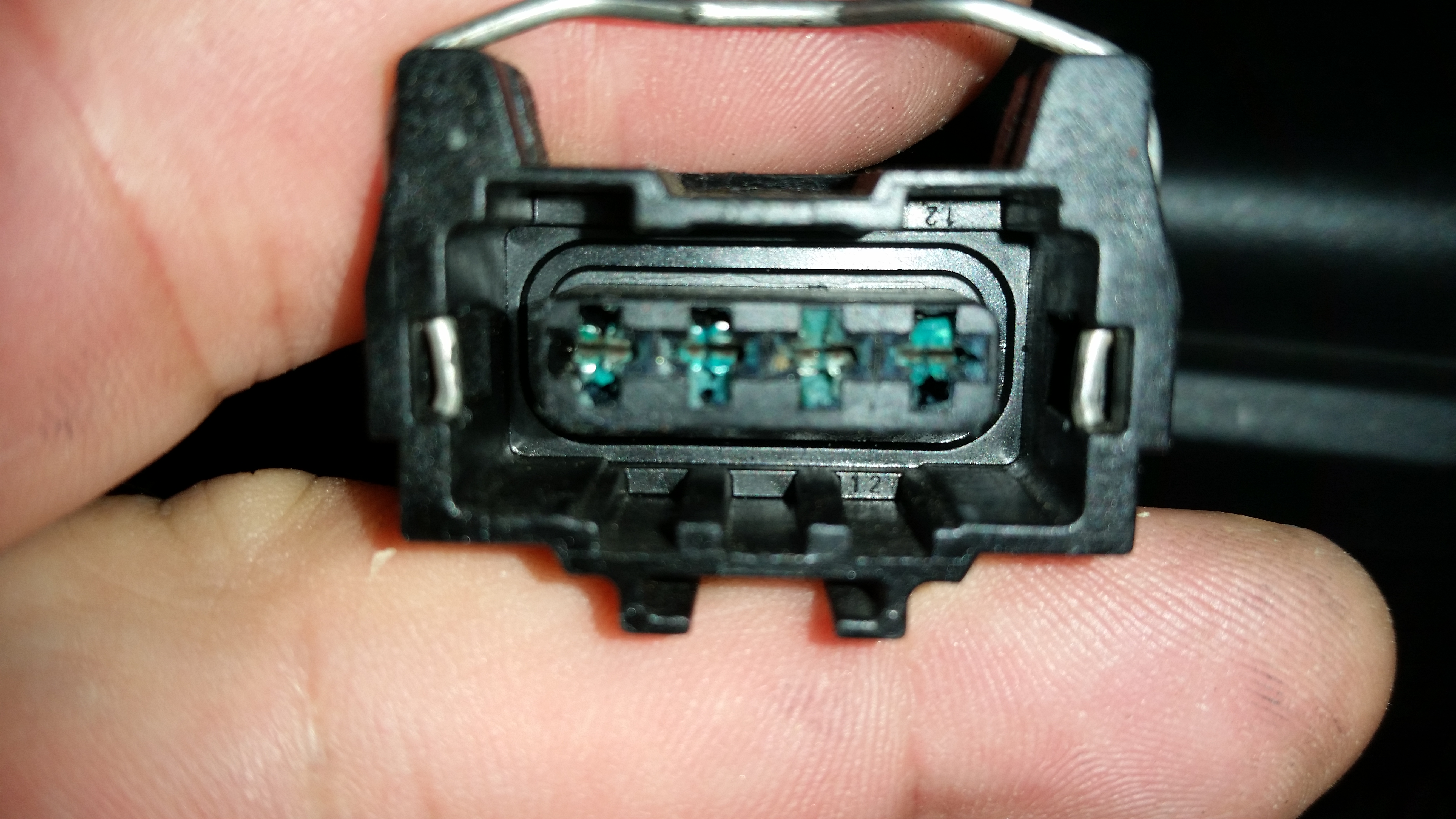

So, am I to assume that the MAF sensor that the guy installed is junk? Also, I am attaching a picture of the MAF sensor connector, because it looks to me like a plastic tab inside of it is missing. Does anyone think that this could be the issue? I don't want to buy a new MAF sensor if it isn't going to solve the problem, of course.

If the MAF sensor is not Bosch that seals it, it is junk and must be replaced. If it is Bosch, then more troubleshooting may be in order. The connector looks OK to me but I may be missing something.

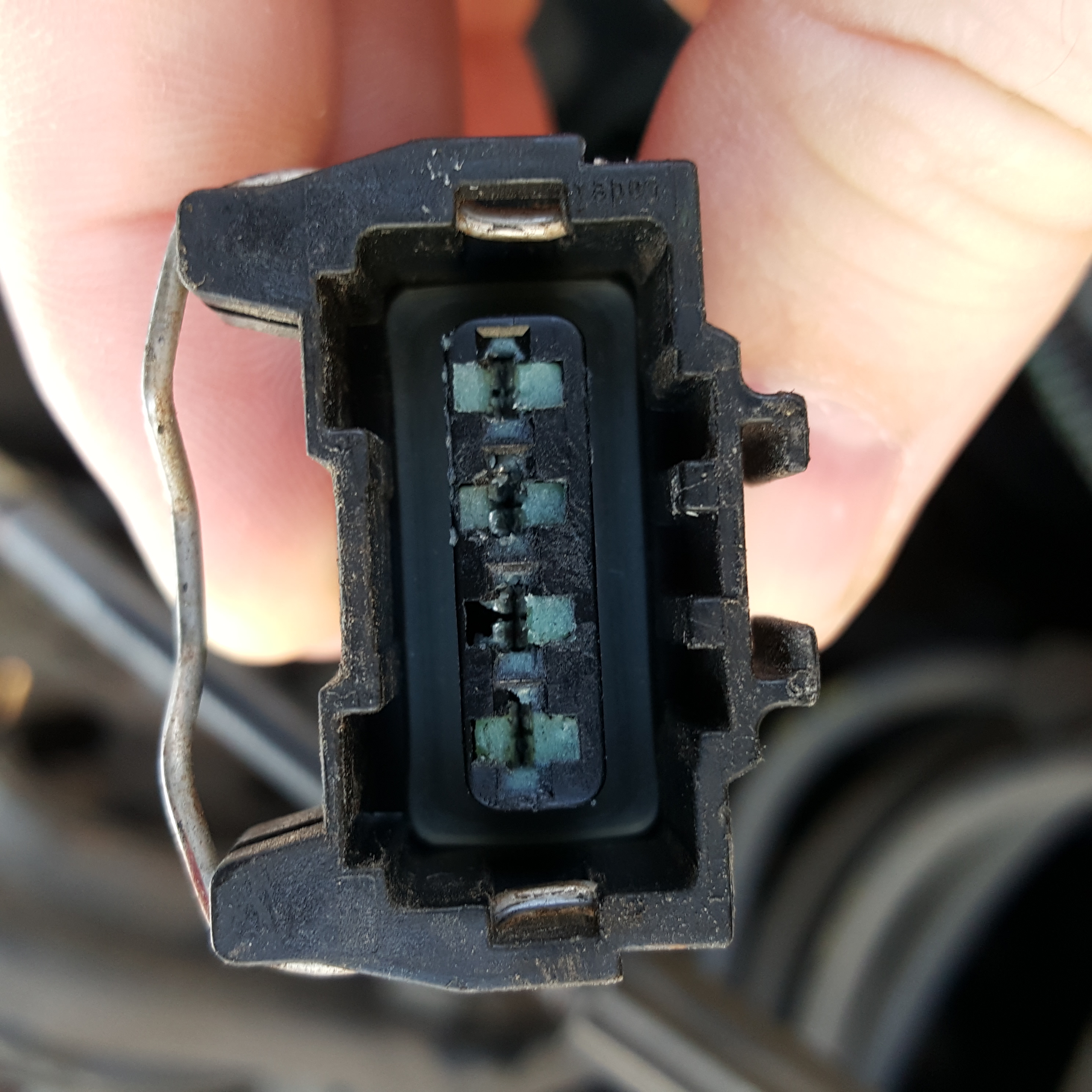

If that connector is bad you will waste money on a new MAF
Can someone with a 1998 snap a pic of your connector to compare please?

Is that green gunk corrosion? If so, you have to get that off those connections
