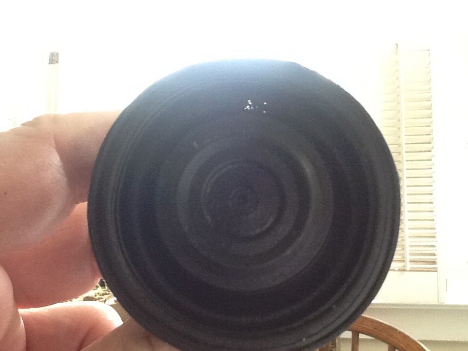

On my daughter 98 V70 AWD I noticed that there was little of no noticeable kick in the turbo charger. Was not throwing any codes, TCV ops checked good and the three turbo lines were only a year old. After some research I came across IPD vidieo on the bypass Valve or the diaphragm being torn. This car was showing all the symptoms of a torn diaphragm. After removing the intake turbo pipe and some hoses there were three 10mm bolts holding on the compressor bypass valve cover. After removing the cover the diaphragm and spring easily came out. Upon inspection of the diaphragm found no tears but chaffing causing holes letting air thru thereby providing little or no pounds of boost.
The IPD kit contained three springs, stock, slight upgrade then aggressive. I choose the middle spring. Install was straightforward. The step by step pictures and narrative included in the kit were outstanding.
The car has regained it's performance. It was a noticeable difference.

Great post, this problem is more common than people may realize. Almost all of the original CBV diaphragms have holes in them, every one I've checked so far.

Mine had a small hole at 211K miles. This should probably should be added to a "Stage 0" workscope. It's inexpensive enough and easy to replace.
