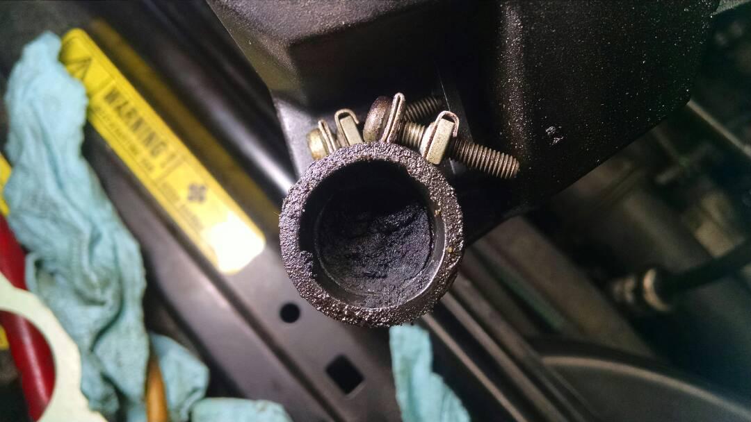

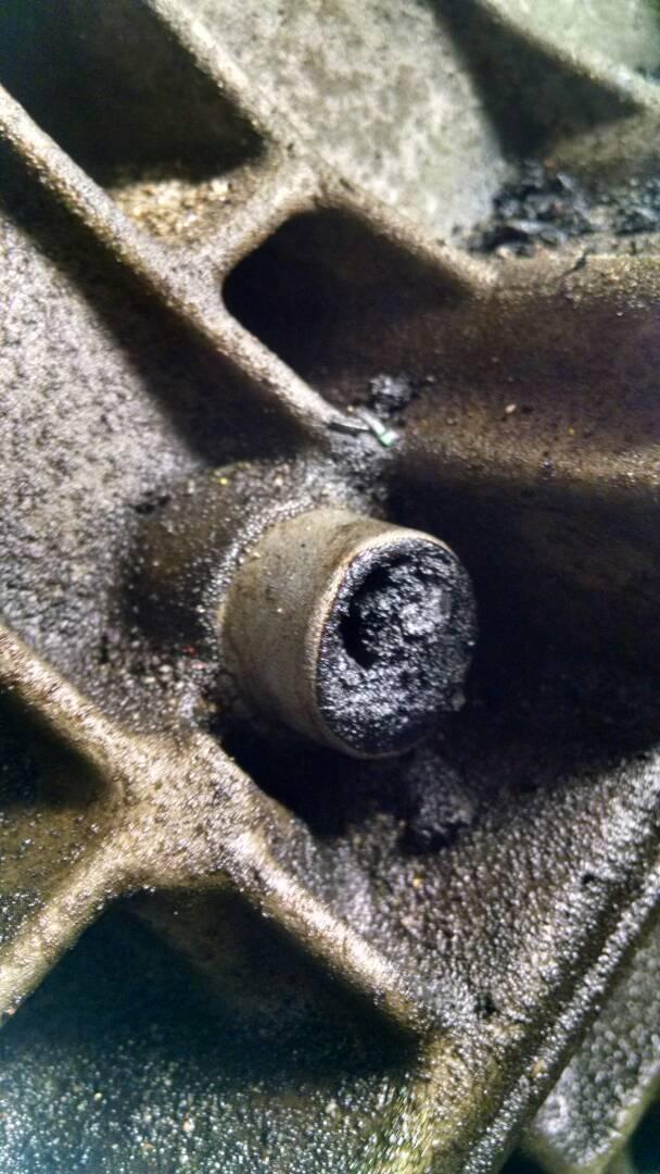

Post by Googs1080 »
Here were the clogged ports!  Wow
Guess gotta chamge the pcv every 100k regardless. Wow
Posts: 36149
Joined: 17 Feb 2013, 17:54
Has thanked: 1610 times
Been thanked: 4067 times
That's a severely oil change neglected engine. The PCV on P2s doesn't clog like P80s...mine was clear at 175k and didn't really need changing.
