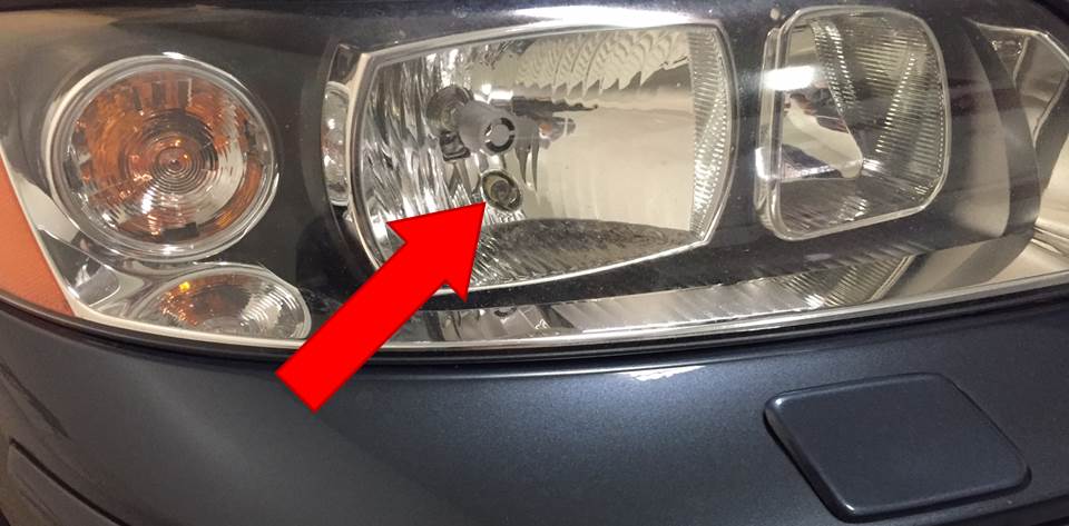

Does anyone know the specs on the bulb (see pic below) and can suggest a good way to get to it short of removing the entire head light assembly? I can get the wiring harnesses out of the way and remove the dust cap, but the CPU box sits right behind blocking all access.
Vehicle - 2007 Volvo s60 2.5T, FWD.
Thanks in advance for your suggestions.

Pop the CPU box out to get access. You do not have to remove the e/TCU, just remove the case
It's really tight with P2s, which is why you get that beautiful hood line and. Drive visibility

This should help you ID the bulb:
http://volvo.custhelp.com/app/manuals/O ... /om_id/427
(See Page 207 in Specifications)
Let's hope you have small hands and thin fingers... (Our cars seem to have been built around any given part that requires service)

I had a horrible time getting out a P2 bulb ..wrote a thread about it. It had an extra piece of metal flash that I had to trim off
