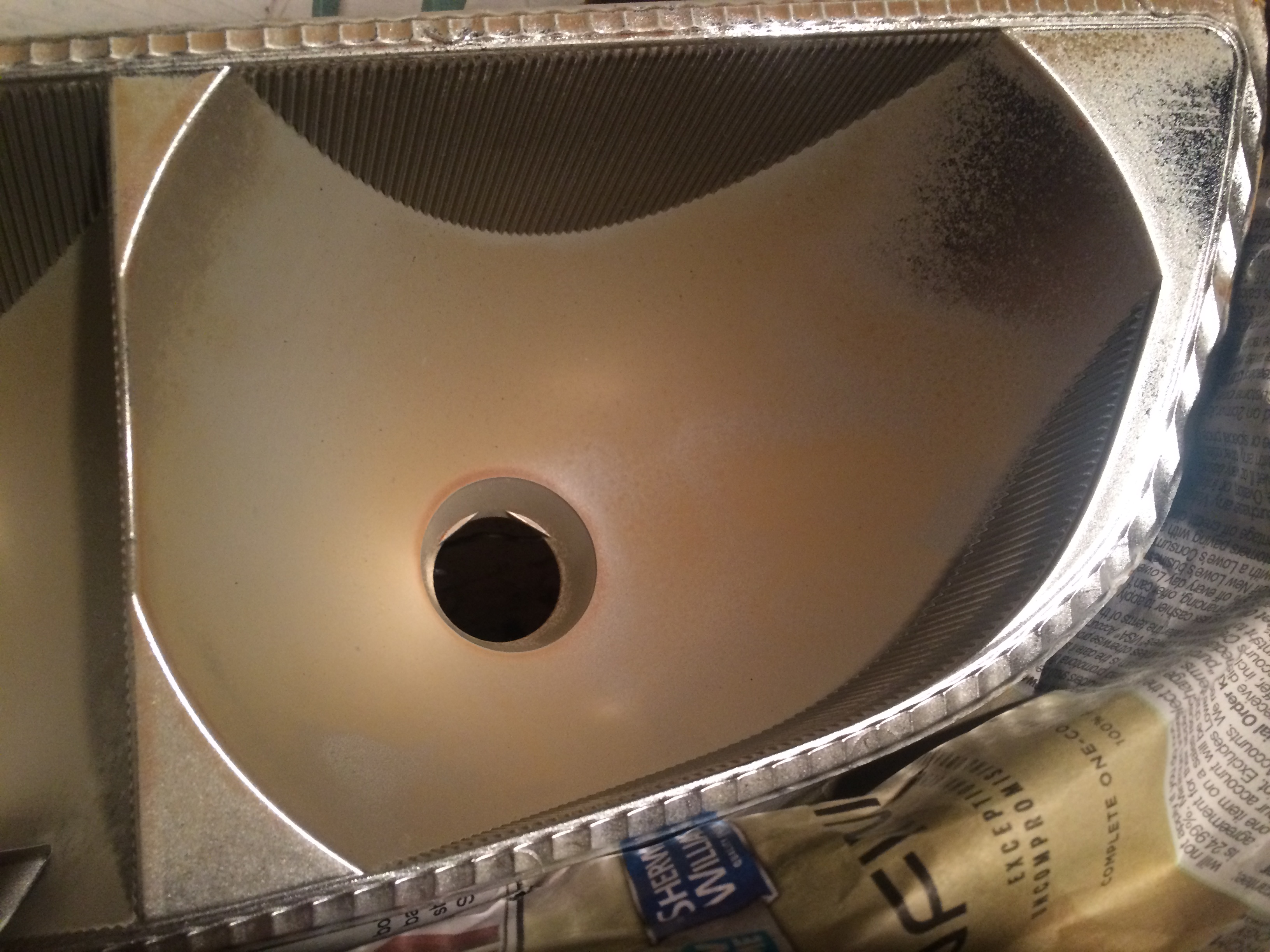

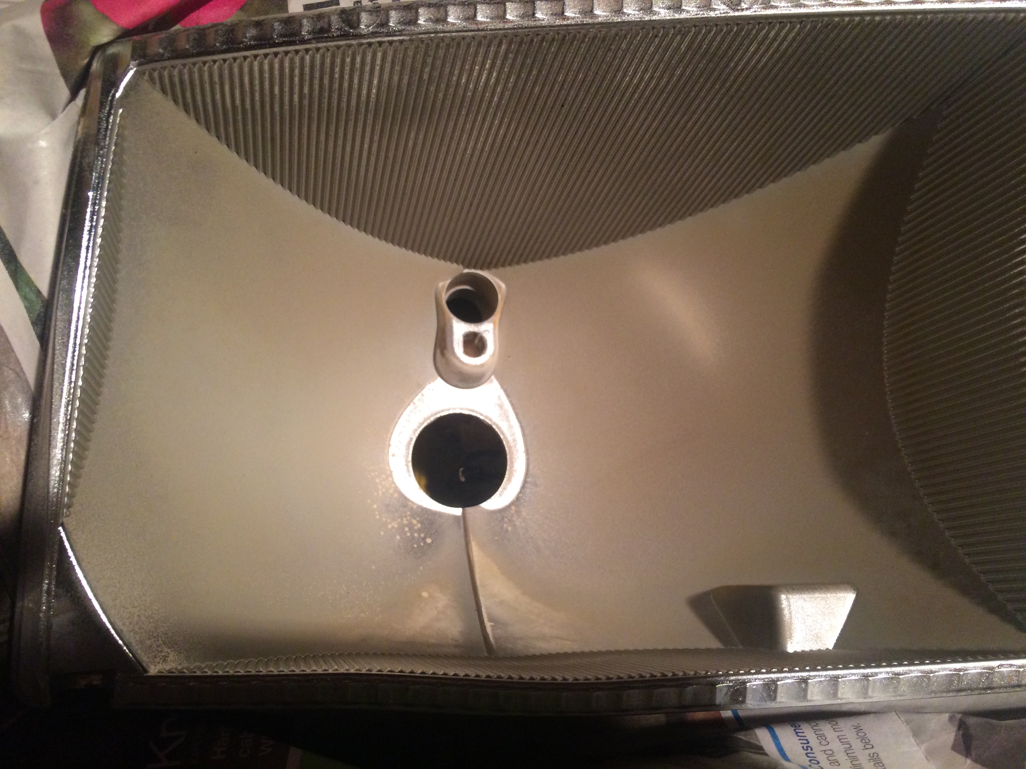

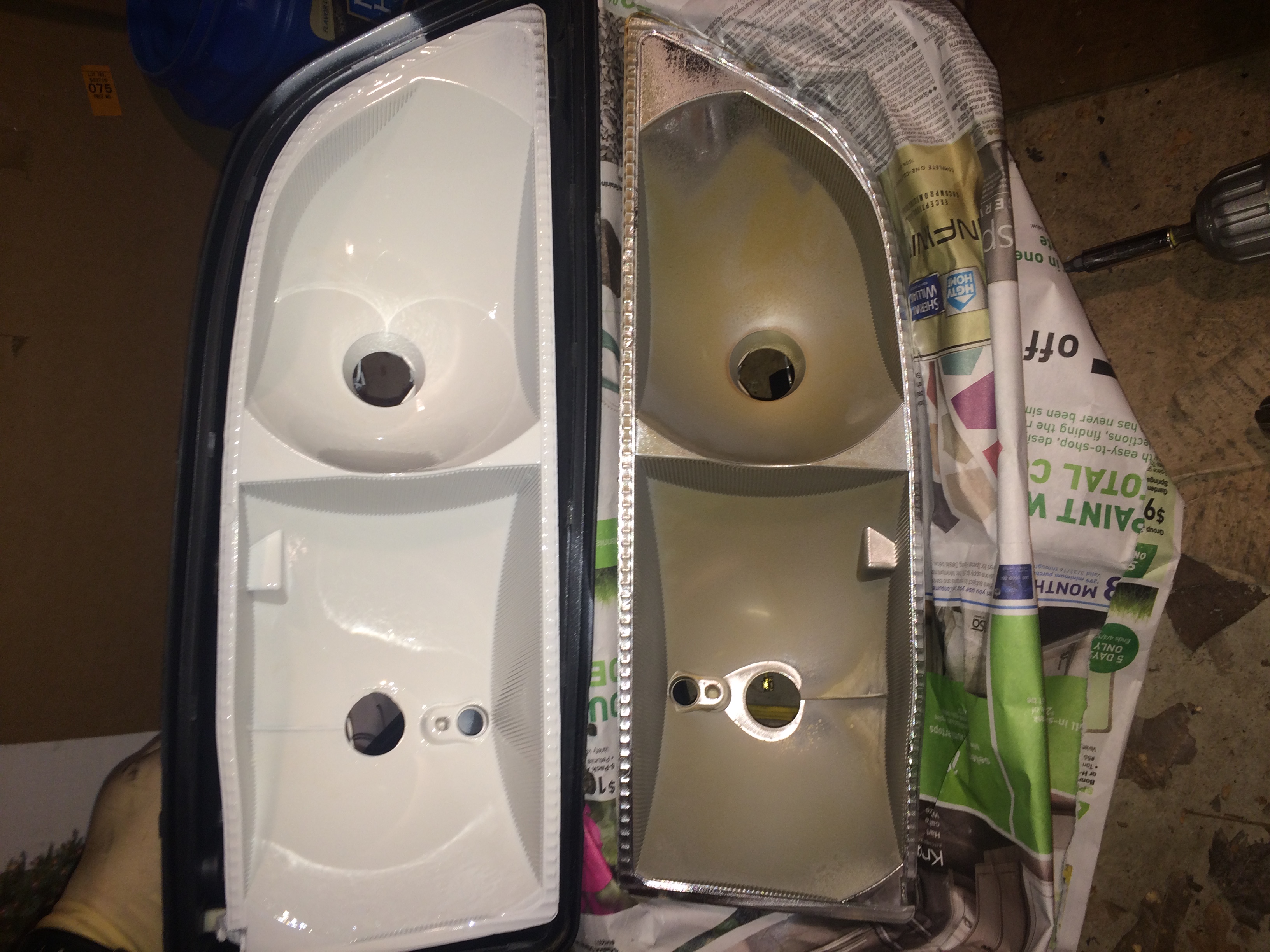

Painted faded reflectors gloss white, helped some.
Ordered a pair of TYC with glass lenses ( ~$150 for the pair. I couldn't bring myself to drop the big $ on the beautiful C-70 jewel upgrades).

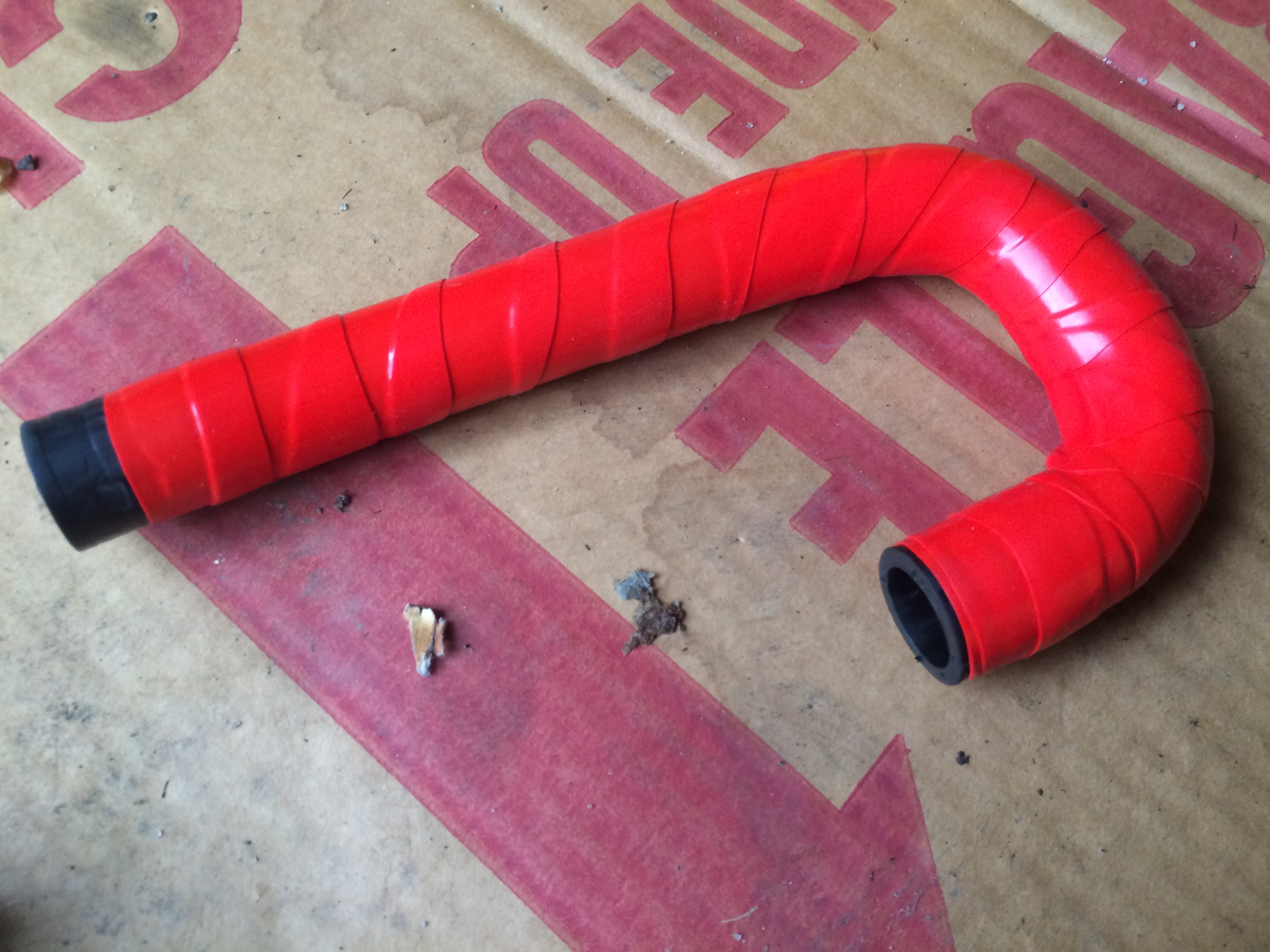

Made a side-of-the-road repair (with self-stick silicone tape) to the infamous J-tube EVAP hose (which hopefully clears teh P0455 Gross leak EVAP code, the only code currently keeping me from registering it!)

Looks good. Interesting painting the inner lamp surfaces white. There's an excellent write up for replacing the head gasket in the diy's. My one question is are you replacing both your headlamps or just the glass and gaskets for $150? They have the lenses ala carte for around $45. Best of luck with the restoration it's a lot of work but its enjoyable. Take advantage of the treasures at your local salvage yard as well.

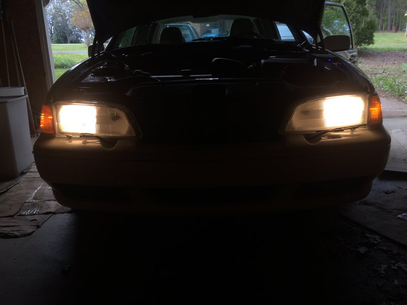

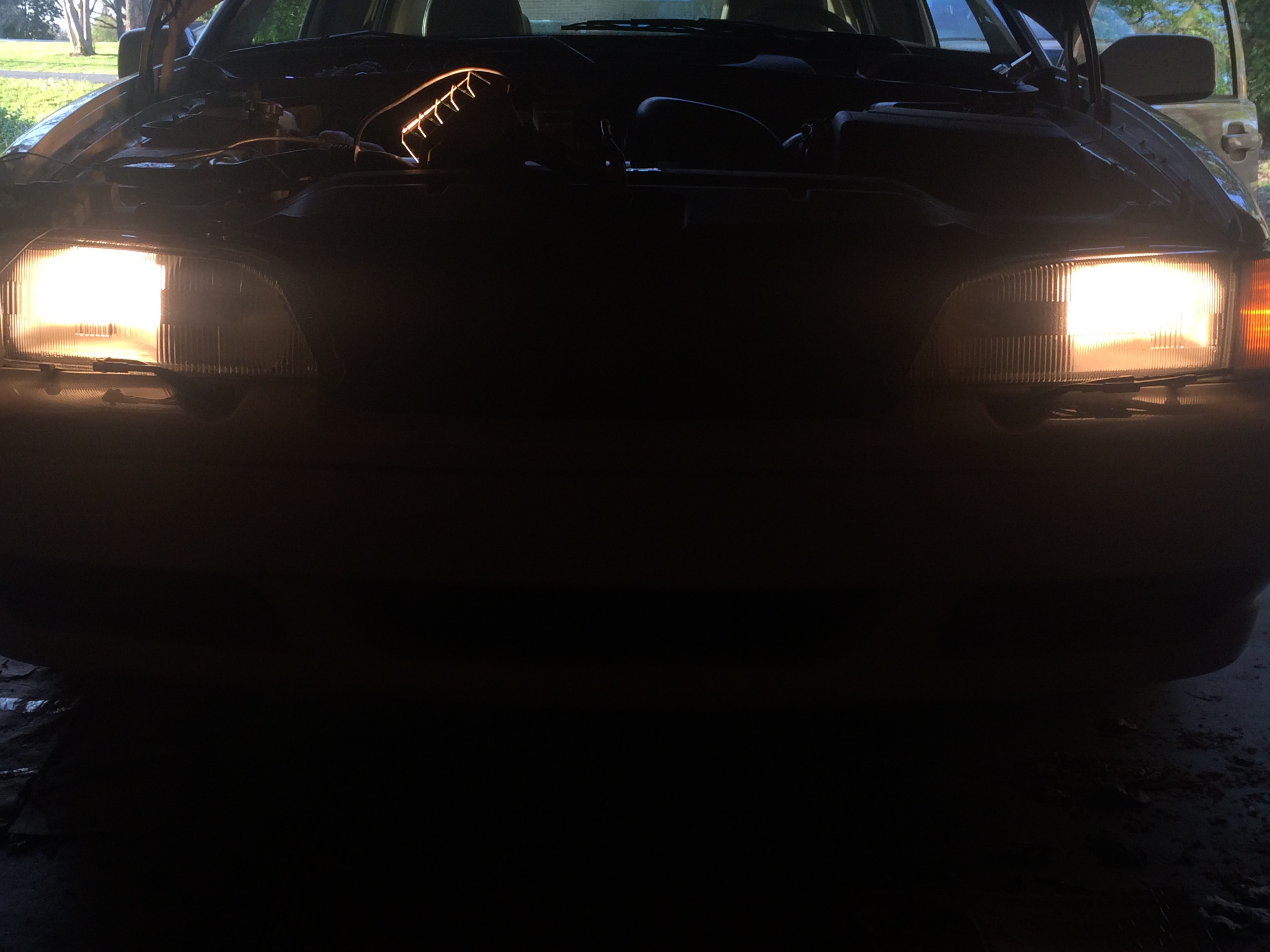

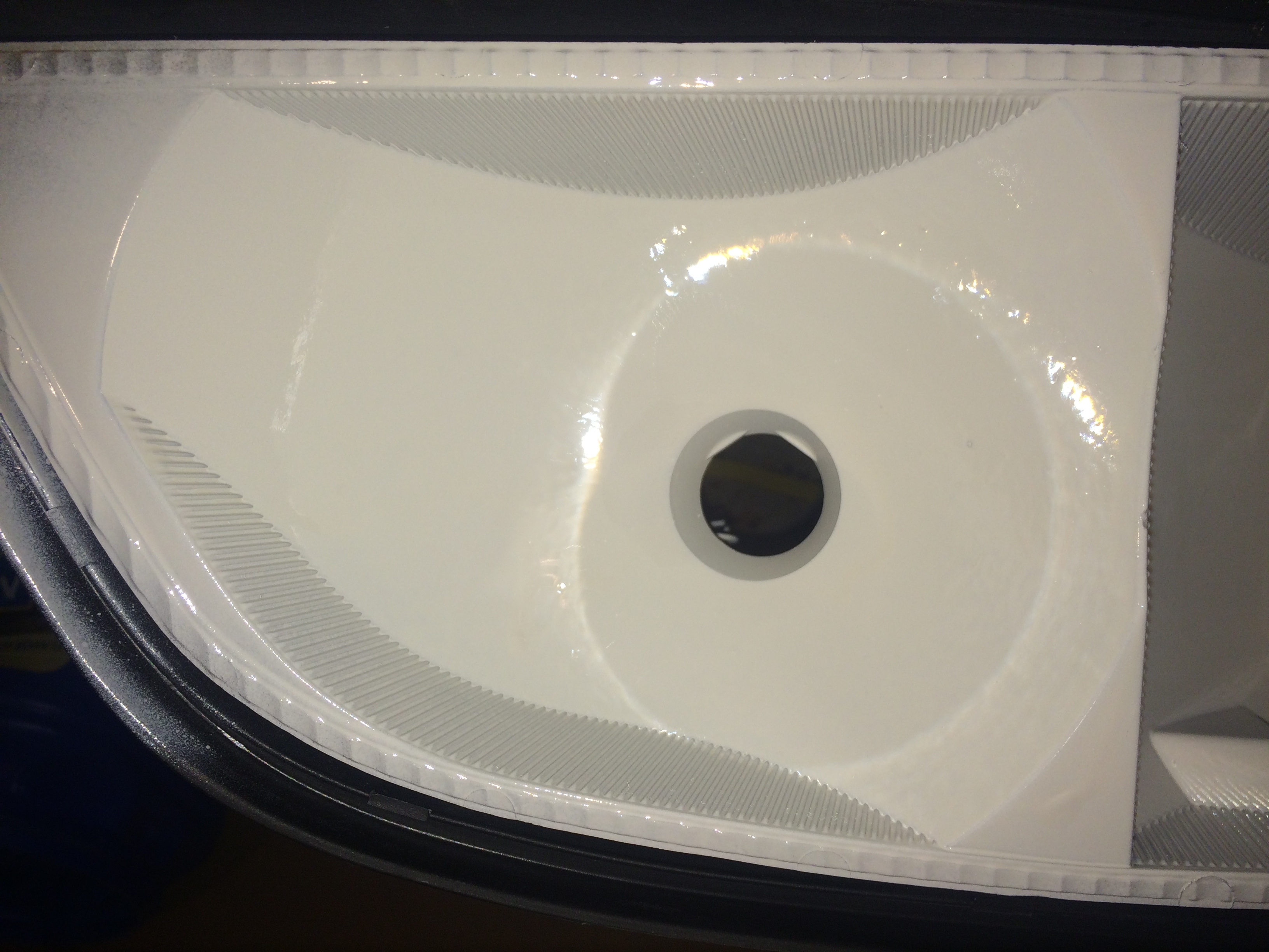

After pic of lights (not quite the same exposure - this is the next day, since I finished at night - I thought it would be a closer comparison during the day)
As you can see in the first post, the white is not pure, it really seems more an off/antique white, but could be a nice gloss finish to try a chrome color over.

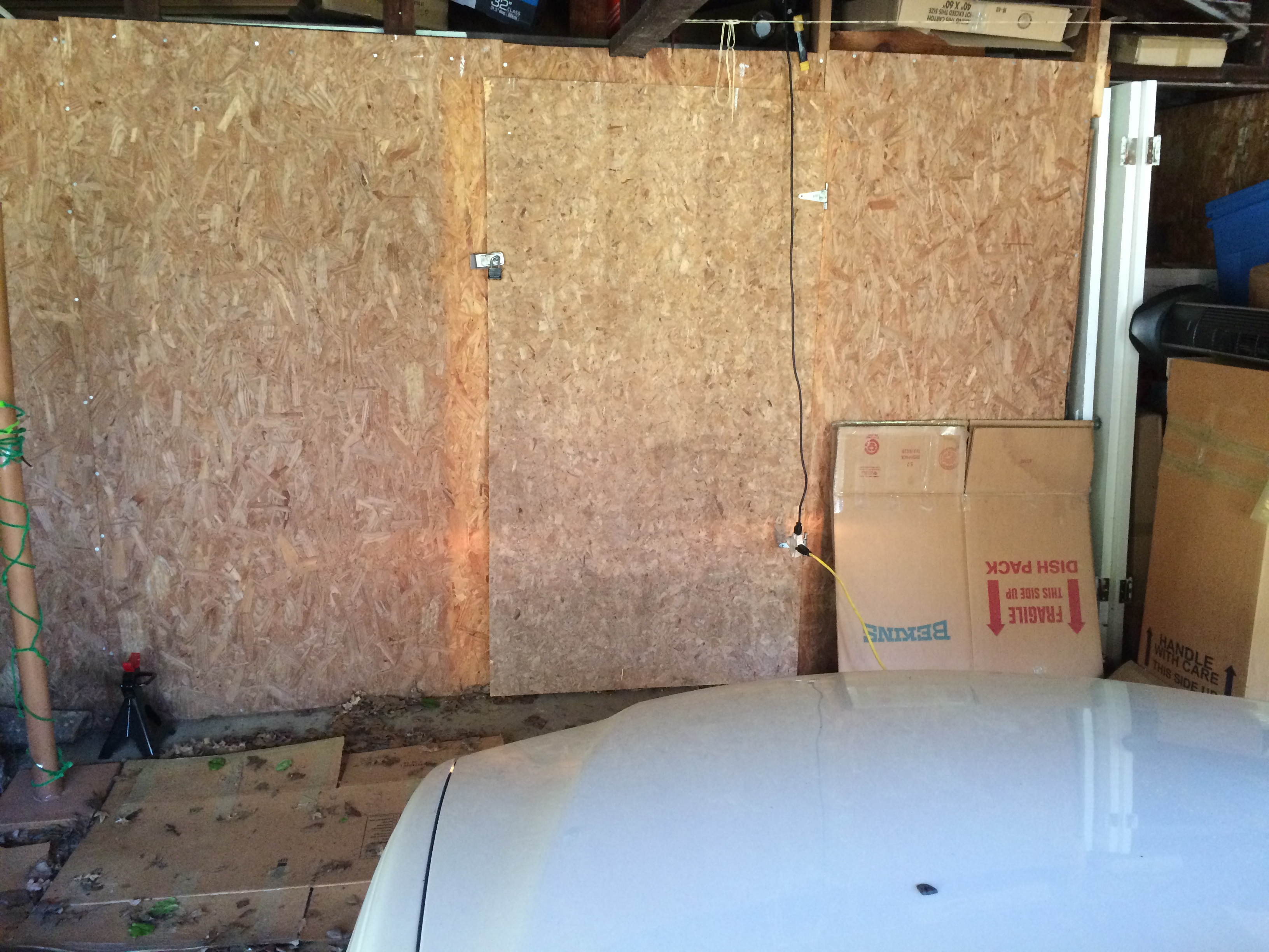

The reflection on the wall (should have taken a pic before - there was no projection, even from 2-3 ft away.
I know this shot is during daylight, but I still don't think it's enough light to drive by. Could just be the ancient Hella H7 bulbs, but the TYC set I ordered comes with bulbs, we'll see how that is. And yes, they come with glass, bulbs, the whole deal - from RockAuto TYC 20541000 Headlamp Assembly, TYC 20540900 Headlamp Assembly.

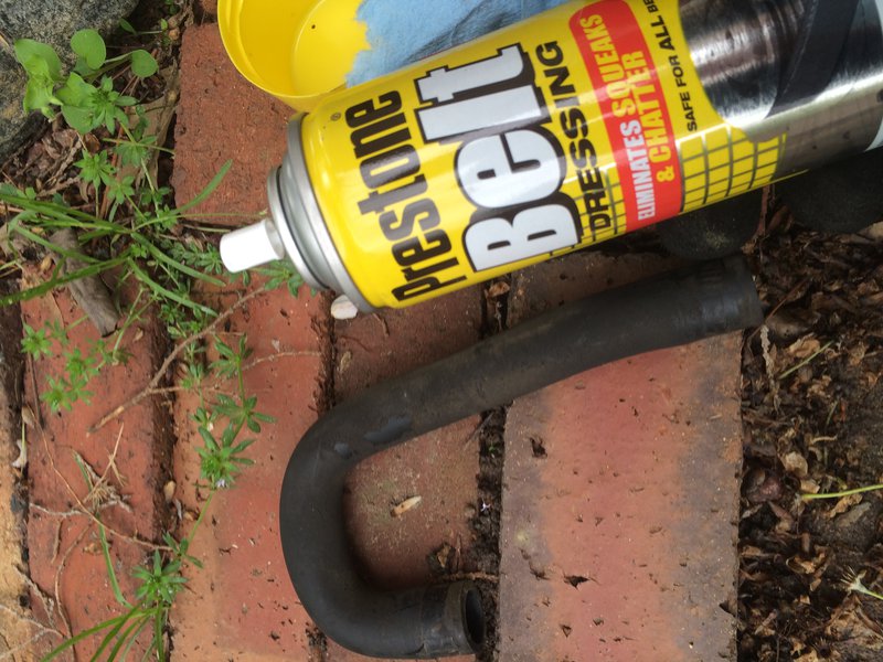

Below are pics of my J-pipe repair

You repaired a rubber hose with tape rather than just bought a new one? I've never seen that in my life and I've seen some hack repairs. Road side repair? You don't need EVAP to drive the car, do it right the first time and keep our air clean.

I can't believe he used red tape. The black tape is 5 cents cheaper. And thats 5 US cents, too.

That is the stupidest thing I've ever seen
J hose is about 12 bucks

Ps.Looks like that red tape is some sort of heat wrap? Keep an eye on it. A decent amount of moisture will kick up in that area, probably won't last long. Best of luck on the repairs. If I were you, I'd hit the repair guides hard https://www.matthewsvolvosite.com/catego ... aintenance

That tape looks like the silicon tape I use for wrapping electrical wiring in my car. It is claimed to work on many materials including water pipes. Having said that, it costs $10 CDN a roll!

Interesting solution to paint the reflectors, very creative.
I wonder how the paint is going to hold up, because the headlights get pretty hot inside. Did you use hi temp paint?
