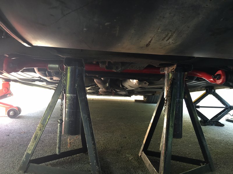

LOL....back to the discussion, I have added Ultra Racing strut tower brace to the front, a mid-chassis brace right at the rear 2 engine cradle (subframe) bolts to the car frame and a very large 27mm rear sway bar (from Racing Beat- it was designed for Mazda 3's) w/ heavy duty end links on my '07 S40 AWD Manual T5...the difference before and after is night and day! The car already has Elevate tuning and Heico dual exhuast and sports suspension and I changed out the stock lower transmission torque mount to an E-Focus mount which is much sturdier. Here is a picture of the rear sway after I got it in today.

Update: I took out the mid-chassis brace. I hit every speed bump and some very hard. It was bent after my escapades with it but a guy in Ky wanted it so off it went. Maybe his car isn't as lowered as mine and he'll have better luck. To be honest, I didn't feel a whole lot of difference on the road with it out so I guess it was sort of over-shooting things on this car. On the other hand, I'm happy with my other upgrades!
