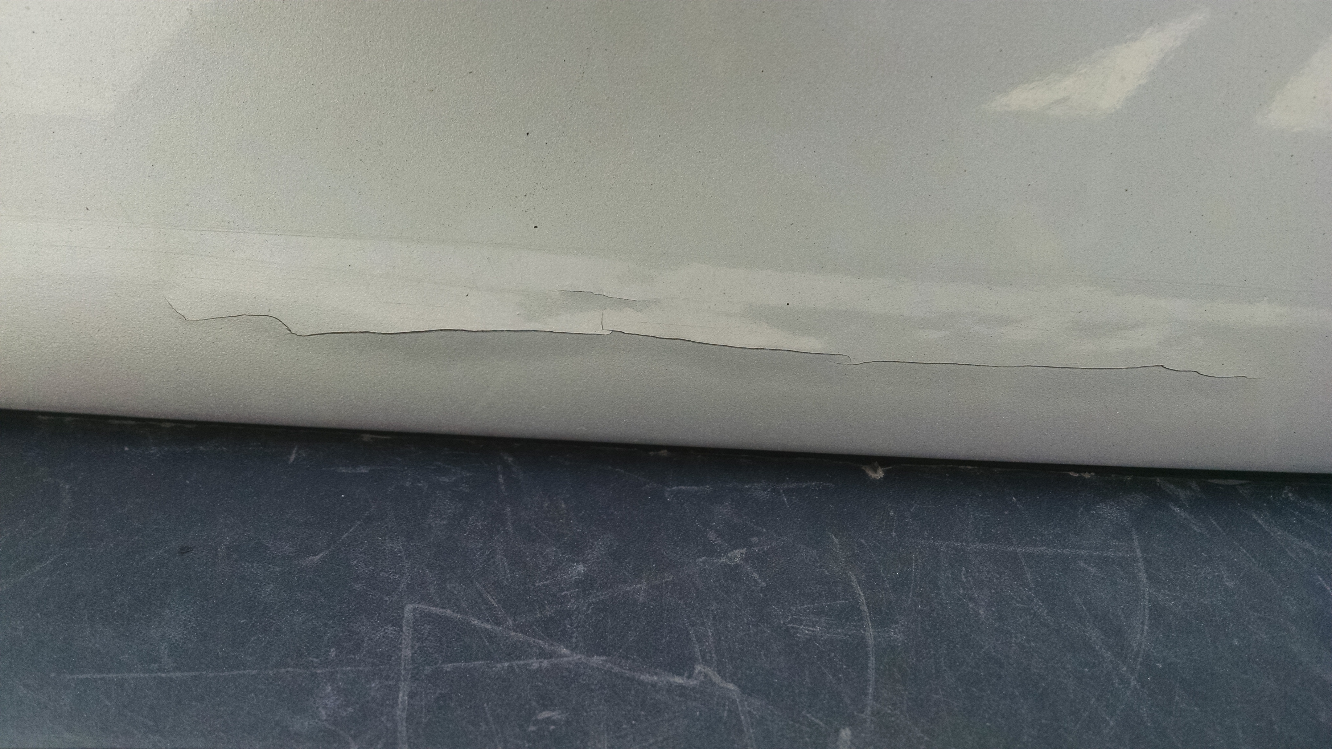

Paint crack on tailgate - rust?
MadeInJapan
- Posts: 13434
- Joined: 31 Mar 2005, 07:14
- Has thanked: 17 times
- Been thanked: 35 times
It looks like it might have been bondo'ed and repainted there? No? I'd be tempted to pull all of that off, re-sand well and prime and paint it with real Volvo paint...they sell a spray paint. Of course, it this is a really "nice" '04 then I might think differently and get it done professionally. Either way, you need to see under it to see if there is bare metal. Being up in Canada with your winters, it will rust, yes, in no time!
