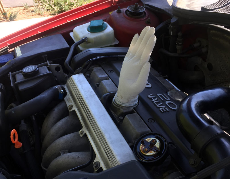

Sorry about the long rambling story ,i do need information on the PCV , it seems to be a problem, but I think if you keep your oil changed, engine tuned and take it out for a drive on the highway once in awhile, PCV shouldn't be a problem to the point of blowing seals and oil. I was wondering how you're spark plugs look and what does you're compression check show.and how much if any motor oil is getting into the throttle body? Must be a common denominator. Find that and repair or you're problem will only return later on.
You can check out the engine with a simple vacuum /low pressure gauge that you may be able to connect at the dipstick tube, pull out the dipstick first small piece of hose or rubber grommet connect gauge and if you are reading pressure you have a plugged up PVC system if you have vacuum there's no PCV problem.
