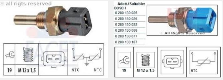

5ft24 wrote:some odd size?
Nothing odd, until Jimmy Fixer comes along...
Capture (2).PNG (215.51 KiB) Viewed 1061 times
5ft24
Posts: 203
Joined: 14 Apr 2013, 12:27
Year and Model: 2005 XC90 V8 AWD
Location: Sedro Woolley, Washington
Has thanked: 20 times
Been thanked: 12 times
Post by 5ft24 »
that is for the sensor for the computer.
The gauge sender, I found out, is a 5/8-16 UNF thread...
