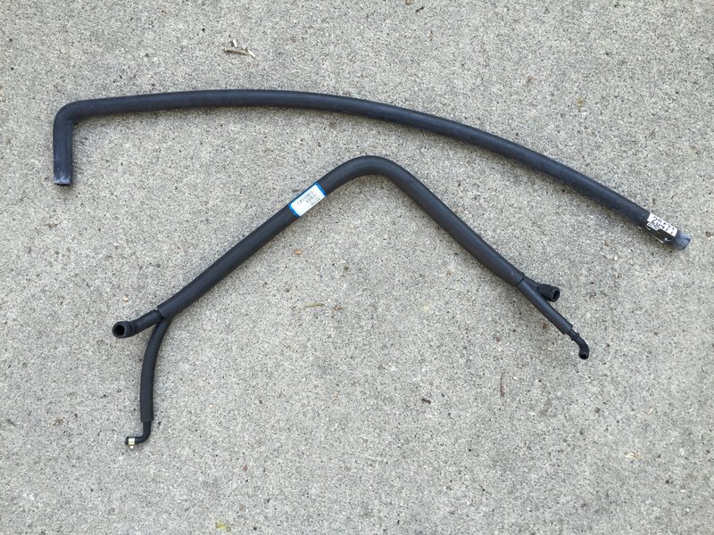

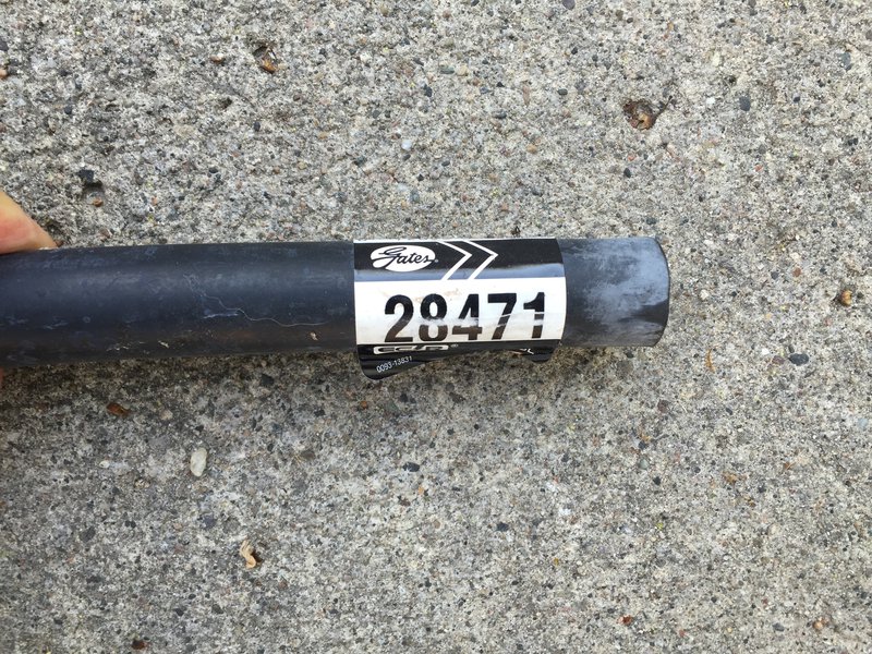

This may come as advice you don't want to hear you but I would be very careful about smaller diameter, generic heater hose, as it may kink. If it is fuel line or has nice thick walls, that is better. For sure be careful about the how you route it.
A good alternative for turbo cars is Gates 28471 or equivalent, $10-15 here in the US, I will post up a pic later. Gates 28469 for NA, that's what I used in the pic up there https://www.matthewsvolvosite.com/forums ... 1&start=40.
- Posts: 11911
- Joined: 25 Jul 2009, 14:03
- Has thanked: 311 times
- Been thanked: 817 times
You will have to cut a few cm off each end for the right fit, but Gates 28471 is a good alternative. Good quality, inexpensive, already has a 90 degree bend. Only downside is, it is not fuel hose which will withstand longer. But most people use standard rubber hoses and they seem to be lasting a while, time will tell.
