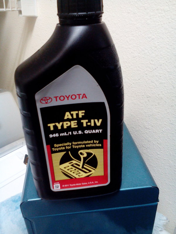

1996-2001 ALL have ABS module issues at one point or another
Also change your tranny fluid ASAP! Non turbo= 5 speed=possibly deadly issues
