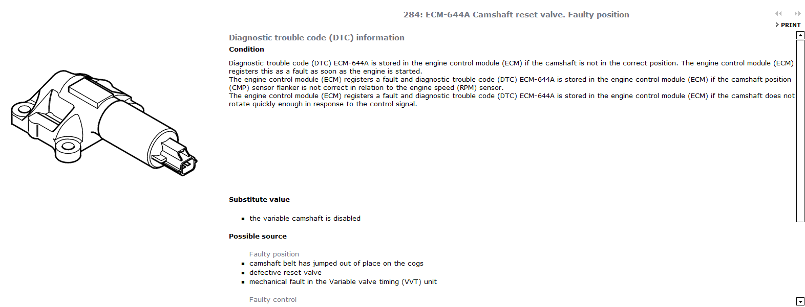

I noted in the Vida Dice info it stated a cam position sensor is a possible source for the fault.
What is the "reset valve" it mentions in the Vida Dice?

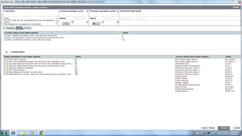

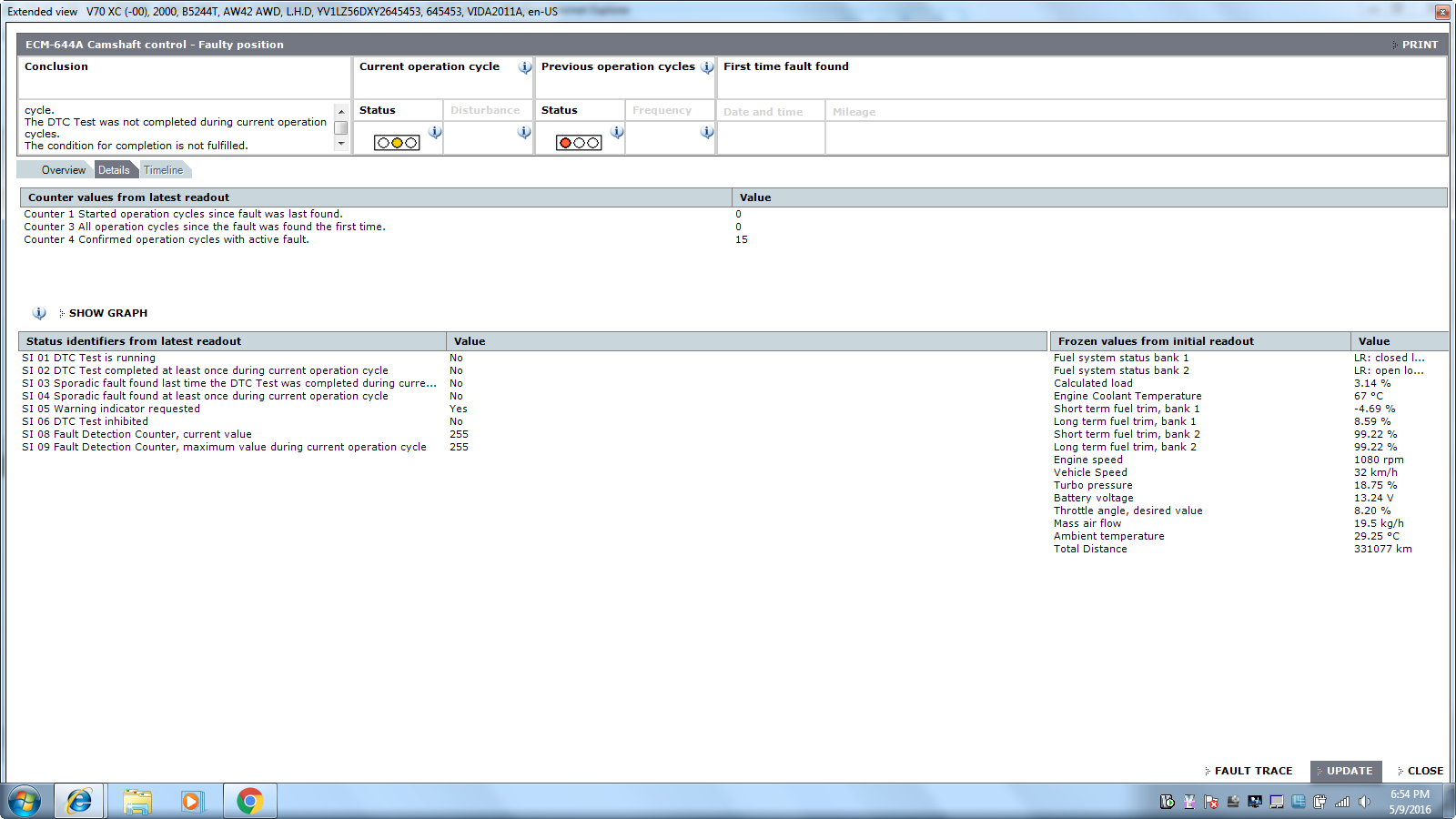

We put live values on the Vida Dice and kept a eye on angles. I read in several places if the spec is more then 7 degrees it can throw a code. At idle values are 14-15 degrees. I noted when reving values are 0 or 255 so either the system goes "offline" or they are null at higher speeds.
See attached images to see if any of this info helps.
What should we try next?

The reset valve is the control solenoid - different names for the exact same device.
Do you know if the preload procedure was followed when the timing belt was replaced? It is a bit confusing the way it is worded in VIDA but it is imperative that it be followed or the CVVT will limit out, throw an error code, and the CVVT will be disabled. The key to understanding the procedure is to recognize that the sprocket on the CVVT camshaft operates independently from the hub itself over a range if 15 degrees or so.
The 644A code however is usually a faulty signal code and it implies that there is a connector or wiring problem to the solenoid. In most cases the harness has to be spliced when replacing the valve since the current replacement part has no connector, just a pigtail. The valve is actuated by varying the pulse width of the square waves to the valve and if you have access to an oscilloscope you can actually see the pulses.
Solution here would be either moving the sprocket one notch counter clockwise on the belt or 1/2 of the oval space on the three M4 bolts on the sprocket to get the flanks around +5 degrees.
