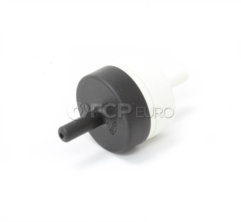

Hey jblackburn, this thing?jblackburn wrote:Flip the key on (to II) and make sure you have fuel pressure at the end of the fuel rail before replacing the temp sensor. A bad check valve can do things like that as well.
That start doesn't seem too bad - mine took 45 seconds to a minute to get going when the sensor went bad - on a 70* day!
We only need this if we have taken the air pump out, right? I miss the instantaneous start we used to have before the fuel pump/relay hiccup. Maybe we should be putting the fuel pump in the "always use OEM" section, too, huh? I will keep an eye on it but won't worry about it too much. I really appreciate your feedback!

Yes, splicing a check valve into a fuel line could work.
But in the meantime, just flip the key to II, don't crank, and look near the throttle body end of the fuel rail - there's a little blue cap and a port you can depress with a rag in hand to see if there is strong fuel pressure there or just a dribble.
