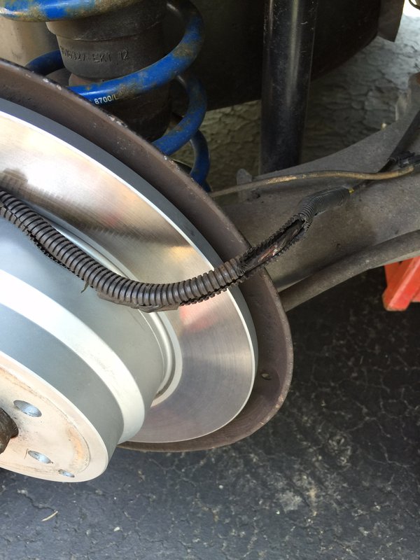

On the way back from Boston , hit a bump and ABS, STC, and brake light came on.
Brakes work fine.
When I repaired my broken ABS sensor wire last time I did not zip tie it to the trailing arm , it got loose and chafed through on the tire.
On lunch break yesterday, I popped the wheel, soldered in wire, heat shrink, wire loom, and zip tied it in place.
1999v70 T5 rear ABS sensor wire fault
