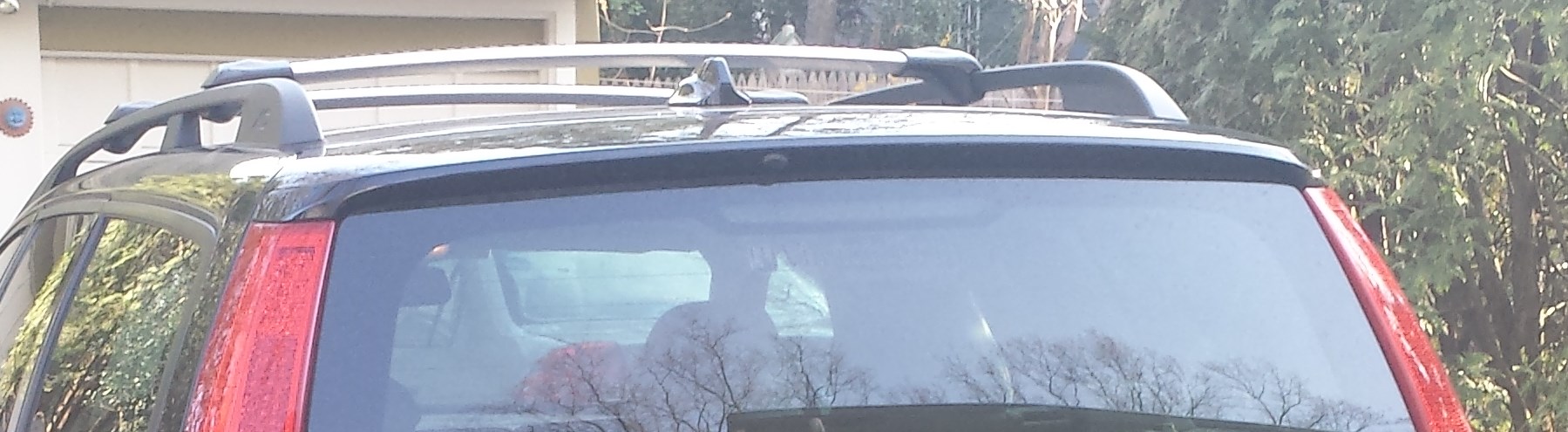

I ask because I have a 2004 with side rails, and I have come across some load rails that fit a 2008 v70XC.
Here is a photo of what is for sale, 100 miles away:

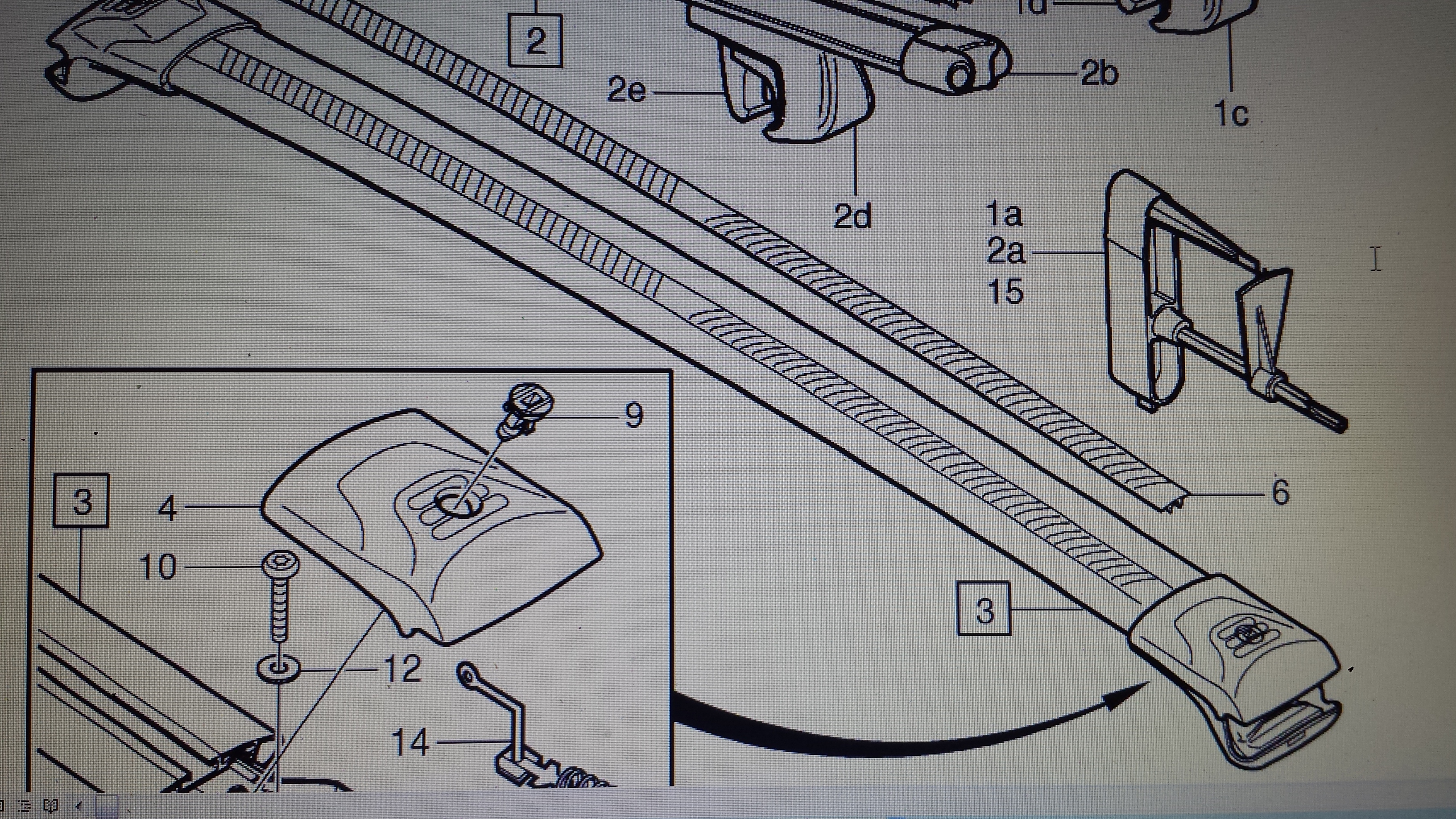

Here is a diagram from the assembly instructions that the seller got with the bars:

They do look similar to the ones for the 2006 XC70 we have. Check the length of the bars as they may be different You could measure the distance between the 2 end covers )part # 4 in the blow up drawing above). Also check the profile of the rails to ensure they are the same to allow the bars to clamp correctly.
