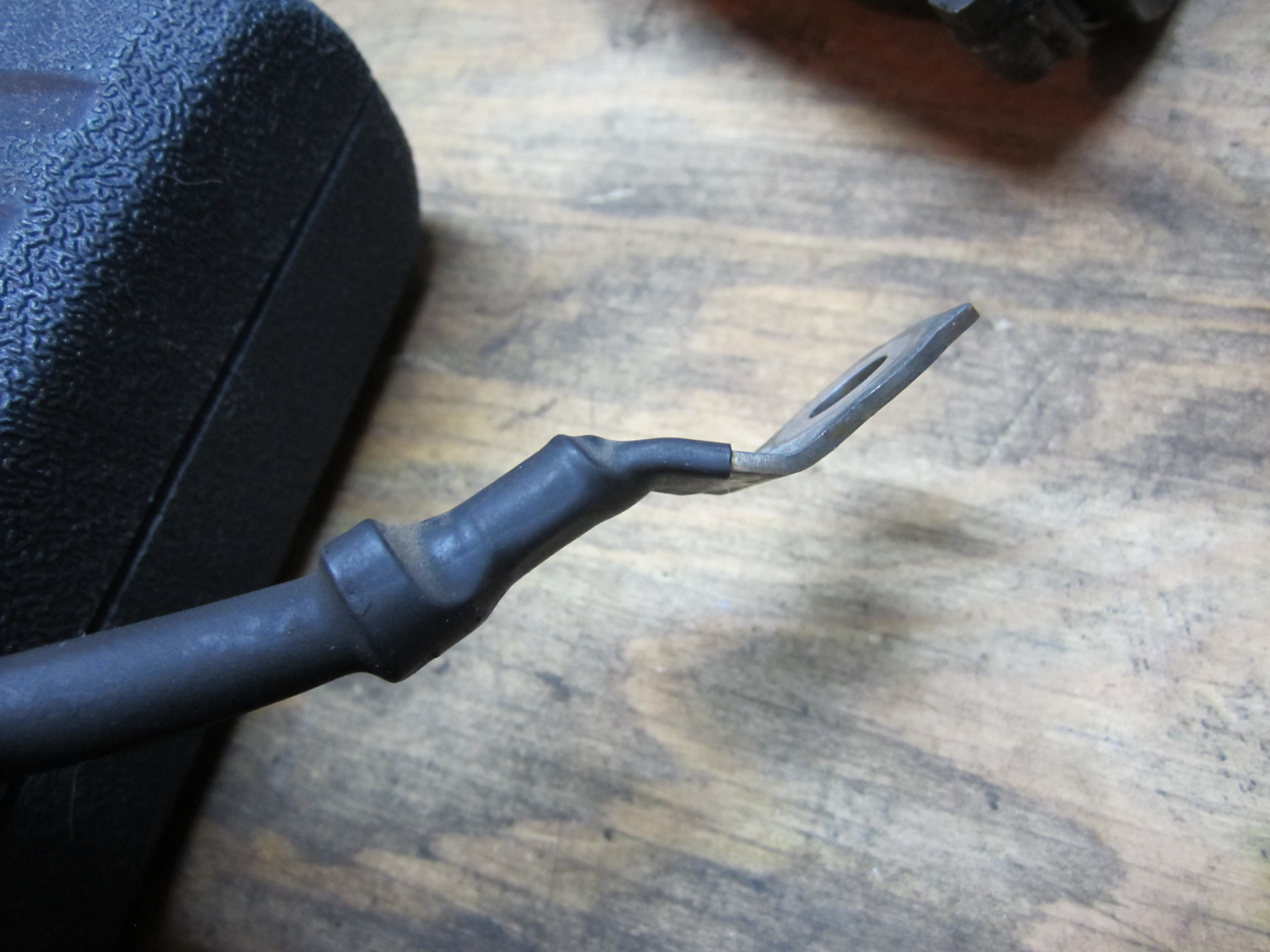

One thing to check that you asked is which red battery or alternator cable to fit first. I seem to recall the cables ends dictate which fits first and second as they have to overlap in a recess in the starter where the nut fits over them. I recall this as I was pissed with Volvo when they did not give the 'kink' to one of the cables that I paid a ridiculous amount for and I had to make the bend prior to installation.
Based on the picture above from my complaint to Volvo, it would appear the alternator to battery wire fitted first and then the starter to alternator on top of it. Check the cables you car has for this feature at the cable ends at the starter.
