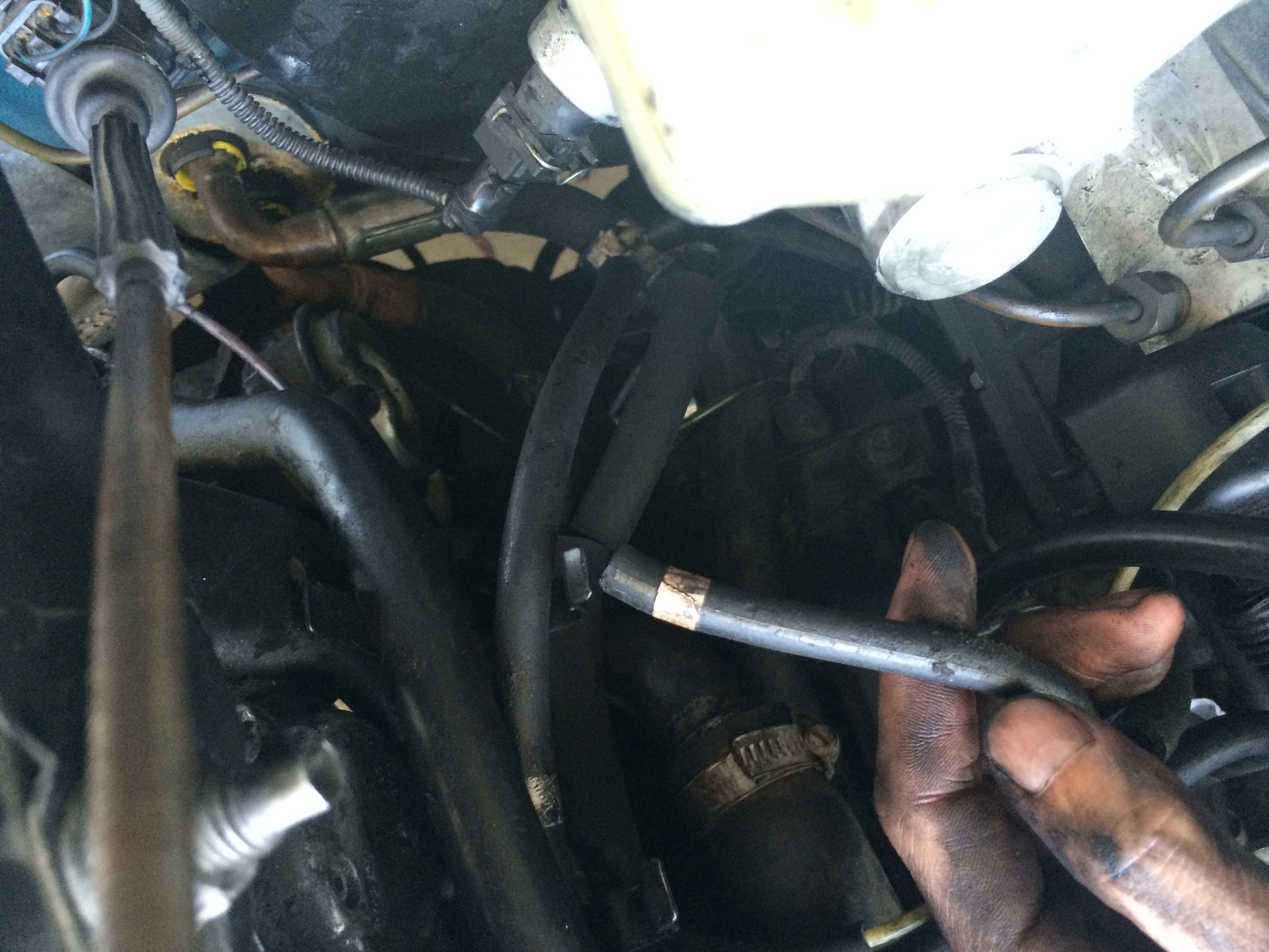

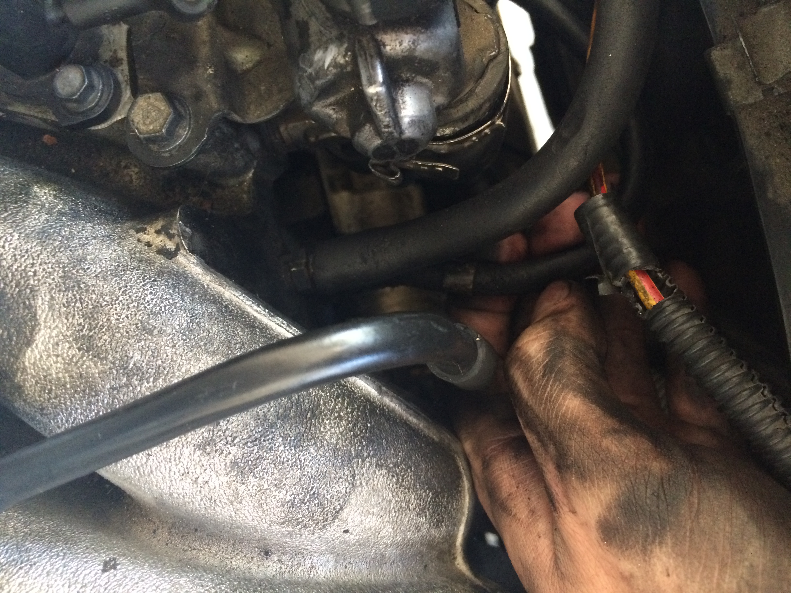

Replacing the pcv had everything put together but can't find where this hose goes. I pulled the ptc tube to check for another nipple but nothing. I know it's right there I just can't find it. Any help would be greatly appreciated :D
It's the hose in the photos I provided

Where does the other end go? I have a 98 V70 in the driveway.

Could be but may not be- there's a nipple on the underside of the accordion hose going from the air filter to the turbo...it's really more up near the top, closer to the MAF sensor- look there. Because it's on the underside, it's often overlooked.

TCV is my guess.

If it comes from under the manifold, then it's the hose to the side port on the PTC. If it does not... then it could be anything. Where the other end is, is the key.
