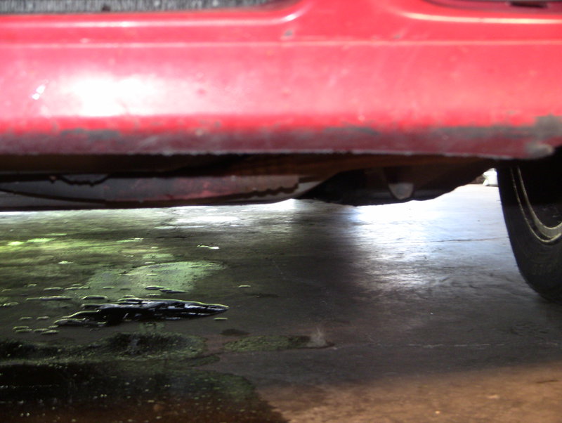

The last piece of the puzzle is for those guru's here who are able to touch a car and diagnose what's wrong with it. I'll go one better and provide a picture of where oil is dropping to the ground. I'm hoping someone will be able to help diagnose this based on the location of the oil dropping to the ground and the excessive oil being deposited on the exhaust system. My suspicions are the turbo seals but the cam seals and rear main seals are all in the same general area. This is where you experts make a picture worth a thousand words...
I've tried to look down into the engine to see where the oil is coming from but there is too much stuff in the way. The oil leaks while the engine is running but I'm hesitant to get under there while the engine is running. For the most part it seems to be dropping in the vacinity under the turbo/rear main seal.

You really need to get that up on ramps and do a "de-greasing" or "de-oiling" in your case and see where it's coming from...it's not a job I want to do laying on the ground under the car.

Less than a quart per 50 miles? Wow, that is alot. My wifes 850 needs a quart per 500 miles and that is actually bad. Like Made in Japan said: try cleaning up that motor as good as you can. Then you should see it squirting out very soon again.

Could be but it could also be rear cam seal (likely culprit) as well as pretty much anywhere- possibly the turbo return line- it's seal goes bad on either end and oil comes out of it like sieve. Good news is, it's not hard to replace and it's an instant fix and you'll be relieved it's not a rear main seal.... but again, until it's cleaned up and up where you can see it from below, you're pretty much guessing...from above, you can however see if it's any of the rear cam seals..my bet would be on the exhaust cam if that's where the leak is- it's the one under the throttle position sensor (TPS).

If it's the rear main seal would this result in significant oil deposits on the exhaust system...of course I could have multiple damaged seals...
was hoping the location of the dripping oil might narrow the possibilities or eliminate some...
the rear main seal is the expensive one...
MadeInJapan
- Posts: 13434
- Joined: 31 Mar 2005, 07:14
- Has thanked: 17 times
- Been thanked: 35 times
Yes, but after de-greasing, and running the engine it will be obvious if that's it or not...there's a little weap hole whee the engine and transmissions are joined up and you'll see oil trickling out of it.1997volvo850 wrote:the rear main seal is the expensive one...

Thanks for helping. I stopped by to see Dave B. in Ithaca and he replaced my rear exhaust cam seal. This appears to have done the trick.
