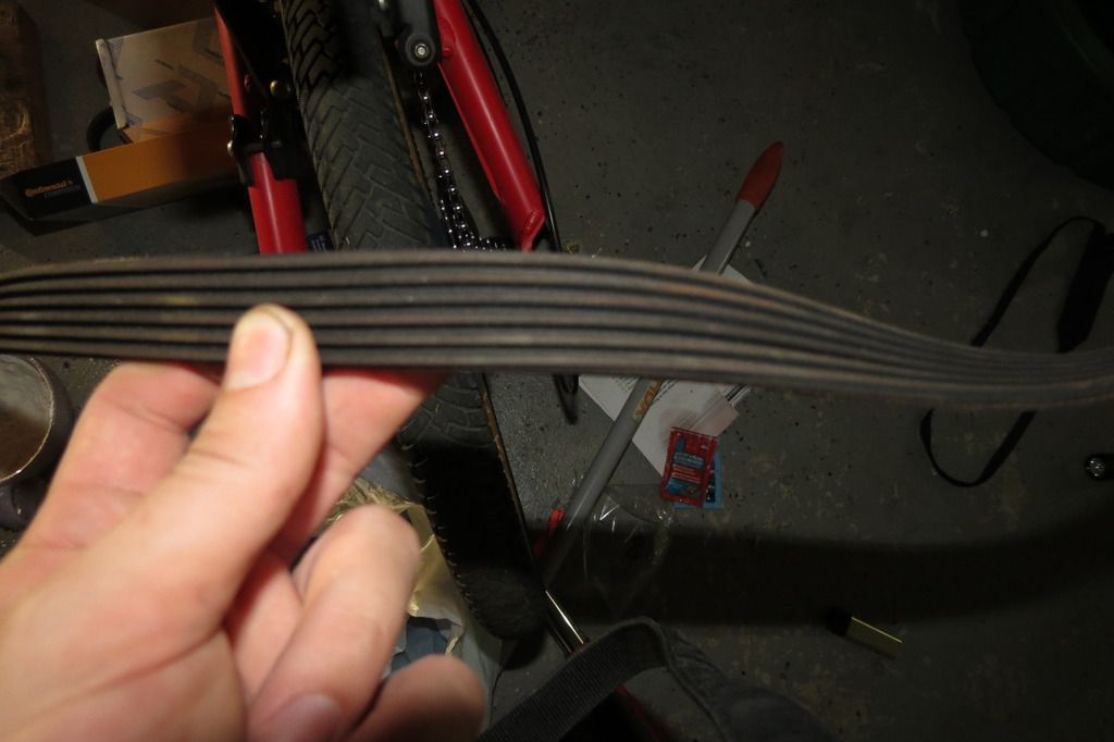

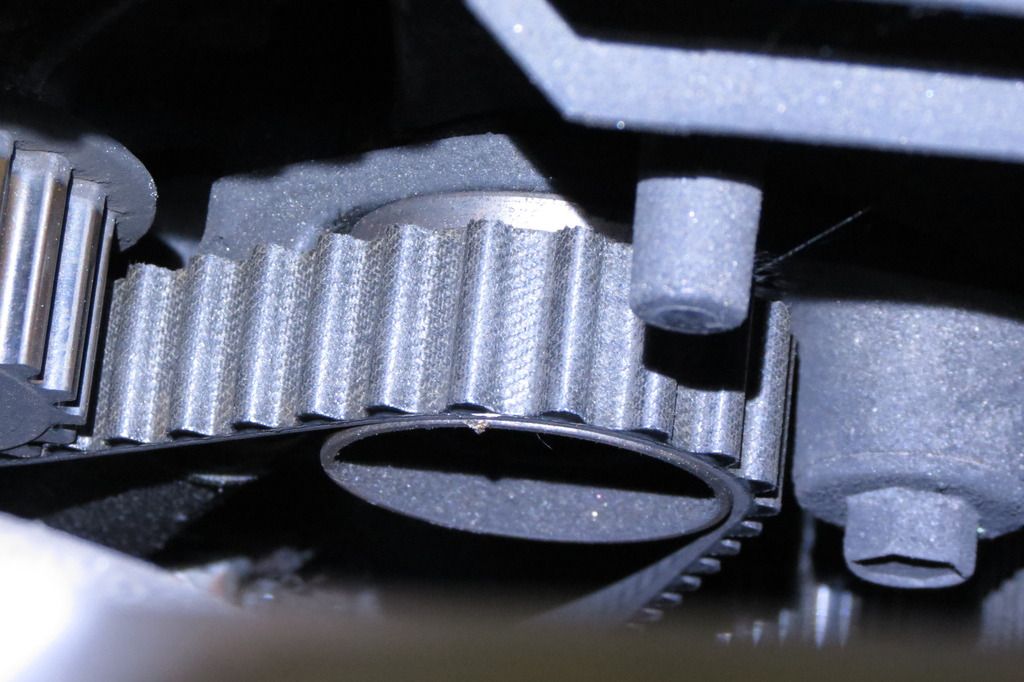

Hey there, so on my 93 850 that had the belt changed in 03 at 49k and its now at 71k, I have been replaceing the entire steering system for the last couple days because a line on the rack rusted through and you cannot get just the line and I couldn't find a place to make one up. So I was planning on doing the timing belt and tensioner because I expected it to be all cracked and dry rotted but when I took off the accessory belt it looked brand new! So I just opened up the timing cover (forgot it slides up and broke a tab :( ) and the belt looks just as new as the accessory one! see the picture.
Heres the accessory belt
What do you guys think?
Should I still change them? (the tensioner and belt) I'm not gonna do the accessory belt because it looks still good. I'd like to finish the car up today so quicker responses would be amazing!

The timing belt deteriorates with both time and mileage.
Mileage is certainly on your side, but at 13 years old, the belt is WAY over on the time interval.
If it were my car - I would not risk it. For an older car, timing belt failure is the difference between continuing to drive the car with confidence and having it hauled to the scrap yard.

I hate it when cars become useless. And like 101 said, on a car of that Age a broken TB usually means game over. I just had a similar decision to make, and I decided now that the AC works again I´d hate myself for saving time and money in the wrong spot.
You might get away with this one for a while, but if it fails you´ll be screwed.
Btw: old tires sometimes look really good, but have no grip even though they are not cracked because they still harden.

If you need to inspect any timing belt, you have to go inch by inch on the flat face. That is, turn the crank by hand - spark plugs out makes it easier - mark the belt and run it until you see the mark again. If it's not an original Volvo brand, replace it now matter what.
The material of the belt gets stiffer as it ages and yours is 13 yrs old. It got quite stiff at this point. If a crack develops, it will expand faster than on a more recent belt. Belt integrity also depends on how the car is driven, won't be the same for a lady in her 60's and for a 30yrs old male. Mine had 100K miles and 10 yrs old when I replaced it, and the car was driven gently by it's owner. It looked pristine except for a single crack, and the material was quite hard compared with the new belt I installed.
If you think keeping the car no more than two more years, keep an eye on it every few months (assuming there is not a single crack on it). If there's a chance it will stay on the road for another 5 years, I'd replace it now and have the peace of mind.
