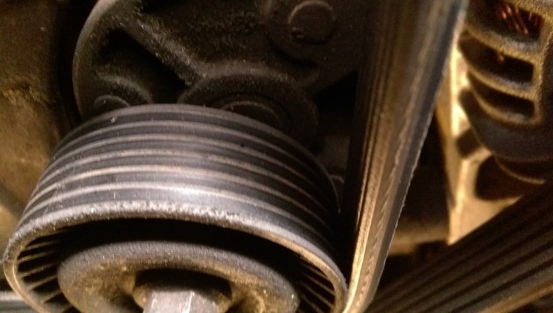

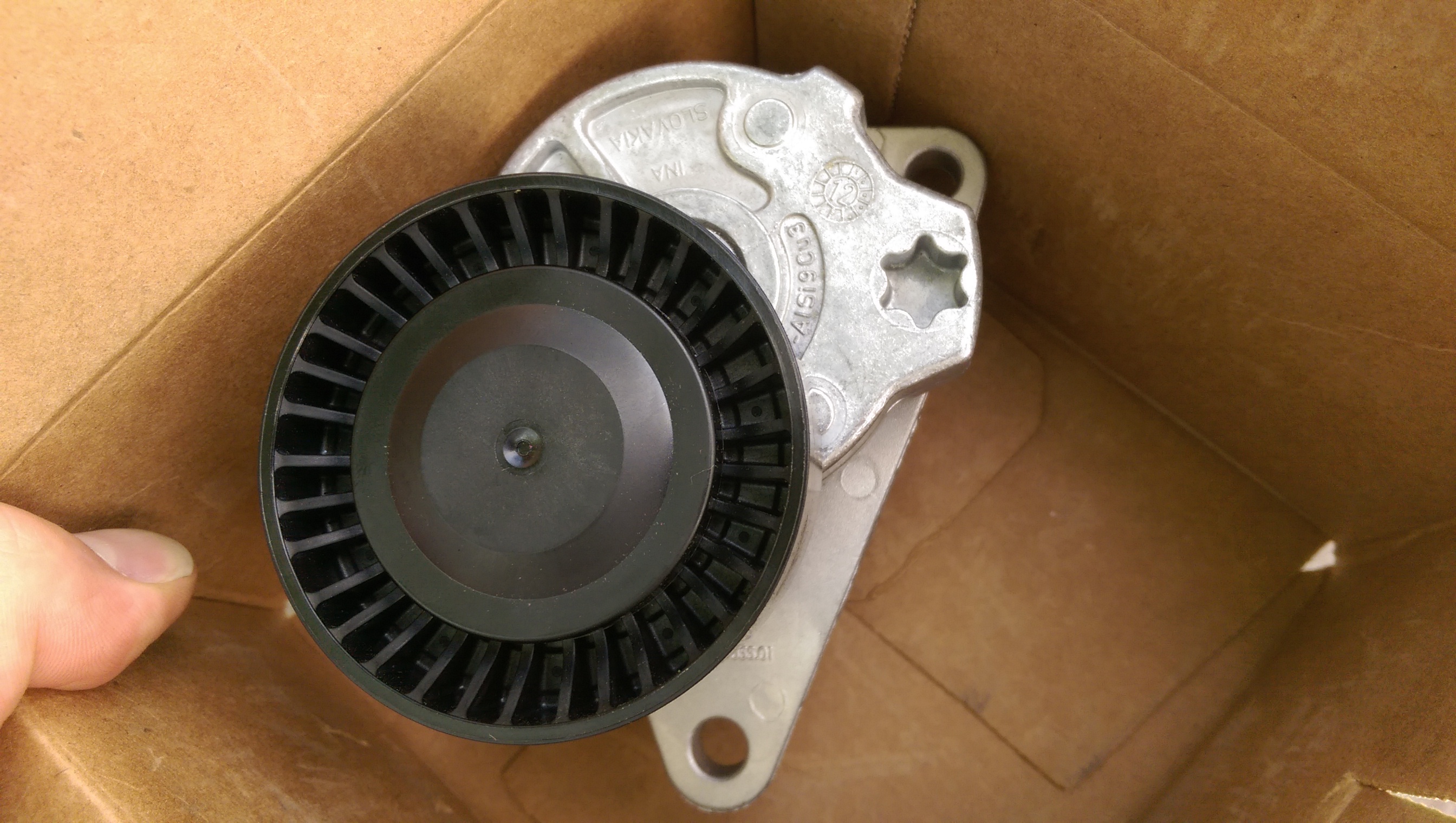

Trying to replace my idle tensioner, and I think I've got the wrong one. I've seen both replaced online, will this work for my 2002 v70xc? Mine has the bolt head on the pulley, but the one I was sent has the t-60 torx fitting for detensioning.
Is anyone familiar with the difference between the two?

Yeah, I'm sure you're right. I believe I may have been sent the tensioner for the high pressure turbo. It's from contitech kit number c8 adk0039p, which came with a belt as well, the tensioner is part number 534010310. It's Slovakian made.

What would concern me is even if the tensioner fits and works, would the belt they sent you fit? Check part numbers thoroughly to make sure these will work on your car. Where did you buy the kit from? I looked up the part number for the Contitech and it appears to be sold on eBay. I did not see your car in the description of what it will fit...even going through the year and models...'03 and '04 fit but XC70 for '02 is excluded. In regards to the tensioner- it appears to be by INA which is fine, but your model/year is also excluded in the list of P2 Volvo's in this list: https://www.fcpeuro.com/products/volvo- ... er-99-plus At this point, I'm confused though because when I put your car in for FCPeuro- the belt kit for '03 and newer comes up. If I put it in for '01- the same thing happens. I cannot find the kit for your car- crazy!! Btw- INA changed some tensioners (same part numbers) from bolt to star shape so that in and of itself should not be a deterrent. I would probably call FCPEuro and ask them. If they have wrong info on their website they'll change/update it and they won't steer you wrong.

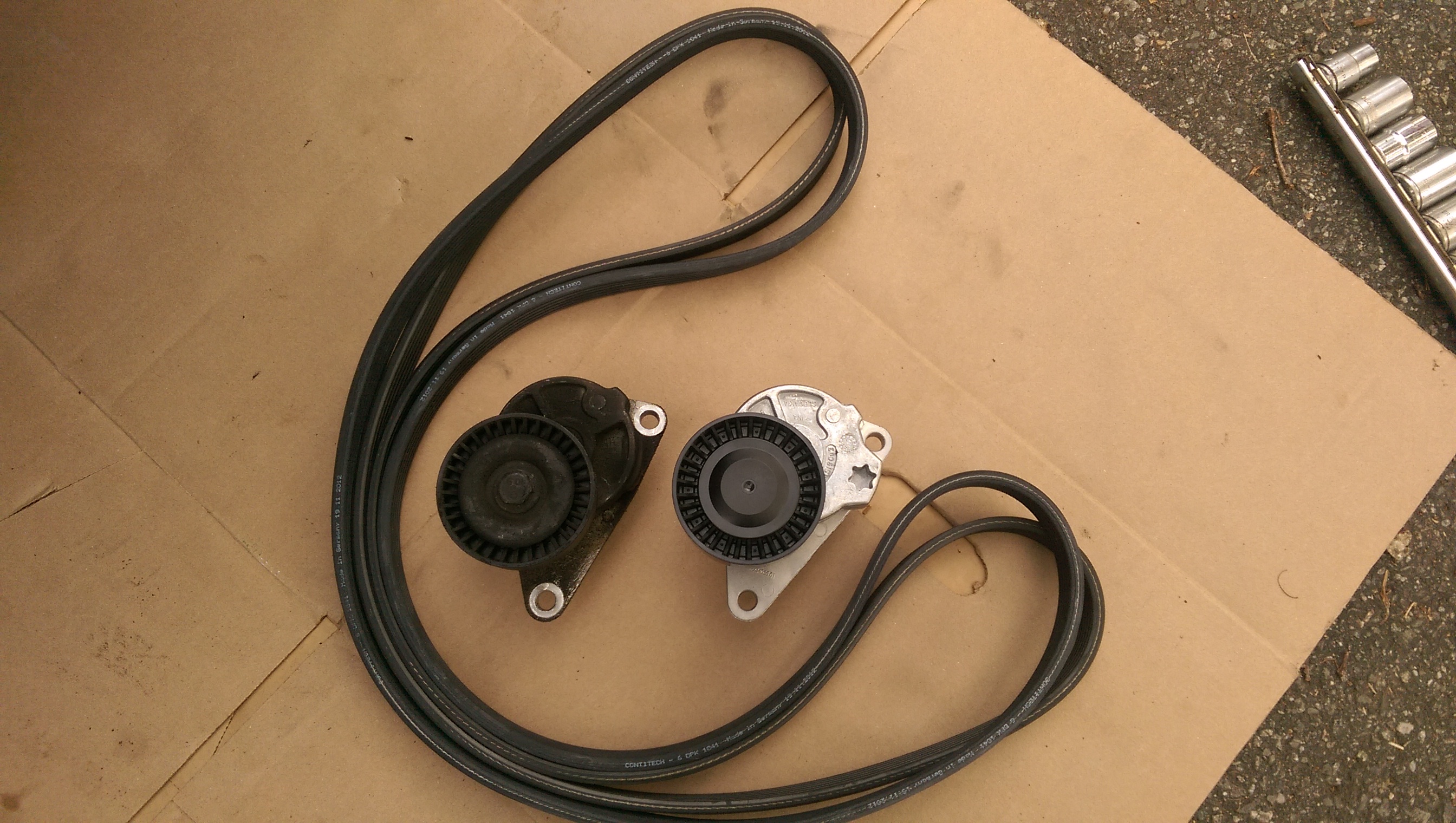

Thank you for your replies! Here they are next to each other. Going to try it on for fit. I bought it from rockauto, but other sites all came up with the same contitech kit for my year.
The belts seem to be the same length to me, within a cm or two at least. Not sure if an old belt stretching a cm is common?

The new belt was definitely too short. Luckily my old belt was only from last August, when I blew my a main seal and oil spewed all over everything.
