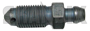

Order yours before removing the old ones and replace asap as the old one is out 8)
For reference, because the web seems a bit confused in numbers, this what the original Volvo part looks like
http://www.skandix.de/en/spare-parts/br ... r/1024017/

Your old one looks good. Mine on 02 V70 rusted to dust, had to blow torch the stump and extract it.

Well, I thought Montreal had more salt that Boston 8)
It doesn't look too awful indeed, however it's the lone survivor. The one on the other wheel, I succeeded to open it, put it back in place gently tight, one year later it snapped. New caliper on :(
