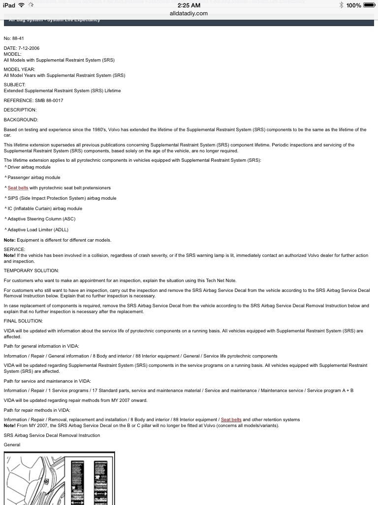

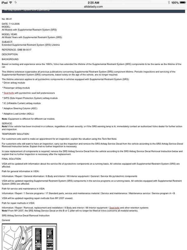

3: I traded in my 1994 850 wagon, on which the driver's side seat belt failed. When I was poking around trying to fix it, I saw that the SRS needs to be either replaced or serviced by a certain date. Out of curiosity, I checked my new Volvo for that information, and it looks like the system needed to be checked or replaced in 2009. What does that mean, exactly, and is it something that positively needs to be done?

The good news is Volvo issued a TSB which relaxed the SRS Replacement interval to ...never.
So, having scored two dodges of repair bills, break out the bank and get that TB, idler, tensioner done please.

My SRS system expired in '08 according to that sticker, I don't plan on doing anything about it. Didn't know Volvo issued a TSB on that, though... now I really don't need to do anything about it!

official TSB in 2006-07 retiring the 10 year limit on SRS, along with the " Final Solution" to remove sticker.
note to hire more technical writing people with history education.

Very good... again, not that I was planning on having them serviced anyway, but good to know Volvo doesn't think I should either.

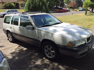

Thanks everyone, I appreciate the wisdom of the board members here. I'll order the kit and have my mechanic do the work. Meanwhile, here are some pictures. I'm in love!

Wow, that is a clean car!
