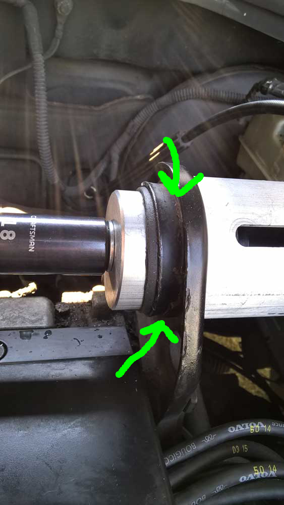

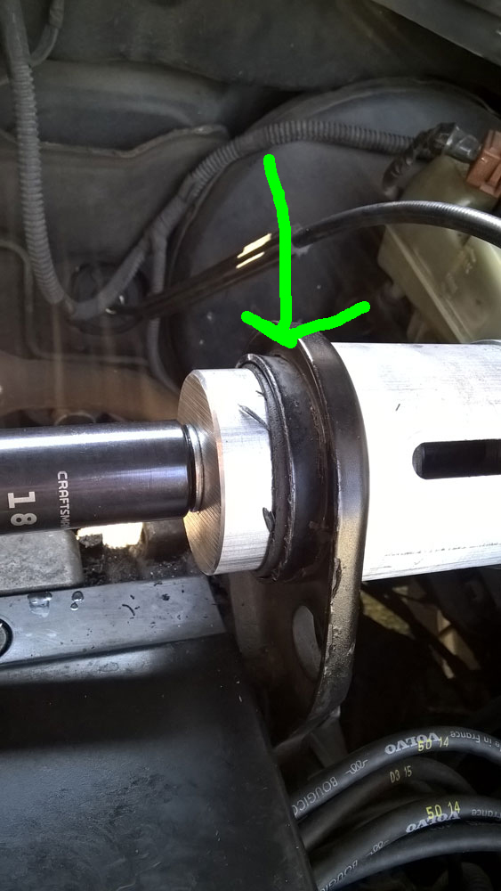

It was insanely hot in the driveway when I was doing this yesterday. Maybe that was the culprit. I don't know. I might've just left the bushing in place had the metal not cracked. (And if I could get the press piece off...) I should've shaved it down a little bit. Lesson learned! Here's where the bracket arm cracked.
