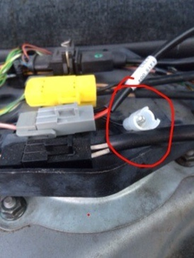

Recently I have replaced both my fuel relay and fuel pump on my 5-speed 850 glt (non turbo). At first the relay died. I tested the fuel pump by using a jump wire. 2 weeks later the fuel pump went. I ordered a new bosch pump assembly and installed it. I ordered bosch part #69745. The only difference I noticed from the original pump was an extra wire coming from the connector (pic attached). I installed it and it has worked fine for the past week.
Yesterday and today my car would not start unless the gas pedal is pressed while cranking. Any ideas, and does anyone know what that extra connection is for?

The extra wire is an extra ground, not really needed.
