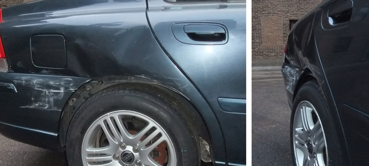

Involved in a rear/side collision in Febuary (T-bone on right rear wheel/quarter, by a large SUV moving between 15-25MPH). The driver of the SUV was at fault. Pic of damage below.
Now here's where you can get into trouble: Though I had not taken to wheel/rotor off to inspect (yet), I had noticed damage to the backing plate while I was under the car to secure a rattling heat shield over the muffler. The backing plate was bent sort of 'from the inside out'. This would have happened when the brake mechanism failed, likely broke off the boss (circled in picture) while the car was moving the the entire brake mechanism would have spun around with the cable still attached, bending the backing plate in the manner I observed. A previous owner removed the parking brake hardware instead of fixing it.
I get it. An alignment problem on that right rear wheel is a result of the collison (I had the car in for alignment check not weeks before the accident, and have the printout from the machine showing that wheel was within factory spec before the accident). Insurance adjusters will see this and (even though they may well know it is not accident related) try to use this to indicate damage from a previous collison and thus deny the claim/repair.

They gave me an alignment report which indicates the camber on RR still being 'barely' out of spec, however it indicates a camber position change on the LR side that wasn't touched, so I'm thinking it's laser drift/error on their machine as the cross camber is effectively the same as the report via the shop I use pre-collision. One of the reasons I track off to Chicago to a shop on the north shore is with the a picky crowd up there they have figured out that the machine itself needs to be calibrated once in awhile by someone that really knows what they are doing. There is a shop in town (5 miles away) that when their machine was brand new 10 years ago their alignments performed were good. But not so much lately the report they give you doesn't click with observed handling/behavior.
As I have a bit of work to do yet on the front end (removing those "HD" spring seats that don't mate properly with the OE upper mount bearing) I'll eventually have it rechecked at the shop I normally use and likely confirm all is well. (Handling back there feels right, which is inconsistent with the report they gave me which I would expect some noticeable weirdness back there).
They replaced everything (old parts were in the trunk, both C-arms, toe arm, hub, end link), which wasn't necessary - it was the upper C-arm that was bent at the hub attachment point. Used parts (I'm ok with that since it is a 10 year old car). Since the replacement hub has a bearing with unknown mileage I saving the old bearing to keep as a spare and the toe arm (it's not bent or damaged).
