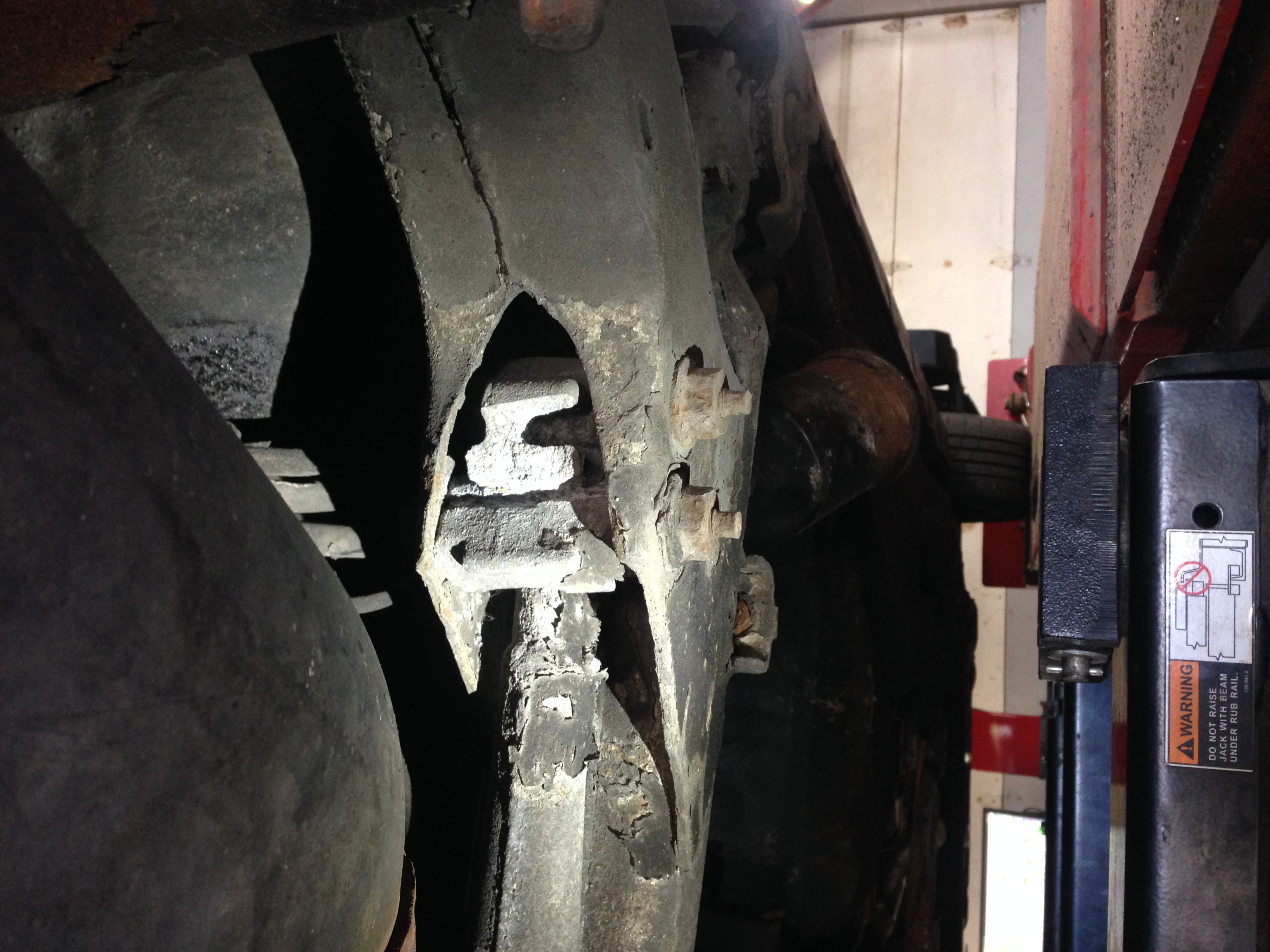

I went for a wheel alignment yesterday and the technician showed me he was not able to adjust the toe in the rear (1/4" toe out currently) because this part is broke. What is it called?

It looks like it would be, because mine are broke off somehow I do not have a good representation of what it would originally be. Does look like it would be what it is though.

No clue. Here's a good read on how to replace it... Seems like quite a bit of work!

The bushings are a bit easier than the end links but corrosion on the bolts can make things really difficult.

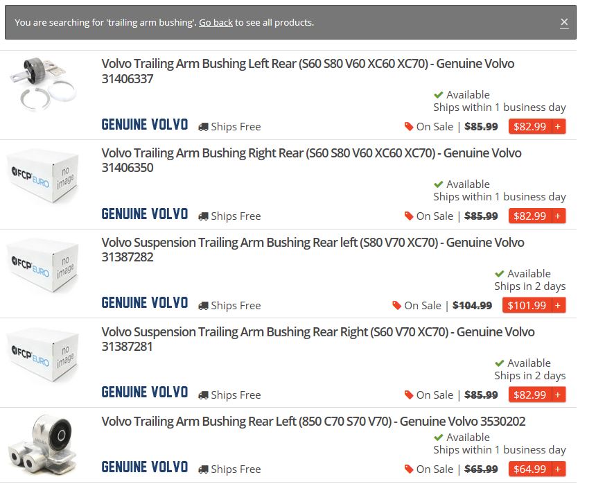

theWIFES_S70 wrote:That's a rear trailing arm bushing, no? https://www.fcpeuro.com/products/volvo- ... 13-9181014

Thanks for the comparison pictures, I looked on FCP when that link was posted and searched though pages and pages and wasn't finding both of them for some reason. I just checked again and found something interesting, I sorted it by brand and I choose genuine Volvo and they only offer one side?

XC70 means AWD, so not for your car.
These part number will give you want you need for your FWD car.
9181013
9181027
The volvo dealer seems to have a better pricing.
http://www.tascaparts.com/oe-volvo/9181027
http://www.tascaparts.com/oe-volvo/9181013
I also recommend 3516122, you'll need two of this and a special puller to replace that bushing.
