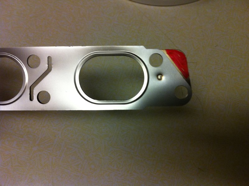

Can you tell me more about that exhaust manifold, is it the part for a newer engine or something? I have a manifold swap coming up, will need gasket(s).

erikv11 wrote:Can you tell me more about that exhaust manifold, is it the part for a newer engine or something? I have a manifold swap coming up, will need gasket(s).
I used VICTOR REINZ MS19361, but volvo 30777495, 8699467, 86994670 also works. They are for later 2.4/2.5 and are multi-layered steel gasket, they work sooooooo much better than the stupid individual gaskets. For one thing, the gasket will stay in place when you bolt the exhaust manifold on, that can NOT be said about those stupid individual gaskets.
There red part of the gasket have to be cut off, because it interferes with the water pipe. I used a angle grinder to cut if off. :lol: Everything else works and fits perfect.
