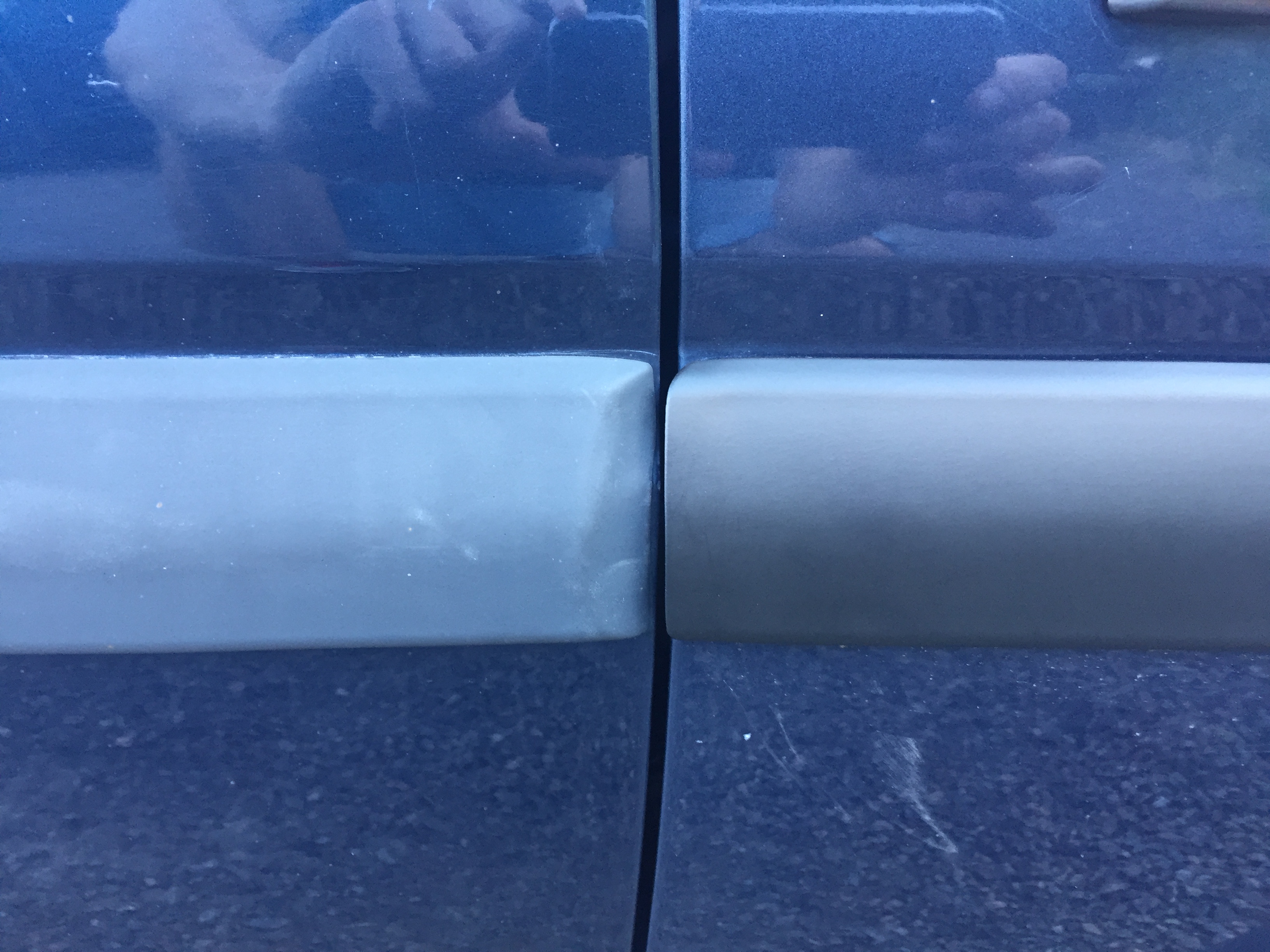

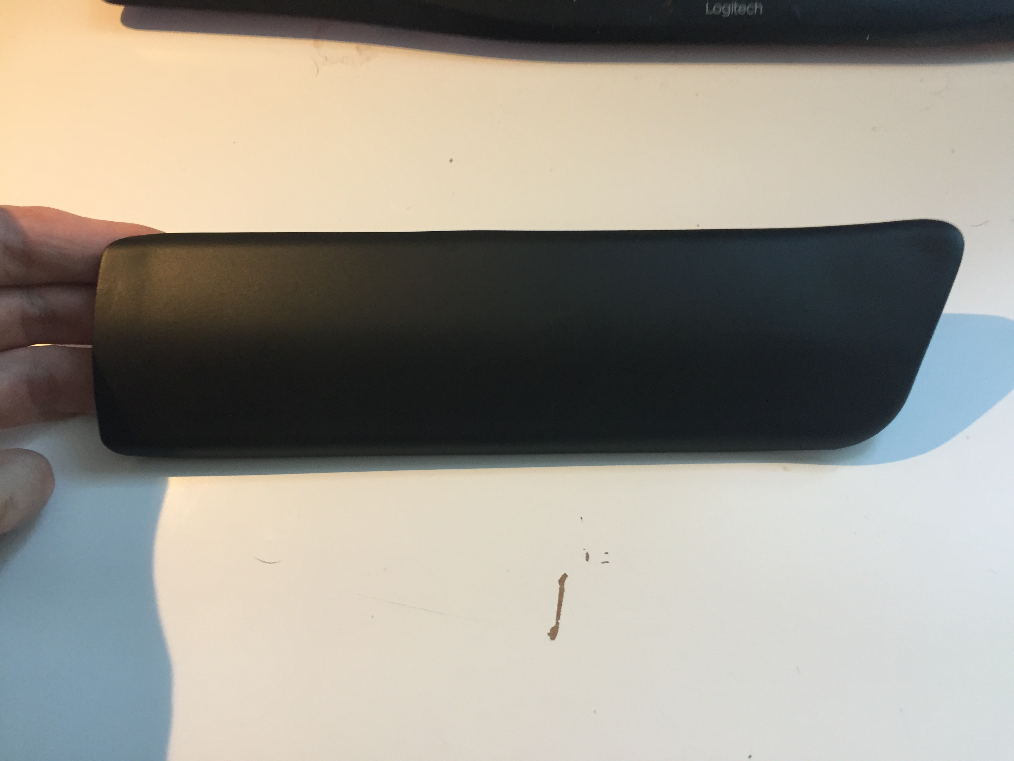

So, I'm thinking of getting the wagon wrapped in either 3M 1080 foil or Avery, so I bought myself a couple of meters to test it out. Now, I did my hood already, which was a stupid place to start, considering I've never done anything remotely like it, but it went mostly okay. Emphasis on "mostly". :lol: So I may pay someone to redo it when my bank account says it's in better health. :D
But, I'm planning to use the remains to wrap the ugly, grey trim moldings on the doors - so I pulled the smallest piece off today and tested it. Below's the result - looks pretty damn good, I'd say. The 3M is hard to cold stretch, apparently the Avery foil is better for that, but with a little help from my cheap-o heatgun, this piece went rather well. :)

Wow that looks good! Also I hope it shouldn't fade as badly, although I know wrap only has a 10 year warranty (I believe) against fading. The original part took 20 years to get there!

Fingers crossed here too. Then again, if I have to do it every 10 years, then that's fine, I guess. Maybe go for a new color every decade. :lol:
The hood turned out pretty good as well, but the clearcoat was in worse shape than I though, so it let go in one corner, and one small patch in the middle of the hood, which makes it look like there are air bubbles. The rest went well for a first timer. :) The matte black looks good on the blocky shape of these cars, IMO.
