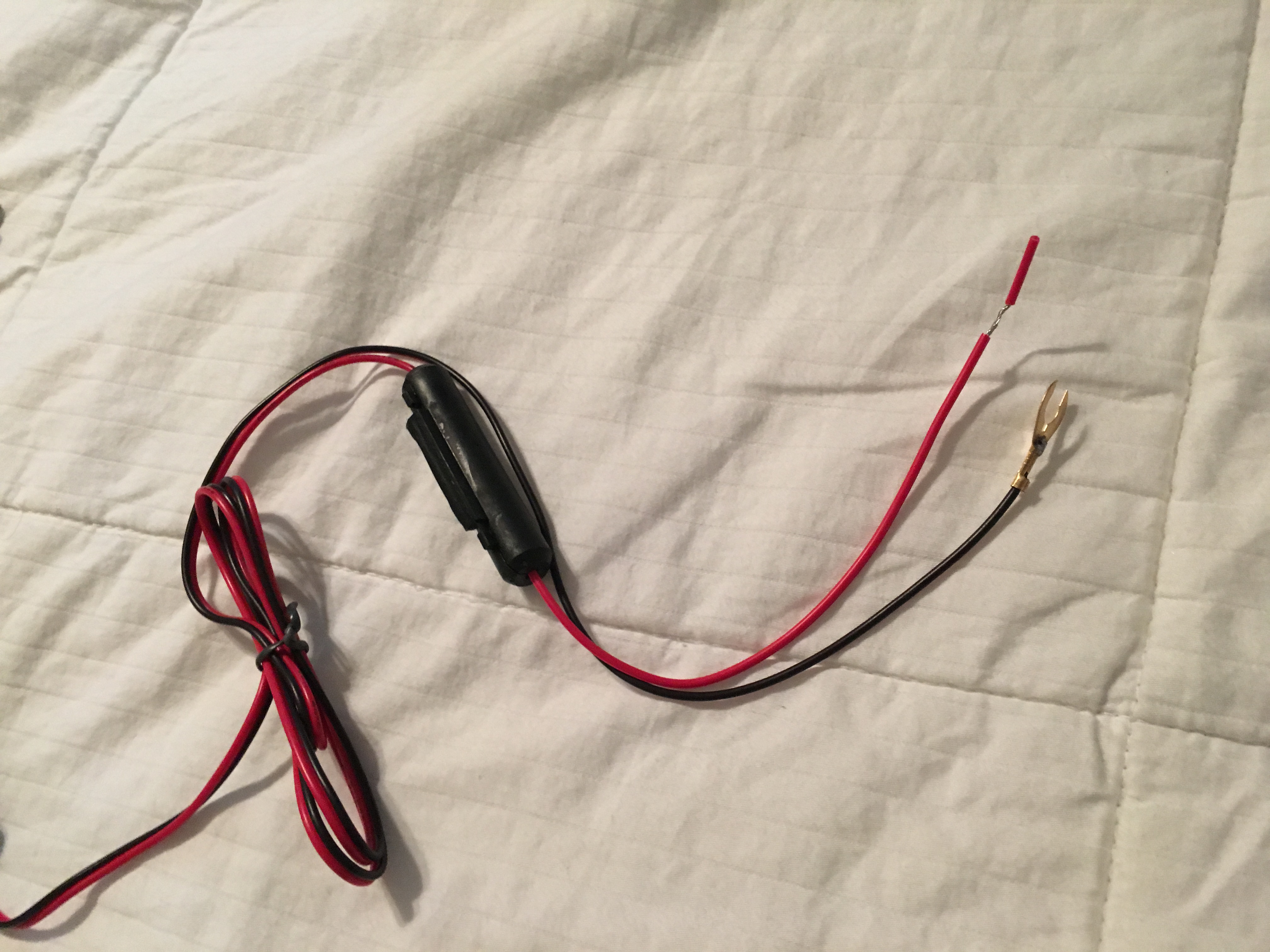

Ahh, cig lighter. Good idea, but I'm guessing the best way to get to that is to take the center console out which means there may be a chance of my perfect wood grain cracking. Also here is a pic of the hardwire kit, I'm assuming the wire with the the metal on it is a ground, anywhere around there to ground it to?Sommerfeldt wrote:Hardware it to the cig lighter wiring. I've wired in some extra footwell lighting there, and it works fine. You'll have power from position I, so you don't need engine running for there to be some juice, but it won't trickle out when you're not around. Easy access, and easy routing.

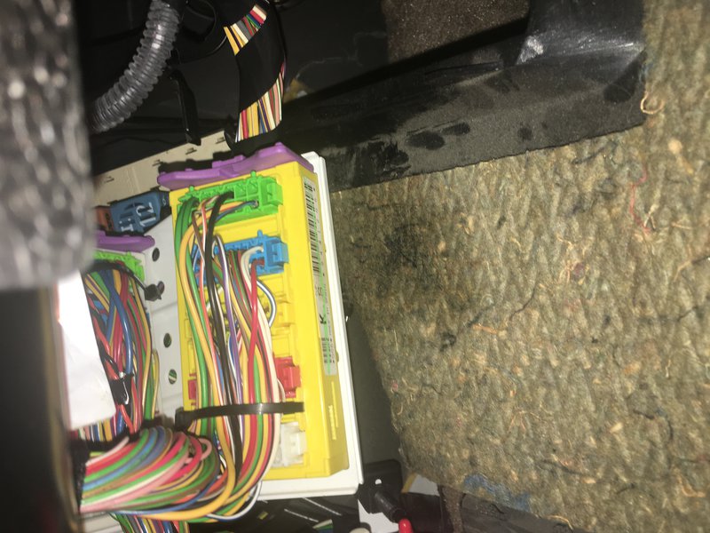

There's a yellow connector on the drivers side that's intended
specifically for electrical accessories. You'll find it secured to the
steering column support.
Constant, switched, ground, dash lights, high beam trigger, etc.
There are all kinds of power sources available there.

BEJinFbk's idea is even better - I don't have that connector anymore, since a PO did some weird stuff with some phone accessories
, but if you have it, use it.

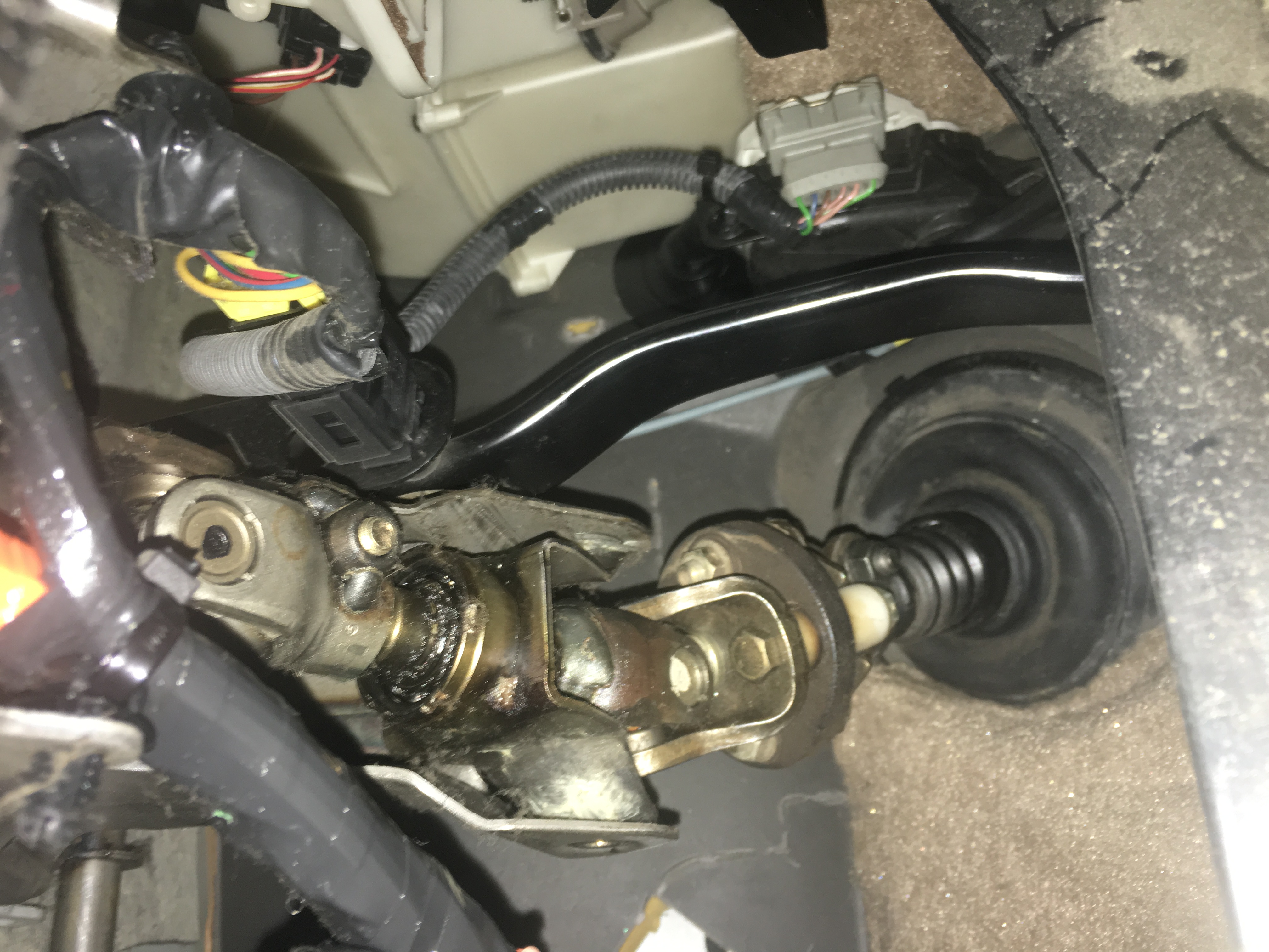

Hmmm. Are you talking about those ones with the purple release handles that plug into the yellow ones?. There are like four of them across the dash I think (when i replaced dash mounts I saw these). Anyone happen to have a pic? I just didn't want to take of the knee bolster again on the drivers side just to look as the tabs are broken and its currently being held in place with phillips screws, but I may take a stab at it later.BEJinFbk wrote:There's a yellow connector on the drivers side that's intended

If I did use the cig lighter where would I put that ground? Just around any metal bolt?Sommerfeldt wrote:BEJinFbk's idea is even better - I don't have that connector anymore, since a PO did some weird stuff with some phone accessories, but if you have it, use it.

Red to red, black to black.speedyt5 wrote:If I did use the cig lighter where would I put that ground? Just around any metal bolt?
