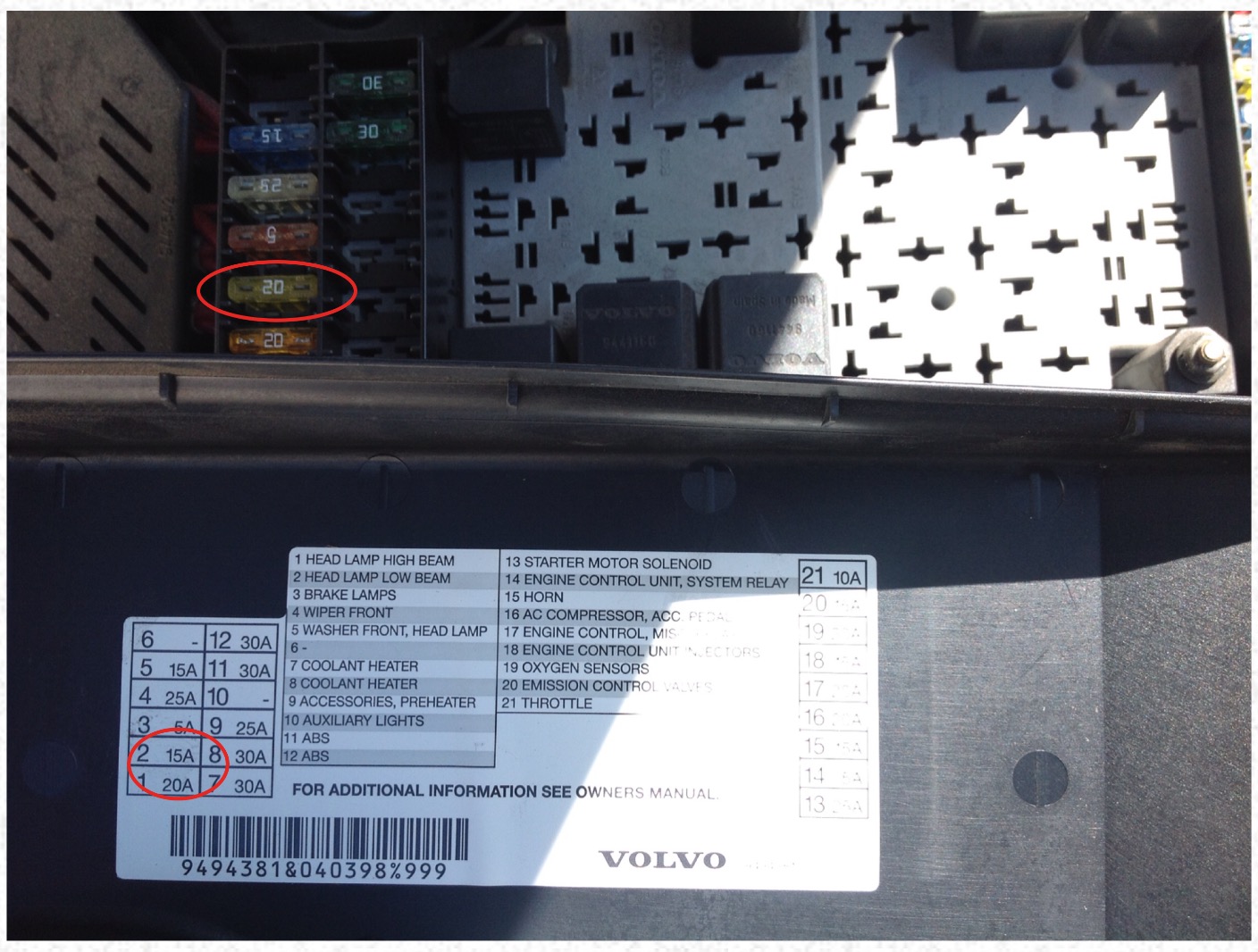

Post by THAI UNG »
You go and take a look under the hood,there is a fuses box sit right behind air filter housing box,open it up and check the fuse #2 15amps which is for controling both low beams and see if it is blown out if yes then it is the problem that you don't have low beam, I used to have that fuse blown out on me a few times so I put a 20 amps and never have a problem in last 8 years.Hope this helps...
Fuses
Fuses
