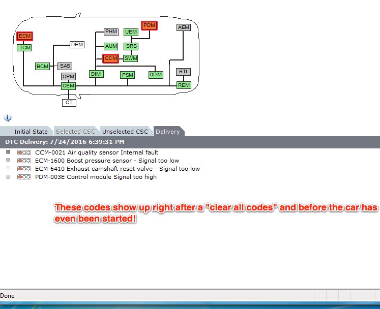

I'm included two screenshots from the car. The first one (with fewer errors) is after a "clear all" and the car sitting with the ignition switch on by the car has NOT run yet. So these errors are coming up prior to running and you will see mention of obvious things that can trigger w/o running such as the PDM and CCM. With the two showing ECM (boost pressure sensor (single to low) as well as the VVT valve (signal to low) are these telling me there is an issue with the wiring as it's throwing a code prior to even running?

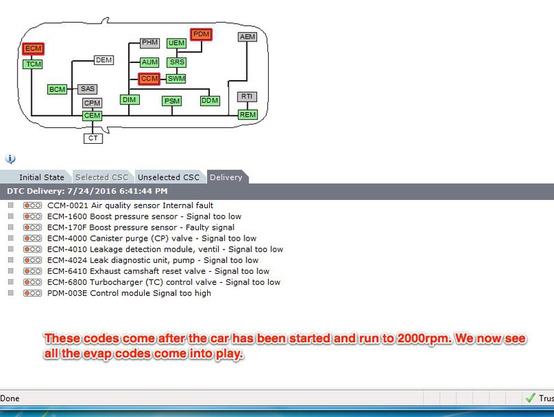

The 2nd screenshot is off all the errors after the car has been started and rev'd to 2000+ RPM.
What do you think is at work here?
A turbo signal, waste gate issue aand/or evap issues?
What is this ECM-1600 Boost Pressure Sensor it speaks of, is this the TCV? If so do we have a bad wire he we put a known good one on?
