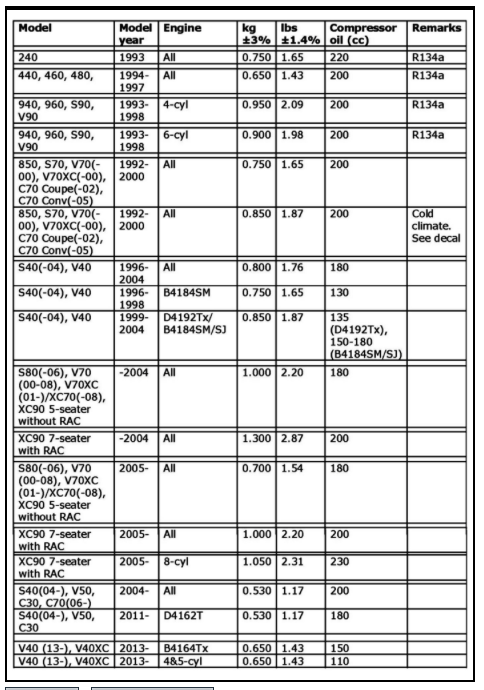

Posts: 35311
Has thanked: 1506 times
Been thanked: 3822 times
E Showell wrote:Thanks Lee. I have three 12 oz. cans of 134a with dye. Should be enough to do a complete refill. I'll see what I can manage on the compressor install. Not happening today since I have to work outside and it is pouring here.
About 2.5 cans I think, edited bad information hopefully before anyone notices

Post by E Showell »
Yep. Thanks, Steve. I seem to remember you posting this, or something similar, on a prior a/c thread and that's why I went with three 12 oz. cans of Arctic Freeze for about $12/pop at Harbor Freight when I was in there last.
