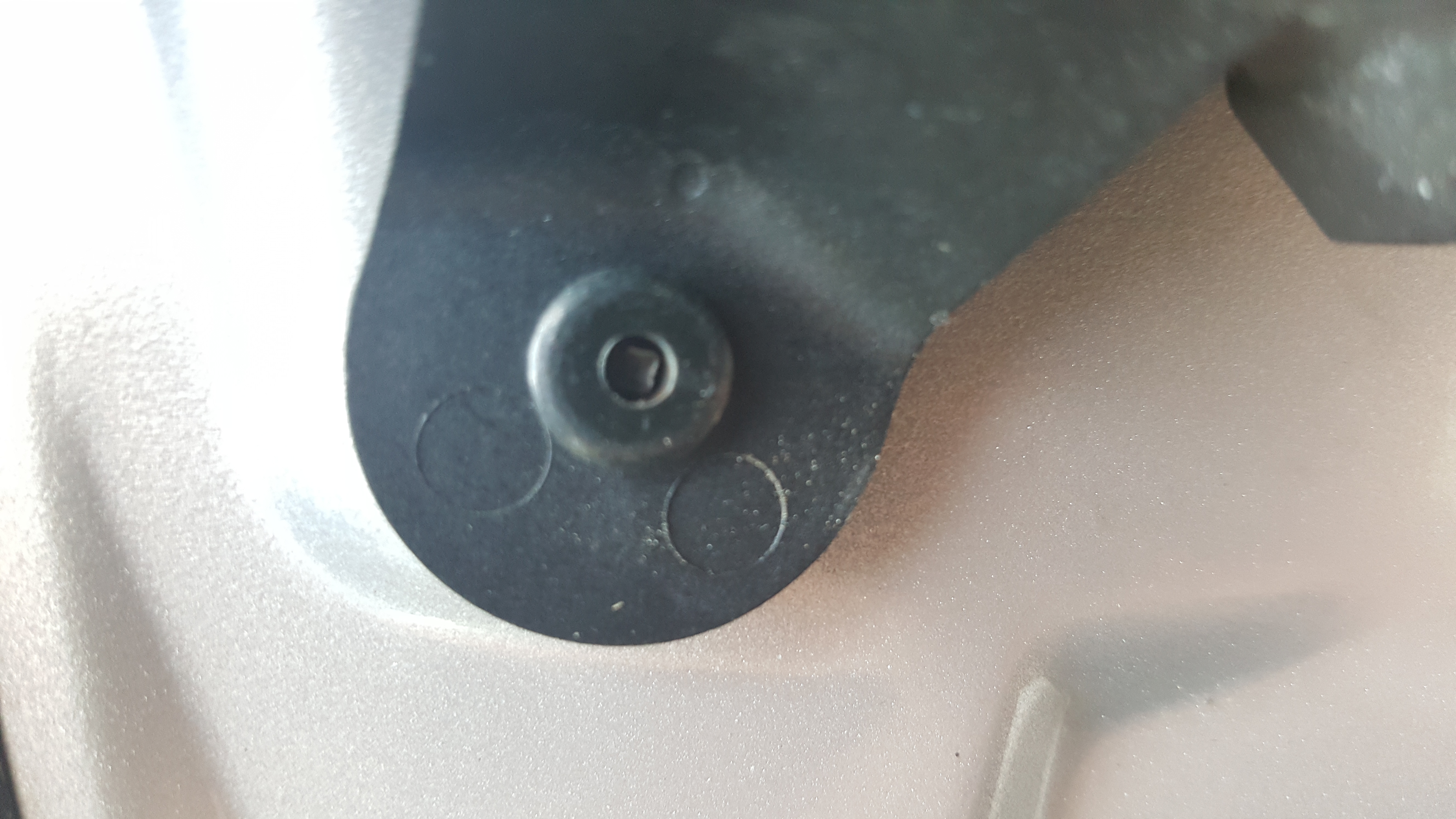

They are pop rivets, also called blind rivets - one time use. I can't tell from the picture if they are metal or plastic. I have seen Volvo also use them for holding some of the fender liners, mud flaps, etc. To get them out, it's probably necessary to drill the head, then replace them with new ones.
Guessing that you have a 2.5T, (or that your speakers are identical,) the rivet is listed as 4.8x11 for dimensions, Volvo part number 973884, and VolvoWebPartsStore sells them for $1.01 each. Or, if you have other resources, I am guessing that 3/16" x 7/16" ought to do the trick.
