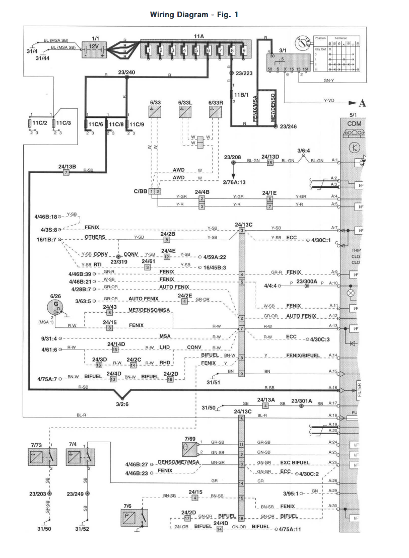

Its connecting pin A15 on the CDM to pin 31/50 connector, only 1999 ME7 - I think your 2000 is the same
I know thats useful to someone, but not me.
(Im still current tracing it)
OK - think I have it. Its a bit strange.
X terminal (12VDC from ignition switch) feeds 12V to terminal 31/50. When the coolant sensor closes it feeds 12V to pin A14 on the CDM which I believe keep the low cooling light OFF
If you run low on coolant, or disconnect the sensor, 12V drops off and the coolant level light is turned on.
This needs to be confirmed, but the cooling level switch is shown as normally open - this is how a good engineer would design this, by the way.
