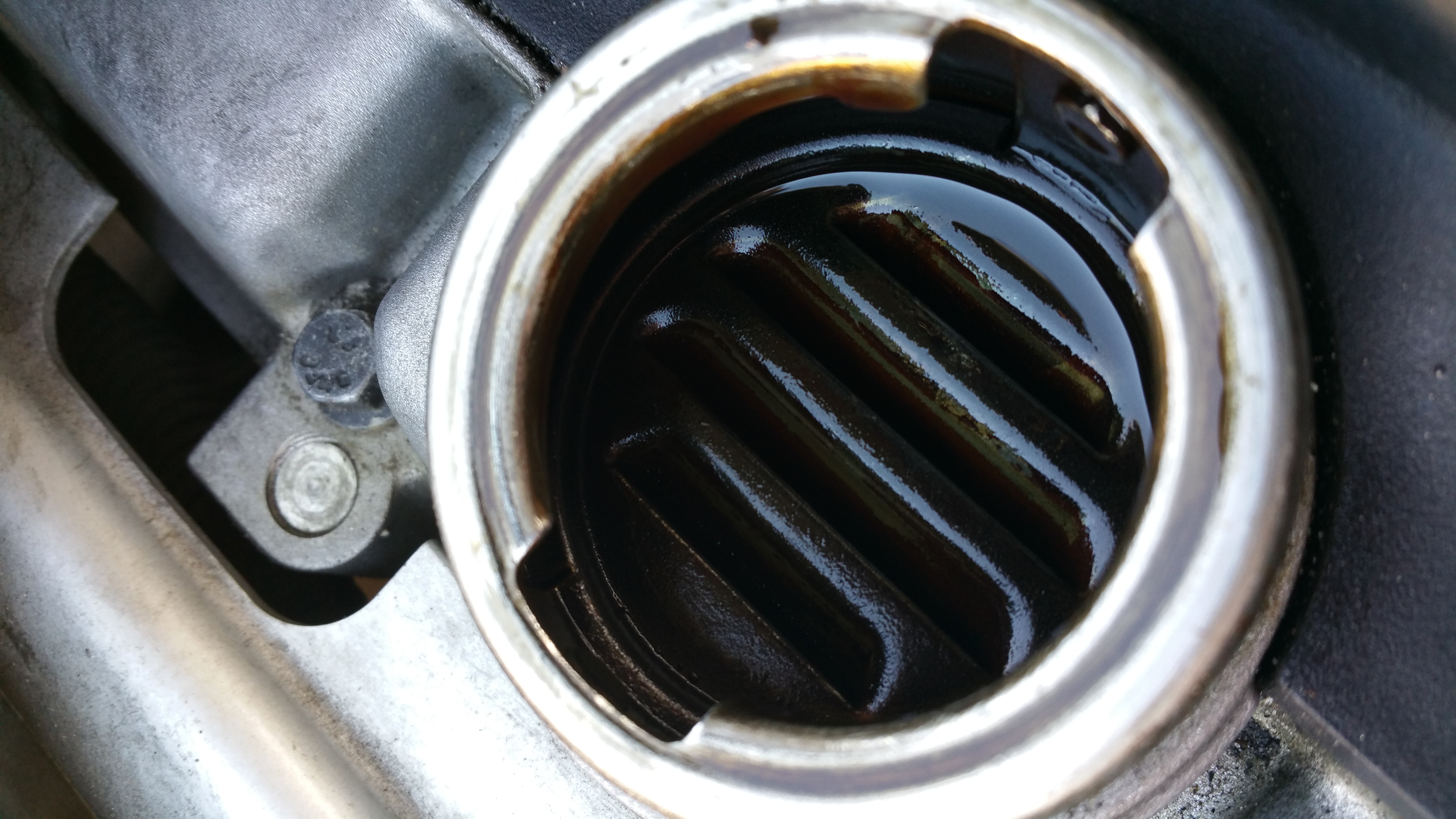

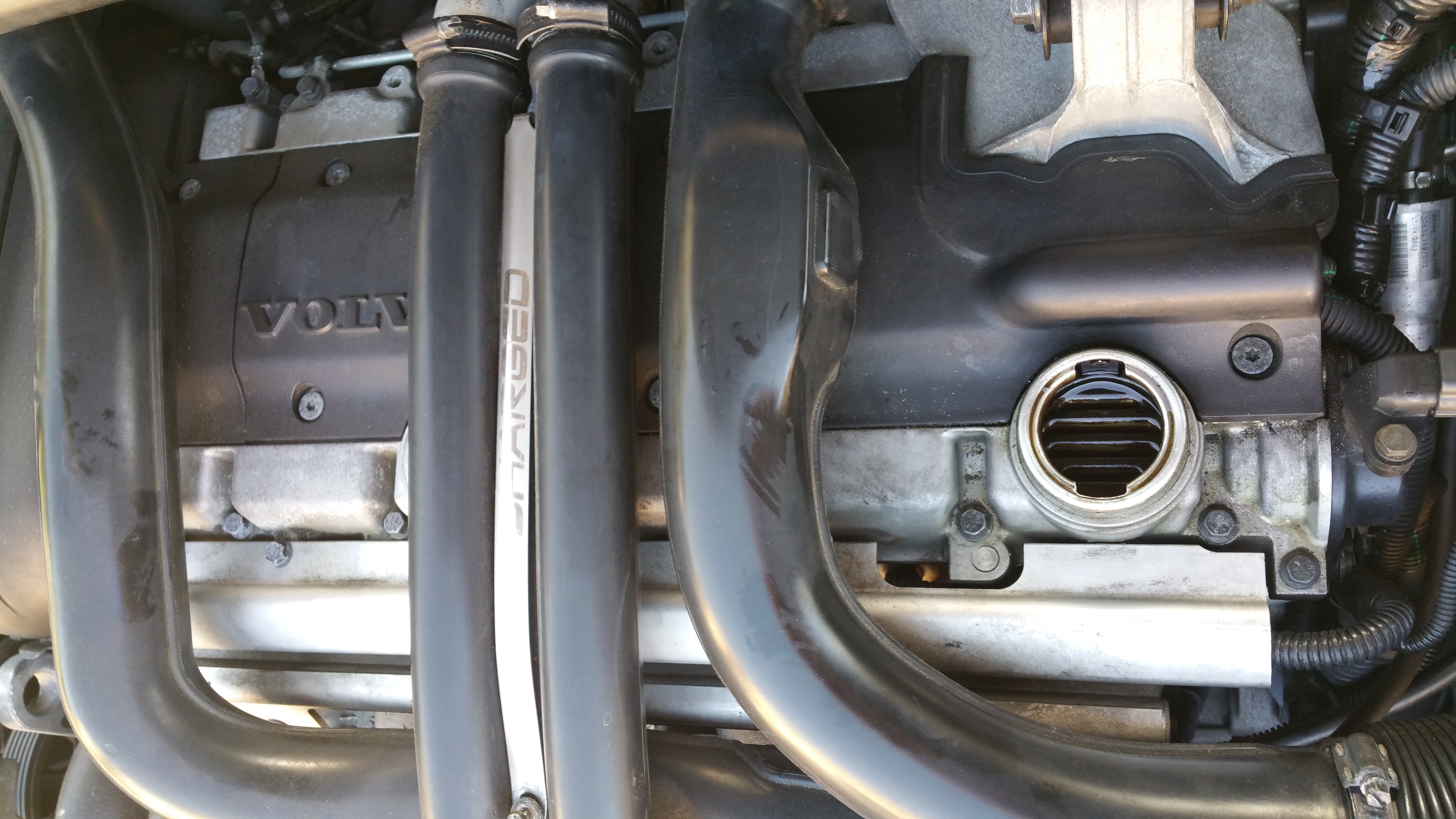

10k is insane in my opinion. My car has had synthetic oil from my Volvo dealer approximately every 3k and this is what my engine looks like under the oil cap. Some years 3k took 8 months. Castrol synthetic is not that impressive. My car is a 2004 with 134k. A couple of years ago when I noticed that the engine was dark under the cap I looked through the grates with a flashlight and the head looks clean but the cam looks like it has varnish coating it. The impurities must collect under the cap due to those grates. What would my engine look like inside had I done the 7500 miles change as Volvo recommended or these newer cars at 10000k or nonsynthetic? I probably would have a clogged engine and pcv system. It the long run where it makes the difference, not those who trade every couple of years. JuneMadeInJapan wrote:What I was saying was that I think 10K intervals is to long, even with synthetic. If I'm wrong I'm sorry but I haven't been convinced yet! I agree with everything else you said.

June, 3000 miles on synthetic is wasteful. No judging! Your engine is really lightly sludged, if at all. Varnish is normal.
