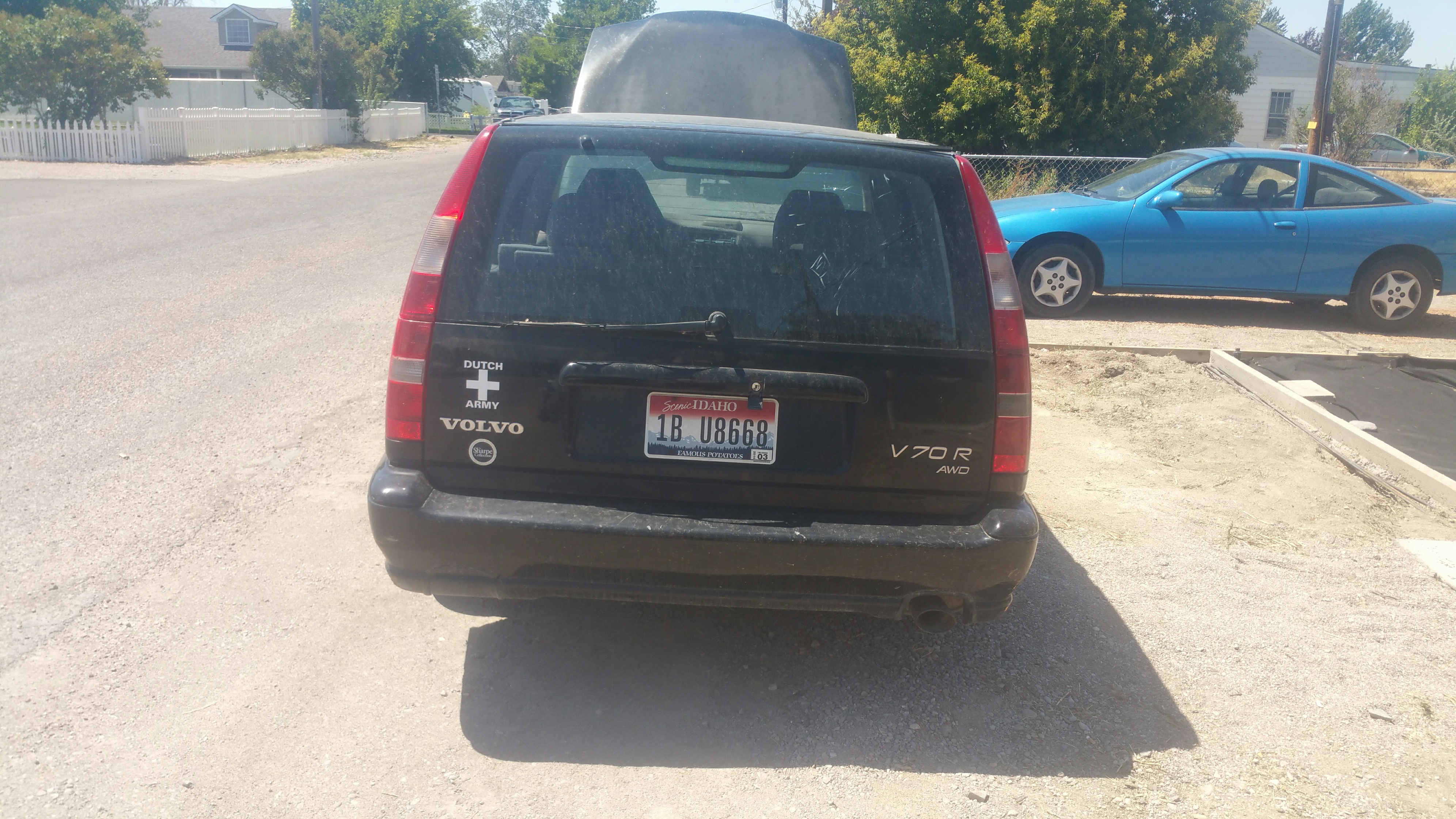

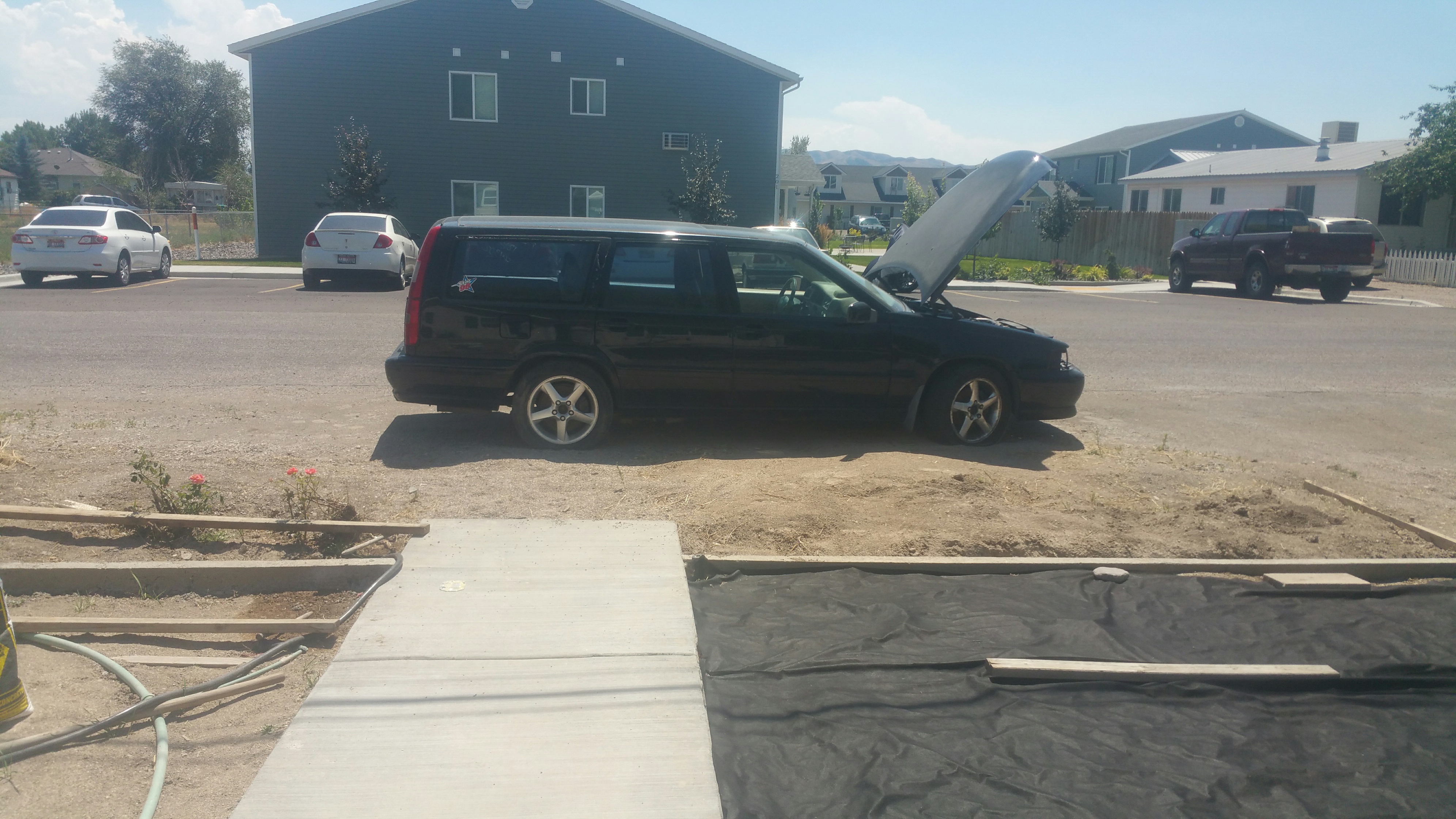

So here I am, back in the volvo community. As a prior owner of an 855 turbo, I had almost literally a gem of a v70r dropped in my lap. Saw it sitting in a tow yard around november 2014, it disappeared and then I found it again in my cousins driveway because he's a mechanic and does side jobs in his driveway. Cut to today. The owner as well as my cousin have given up and handed it over to me just about free, lol.
What ive been told is that they did timing belt and found it to be one tooth off on timing, compression test they said it has good compression, swapped out both cam and crank sensors, did find a crank sensor on floorboard. Basically they are convinced its an ecu issue, which I am not. I have a feeling it may have something to do with alarm or immobilizer system. I'm just not sure if either of those systems would cut power to the coil causing no spark. It does crank.
