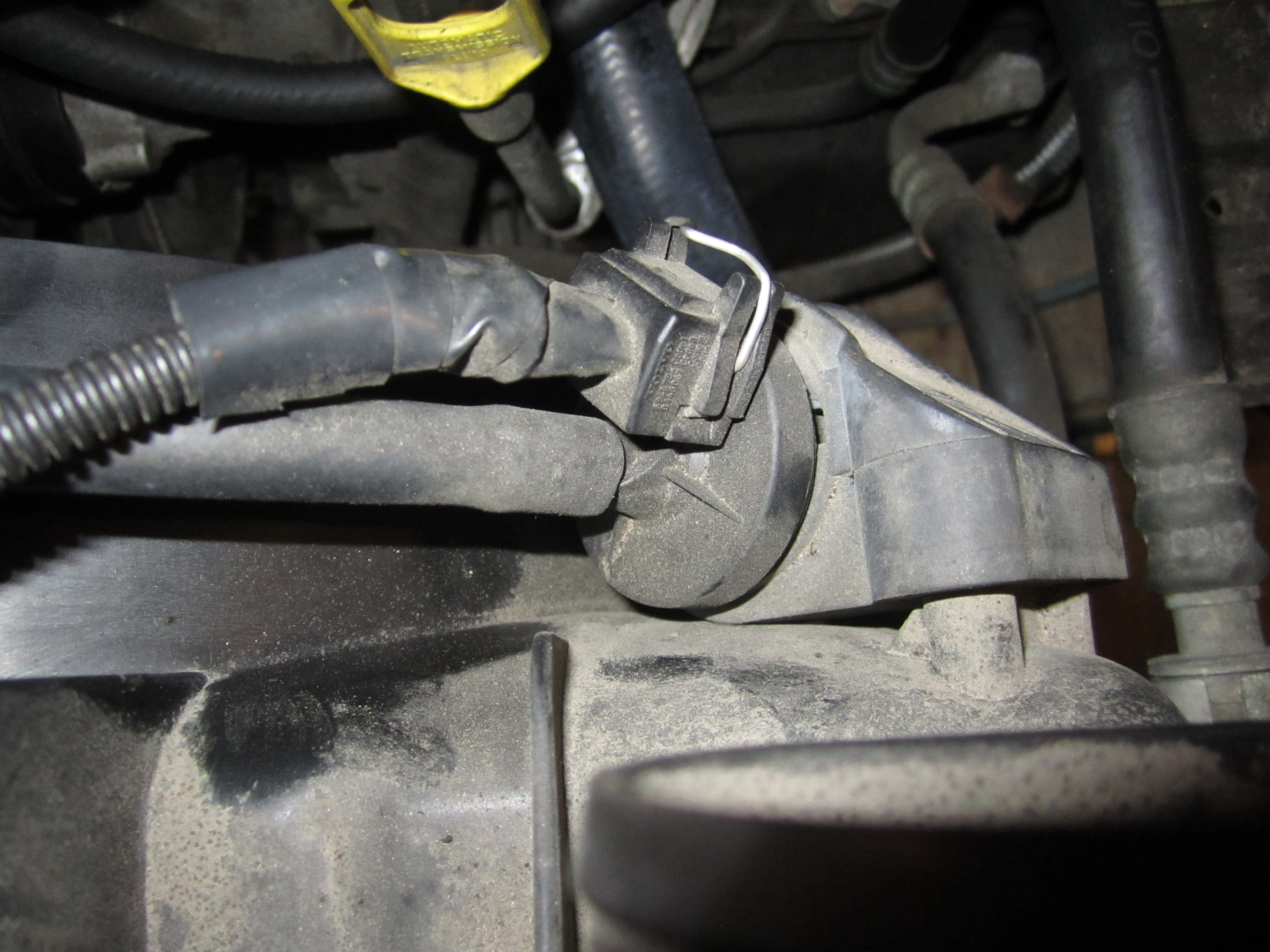

If your car is the same as mine and a non-turbo, then that line does not go to the CBV (Turbo - Compressor by-pass Valve). It goes to a solenoid valve on mounted to the LH side of the radiator (Right hand side when hanging over the slam panel).

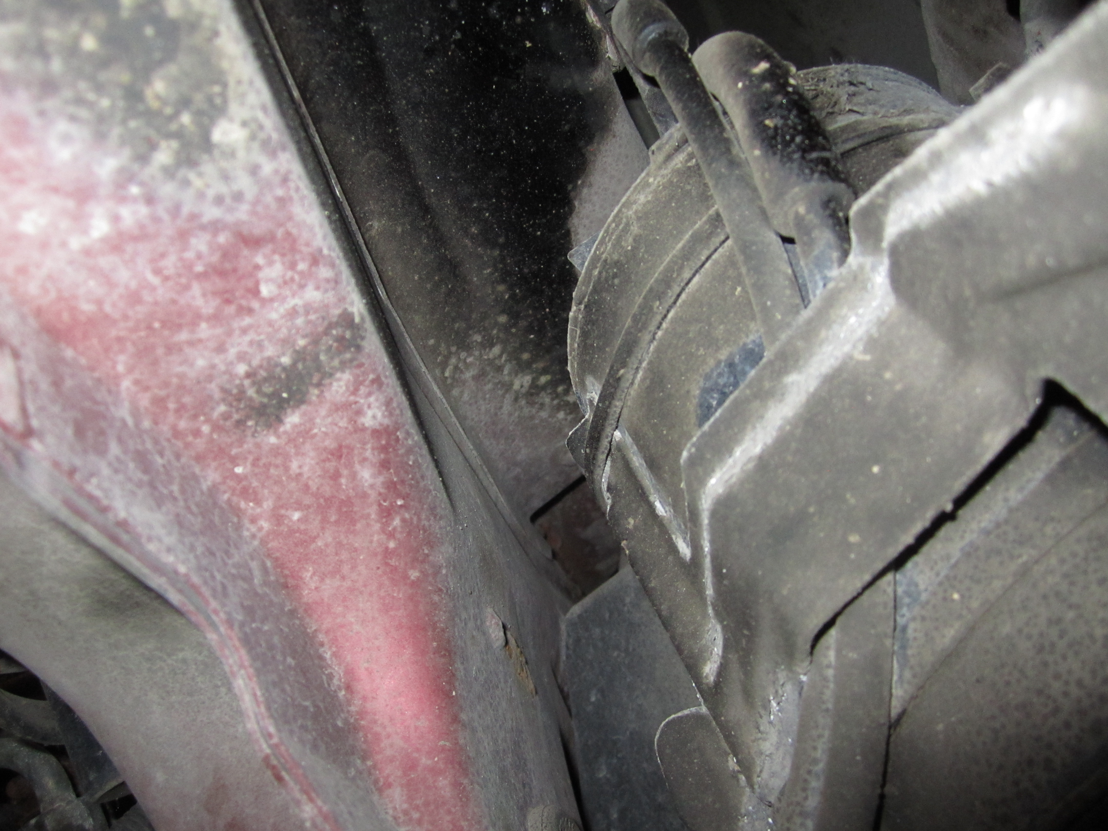

I have taken a few pictures for you and hope they help!

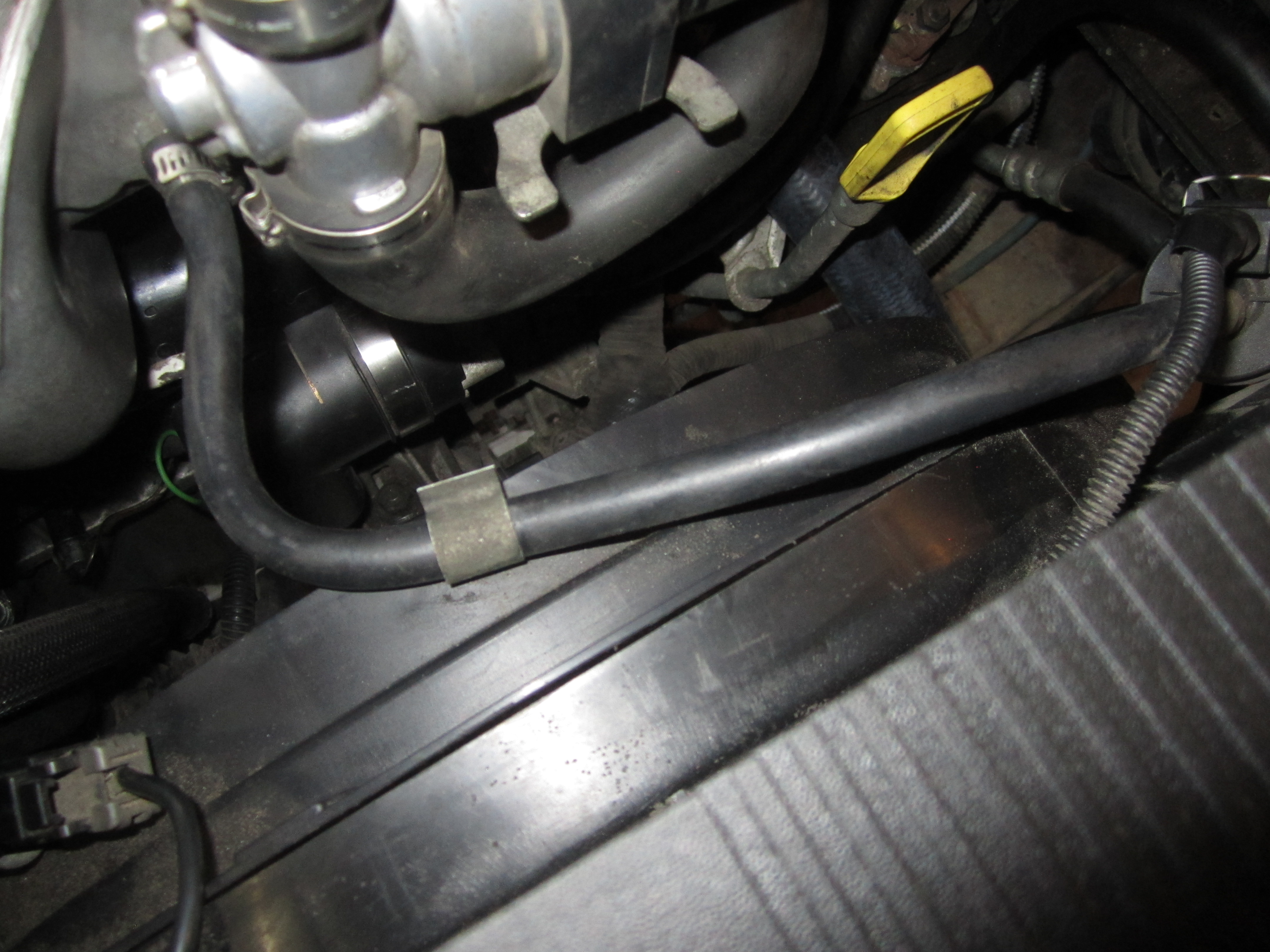

Carbon filter pipe from intake

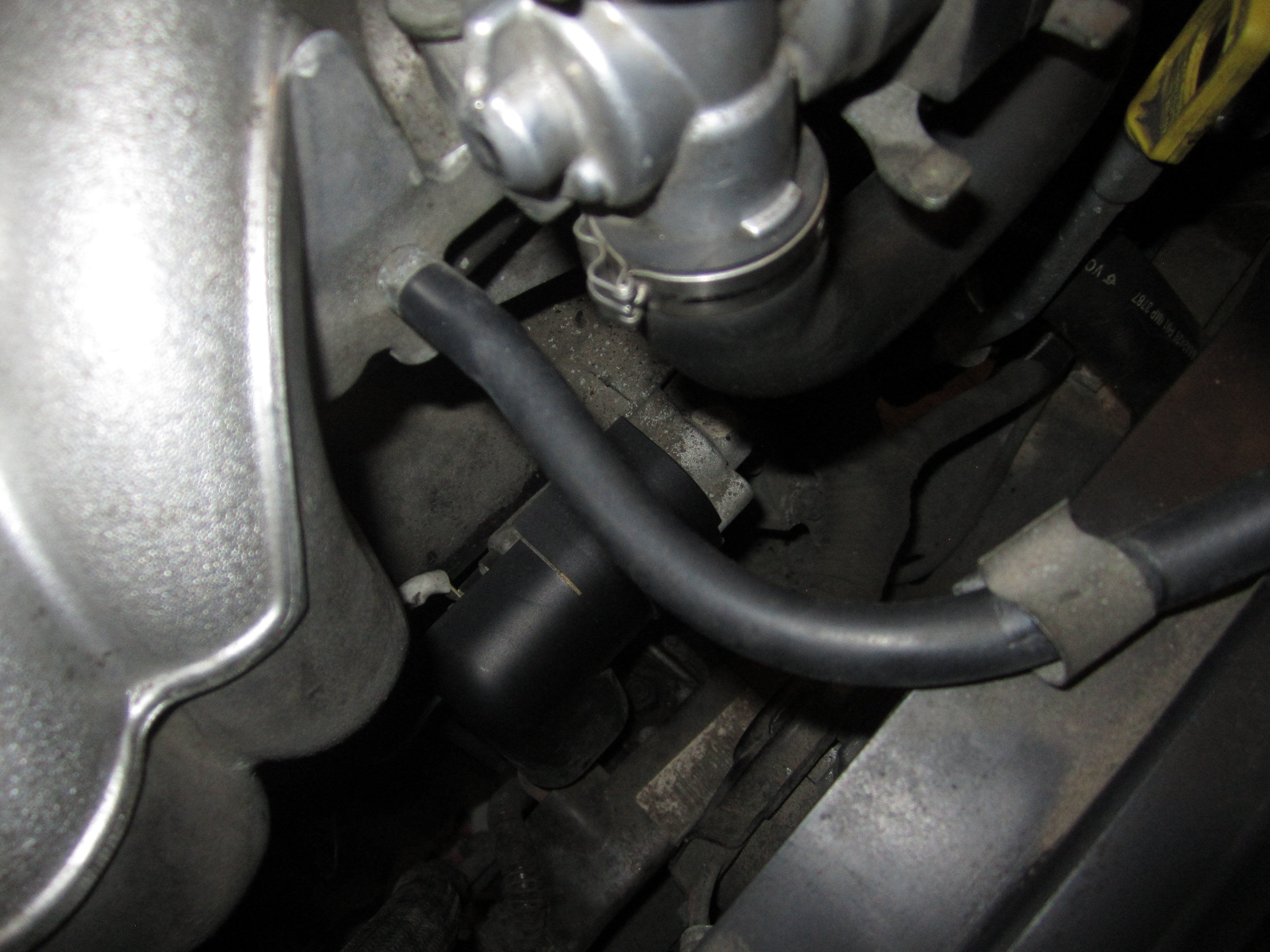

Solenoid valve I believe

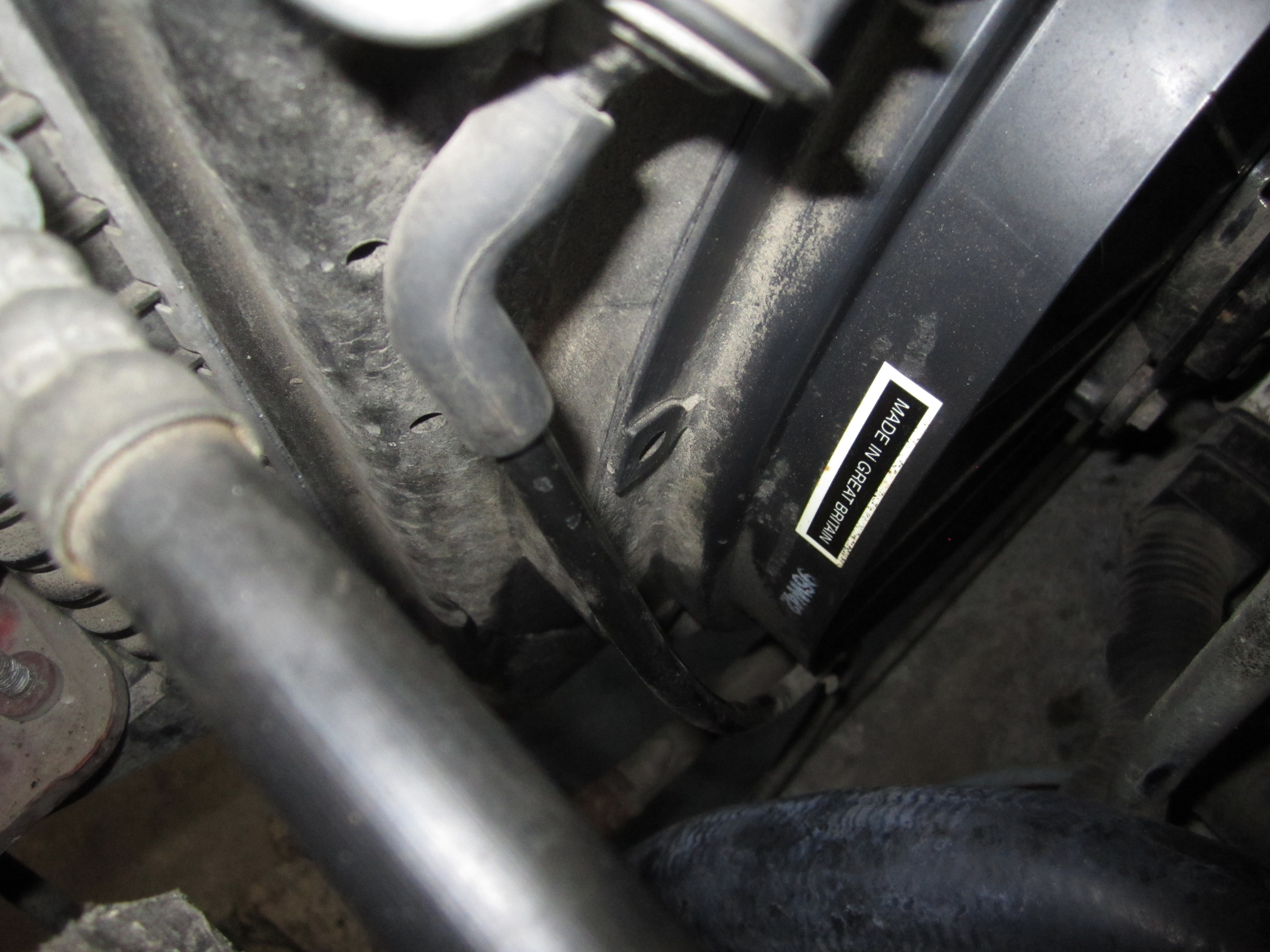

Pipe from valve runs down side of LHS radiator

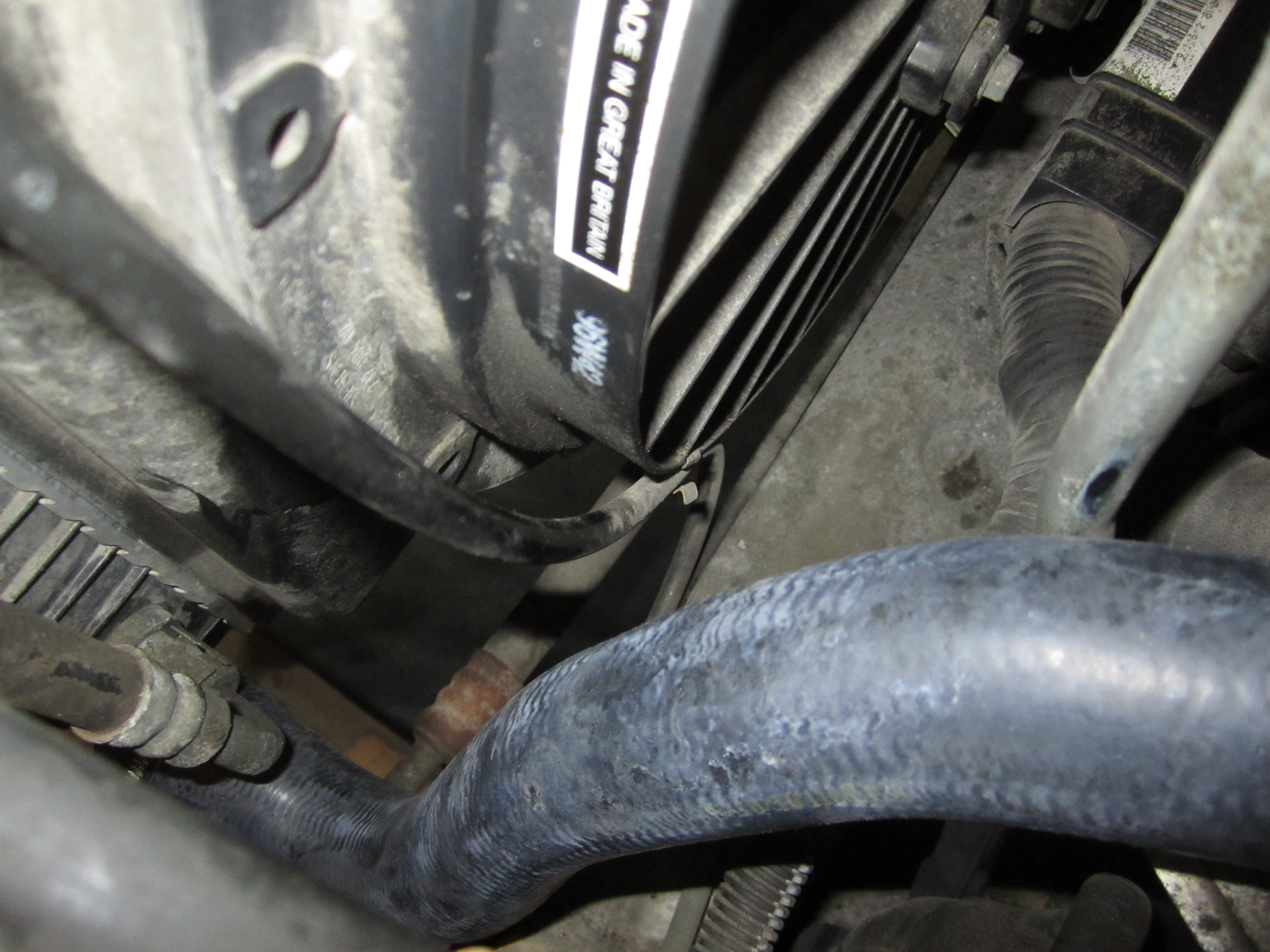

Lower part of LHS of radiator

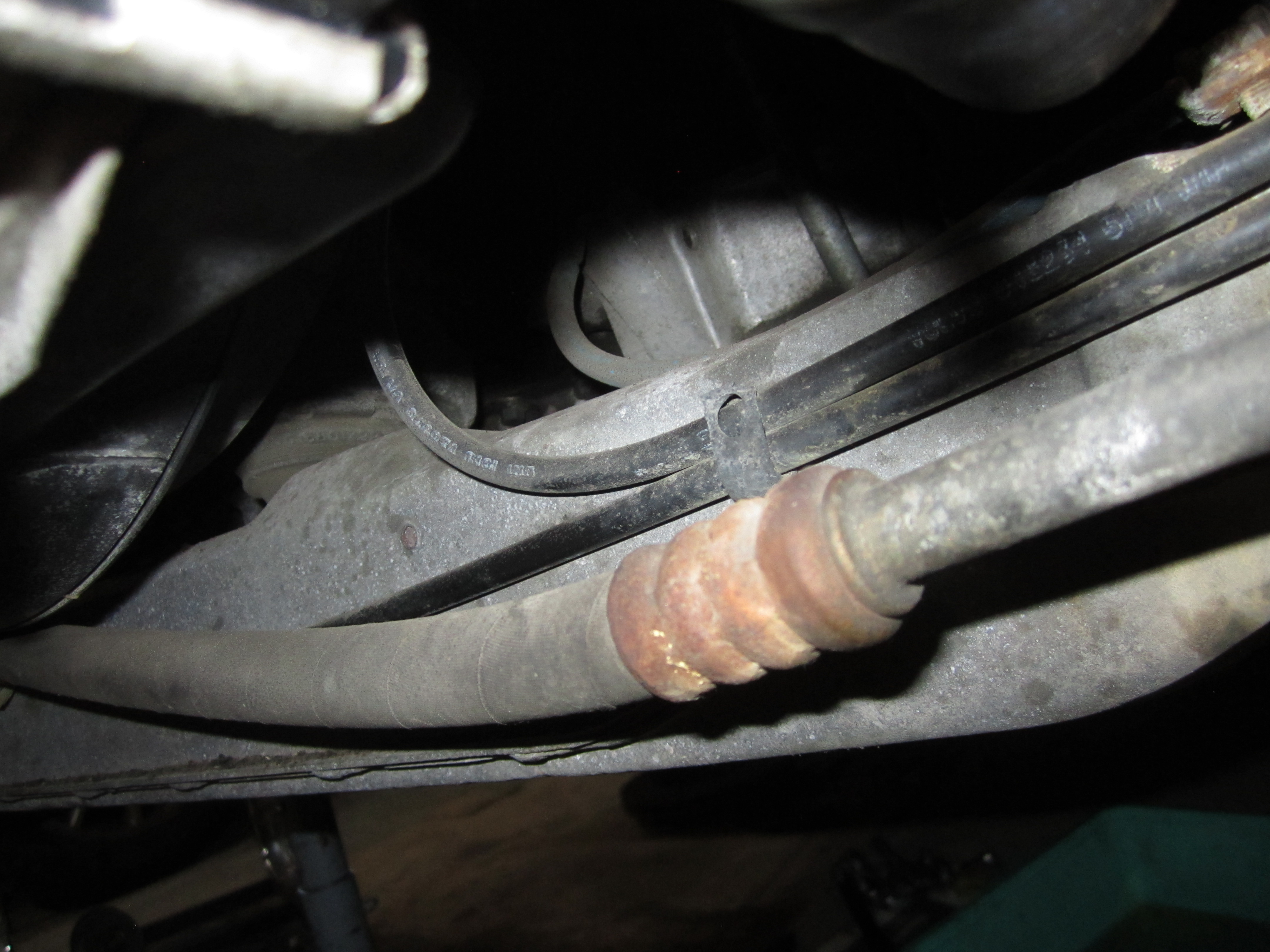

Under front cross-member and meets fuel tank line

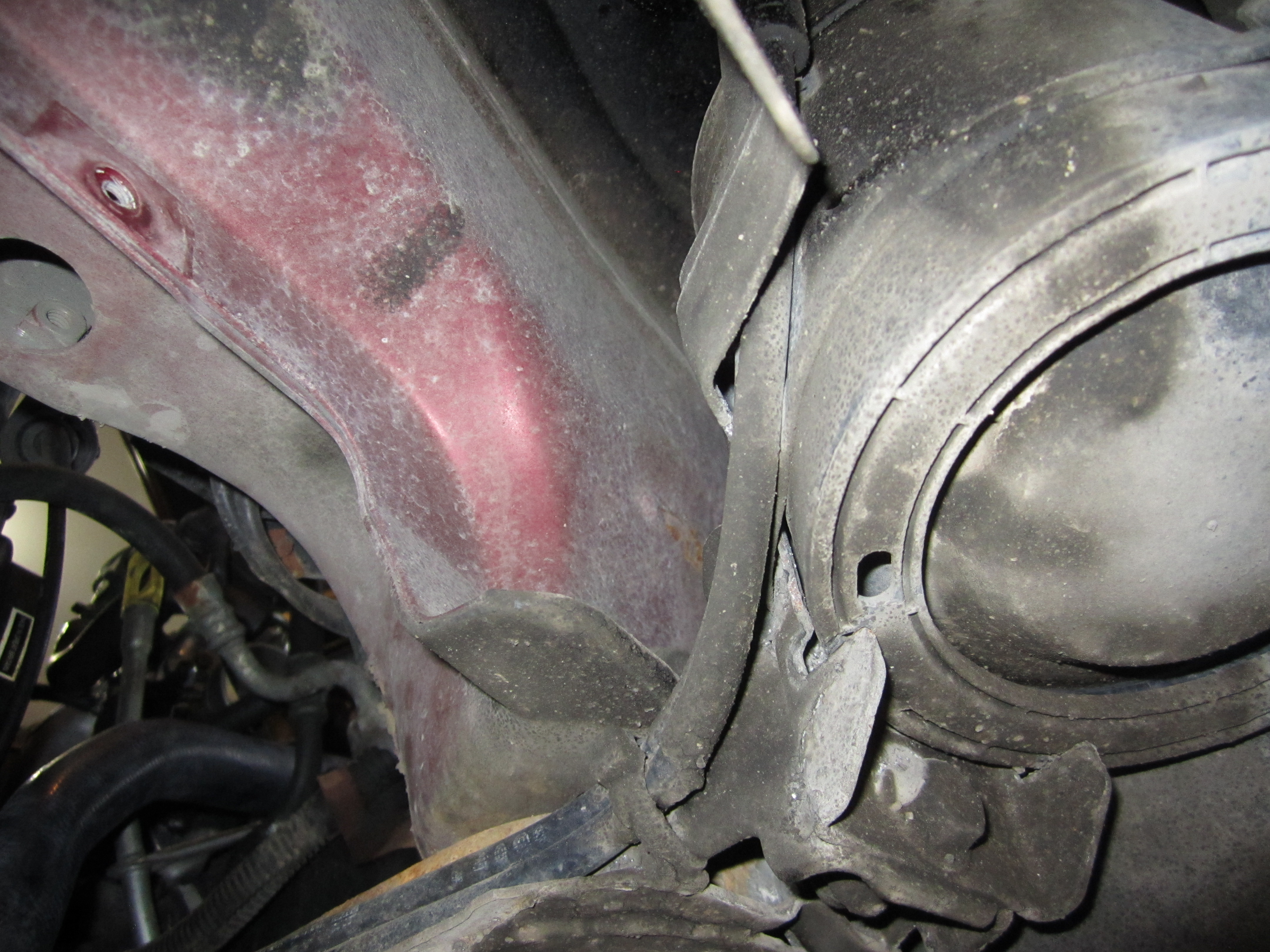

Lines runs to under LHS front of wheel
Carbon filter in front of LH front wheel
Hope this helps!
