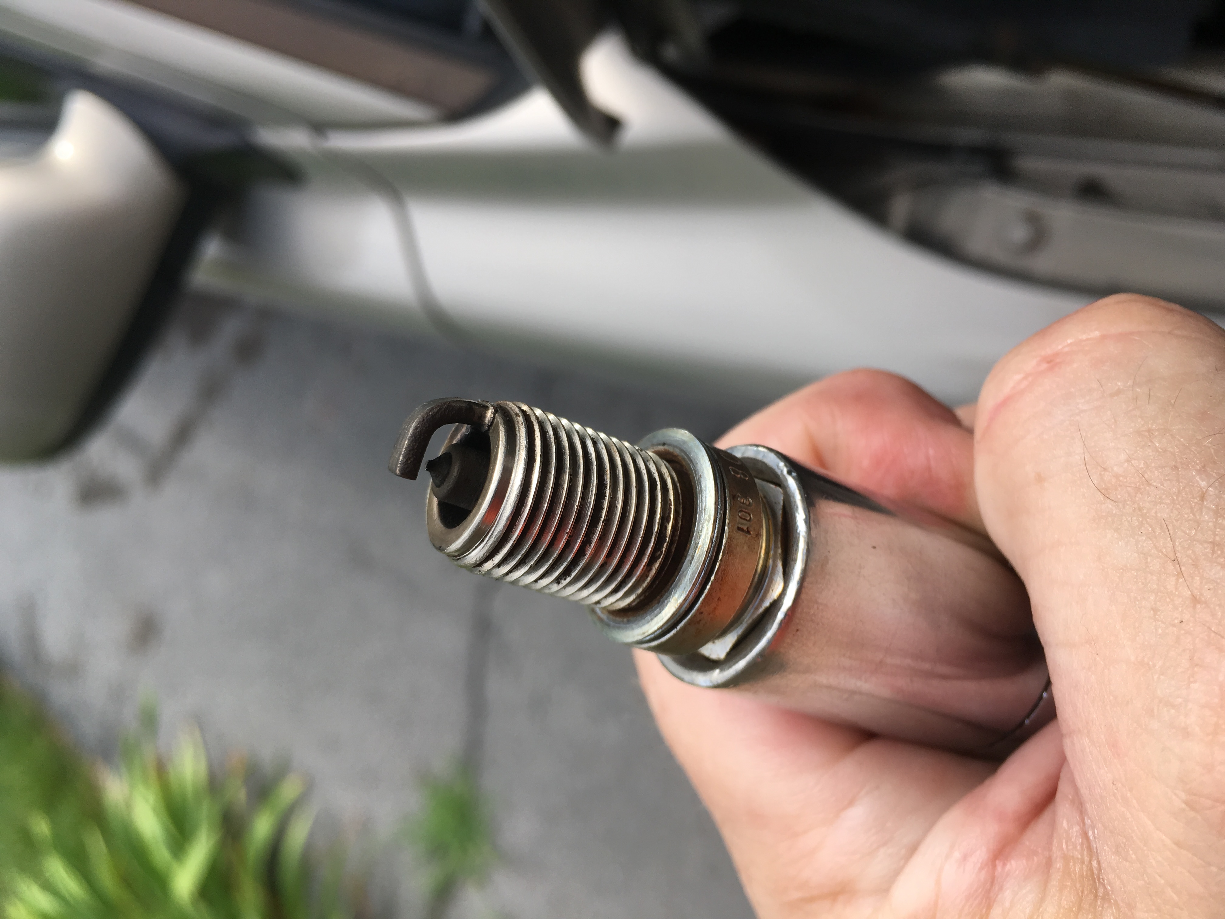

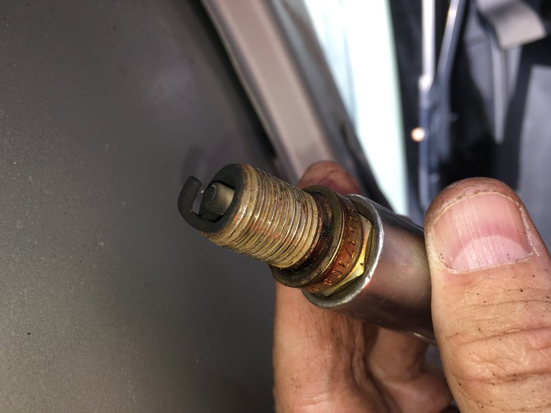

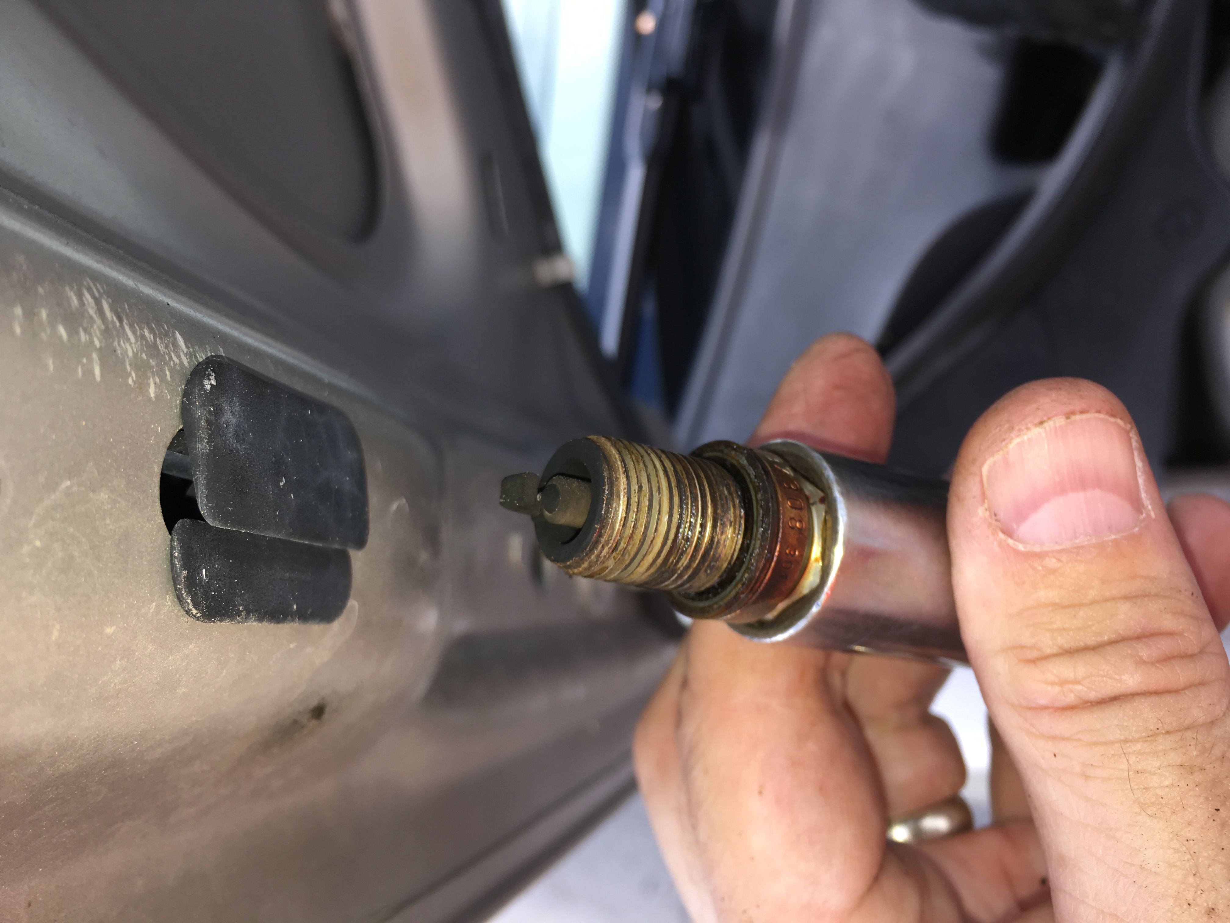

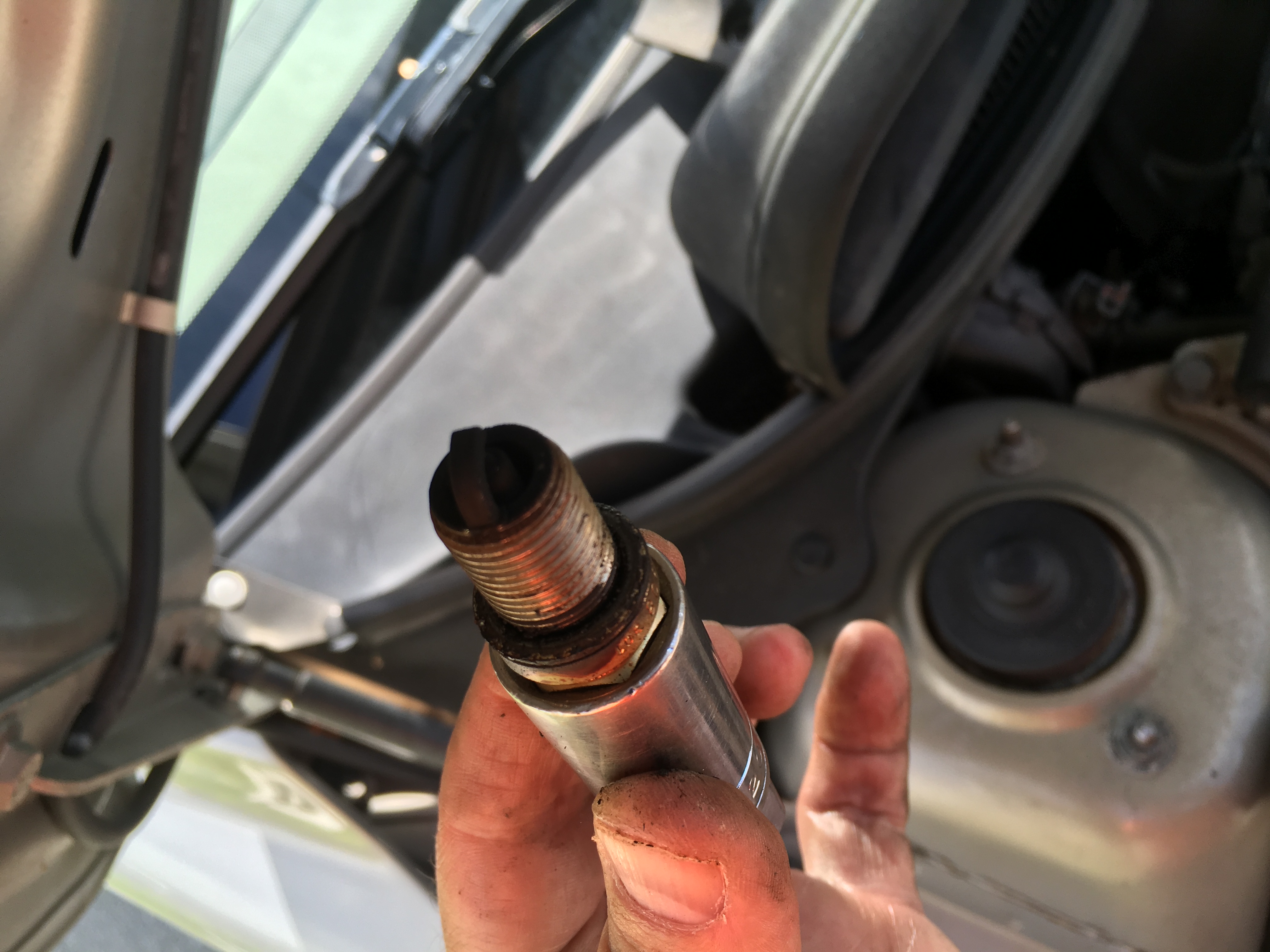

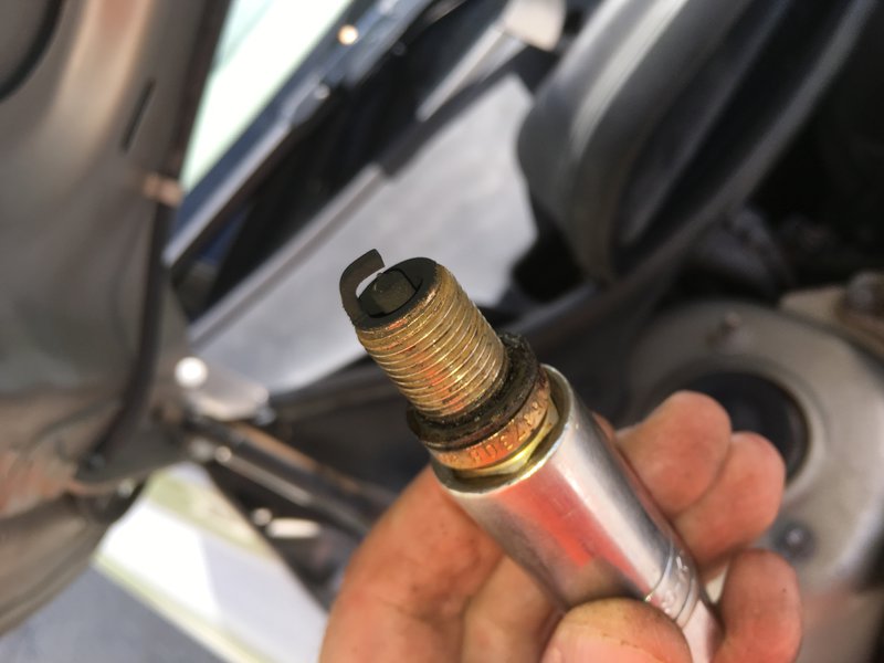

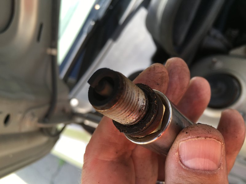

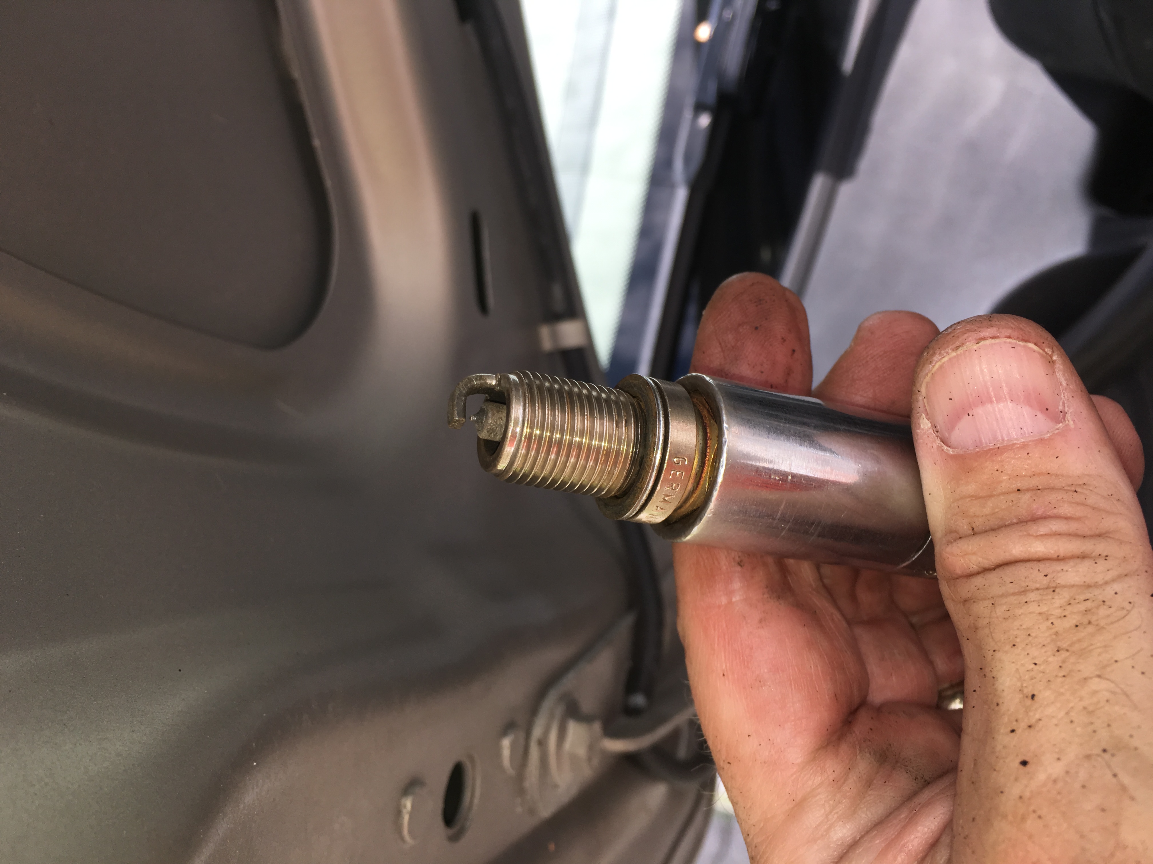

Pull the plugs, inspect them, snap a pic and post here

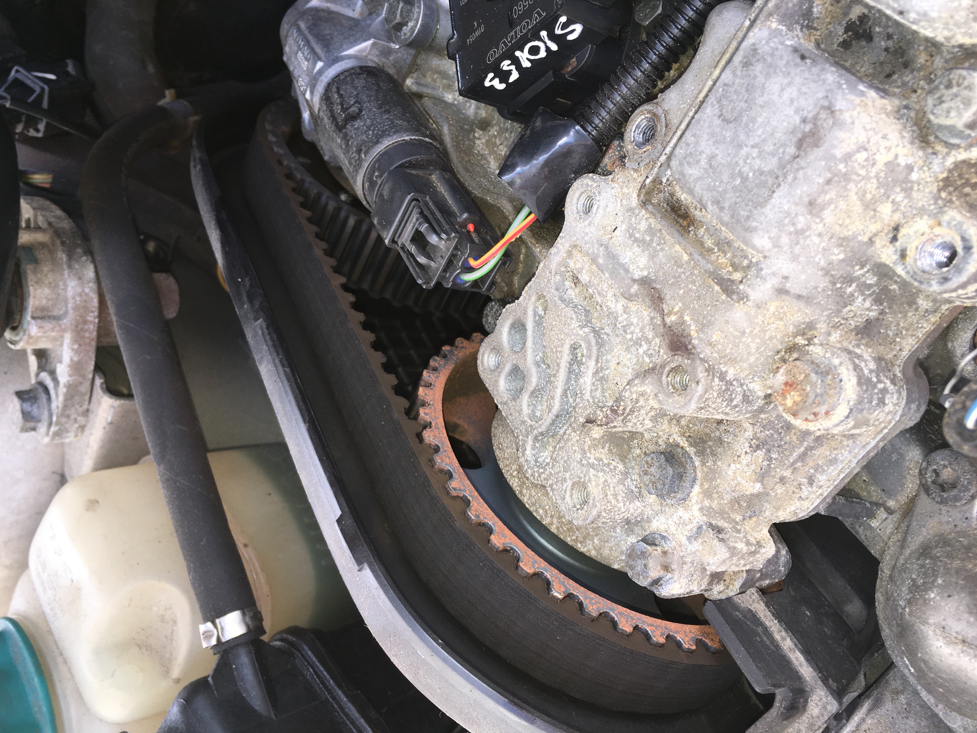

While you have the cover off, confirm the timing belt is intact and moving on the cams ( look on passenger side of top of motor)

Ok here we go. Pulled all plugs inspected and cleaned the carbon off reinstalled. No excess gas found on the plugs after cranking the engine. Found third plug wasn't firmly seated. Checked cyl pressure with my 1970's tester. Got a reading around 150 psi on all cylinders. Checked for spark on the last cyl and she was good. Timing belt firmly seated no odd noises coming from the head. Fuel pressure at the rail is a steady 55psi. The old fuel pump was tested at 25-30psi.

Running very rich. Lots of excess gas. Take a good luck at your induction hoses from the turbo to the intercooler and from there to throttle body. If any get loose, that's what you will see ( and a no start , too)

The plugs weren't damp and didn't smell like gas. It took a wire brush to knock off the harden carbon.
