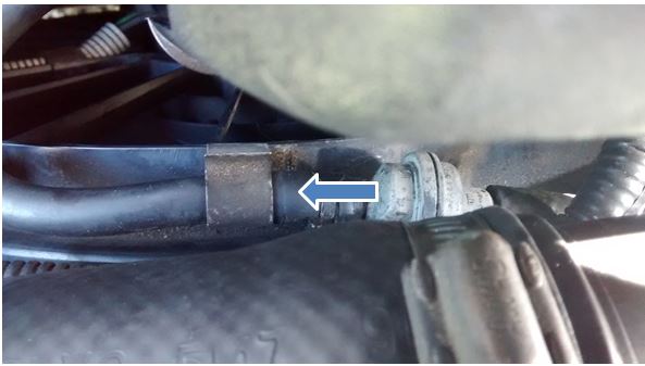

While finishing up some other repairs I noticed that the arrow on 1 of the 2 check valves in the engine bay could be pointing in the wrong direction. Can someone assist? The main evap line comes from the canister under the car back by the gas tank, routes underneath and up into the engine bay to the side of the fan, then heads toward a T. One direction from the T goes to the intake manifold -I know the arrow is correct on this on- it points to the intake manifold. The other direction at the T i can't figure out which is the correct direction to point. The T goes straight back tiward the firewall and down, attaching to the turbo tube.
Is this one pointing the right direction? In this pic it points to the firewall, but car runs with it in either direction. I thought it was supposed to route air up to the T and then over to the intake manifold , which is not what's in the pic... ?? :

That's right. One flows to the intake when it is under vacuum. Under boost it shuts off then the other one takes over and flows ahead of the turbo back to the intake. It's one or the other but never both.

Also, they are check valves, so, if you can blow through it in the wrong direction, it is bad and can cause a P04xx code.

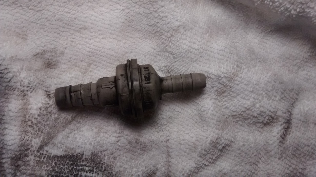

Thanks for the replies chrafael and rspi. So, I will leave it with the arrow/flow pointing back to the turbo tube near the firewall (hose in the top picture). Also, after stuyding the checkvalve itself and trying to match it up with new hose, I noticed that the "in" direction has a larger opening than the "out" direction. Say what? The smaller diameter in the "out" direction seems to match up more with the size of the nipple it fits on back on the turbo tube than it does to the thicker hose coming right off the T. So I guess my mystery is solved (and I wont have any evap codes from the wrong direction), one arrow points to the IM, the other points directly back to the firewall.
The diameter is different...
