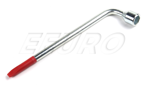

I used the lug wrench that comes with the car. Inserted between the cv joint and transmission housing and pry.

Prying with anything can put a lot of pressure on the trans case. Usually not a problem just saying. The wedge is hands down the best way to go, tap it straight up.

Prying works, I've done it but it can take a lot of force and grief! I agree with Erik11.
