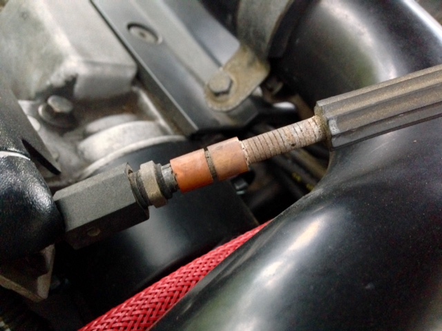

I noticed a lot of cracked sheathing on the throttle cable on my '97 855 GLT at ~180k miles. This is the original cable as far as I know and it seems to be working smoothly with no problems noted. Would you guys take a look and let me know if you think this requires replacement please?

+1. I've also never seen a throttle cable fail, and I've had 3 of these and an S70 for a while. My current one is 25 000 km over that 140k miles limit by now. There's also other things I've seen claims about recently, such as o2-sensors, linkages and bushings to mention a few, and I just don't think it's true. All wear depends on such a multiplum of factors - weather, storage, parking, road conditions, temperatures, humidity, other parts, other replacements, accidents, and a thousand others, that it's impossible to tell.erikv11 wrote:These blanket statements that such-and-such part usually goes out at xxx miles tend to drive me nuts (maybe I already am!). They're showing up more and more on the forum yet, in my experience, most (like this one) are inaccurate.
In this case, I don't think cn90 is correct - it's not a safety issue. An e-brake is a safety issue.

jreed, if your cable works fine, then I guess you can leave it alone.
But if this were my car, I'd replace it, you will see the difference, the gas pedal will be "feather light".
