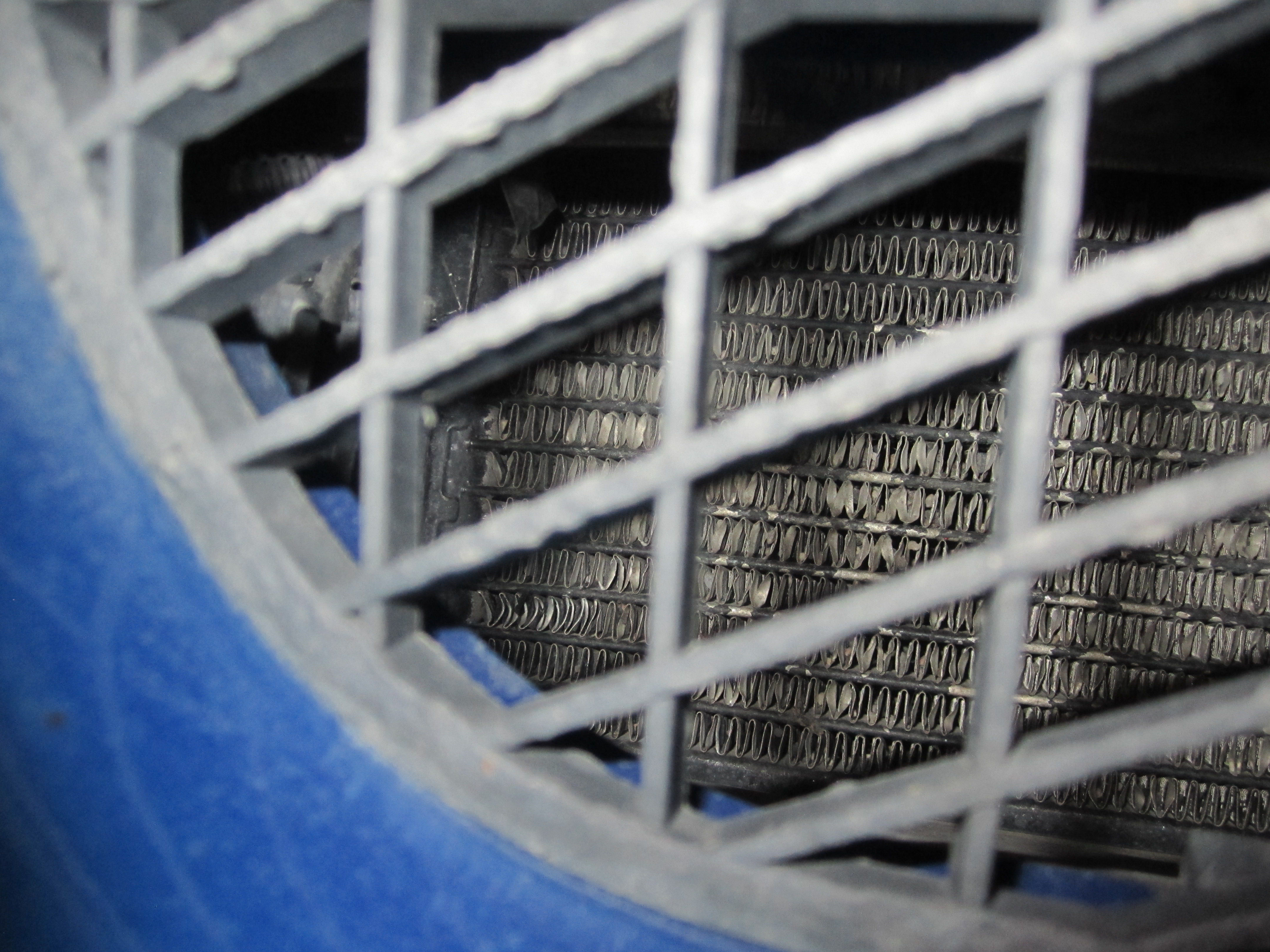

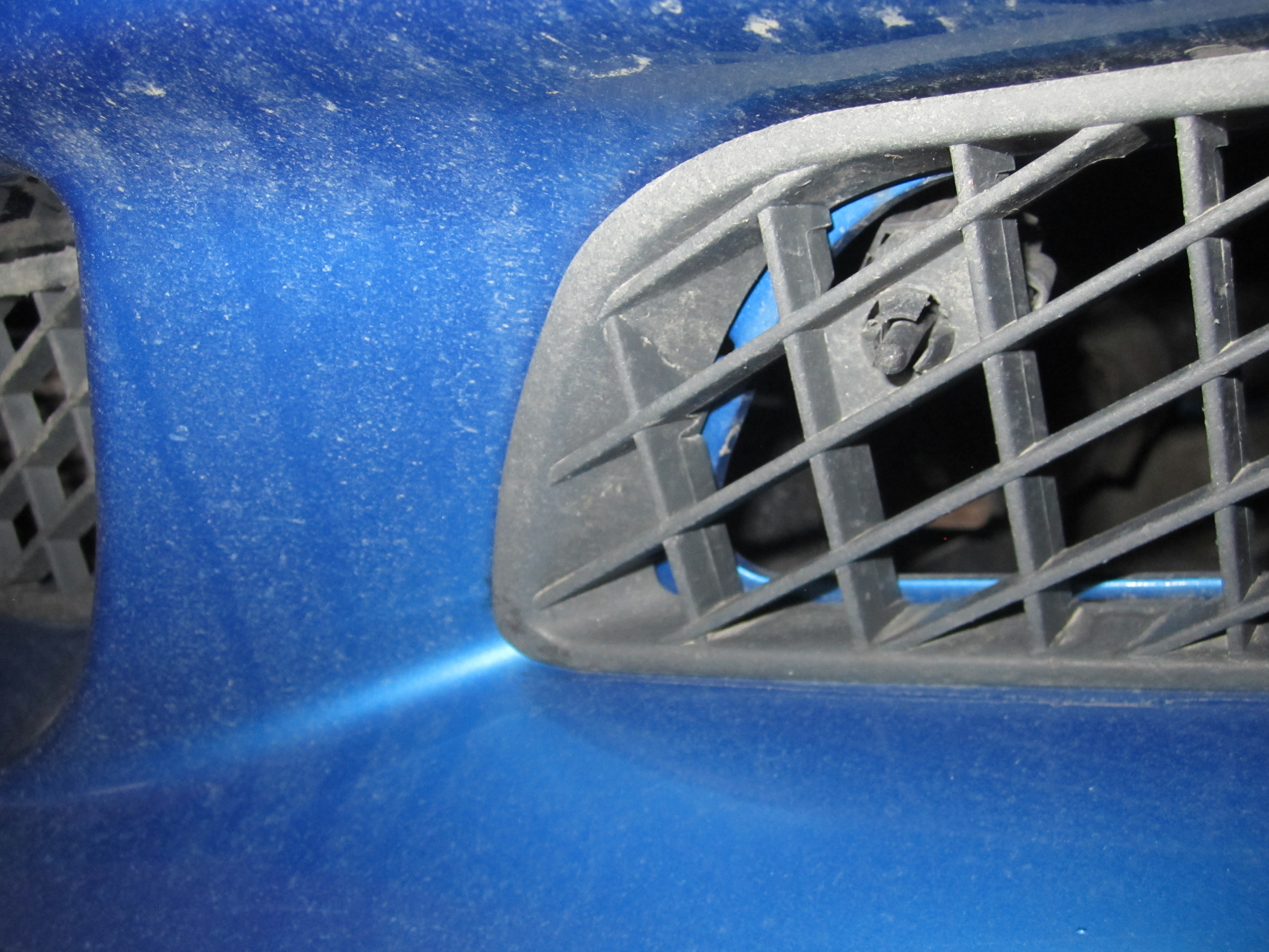

As to the weird temp reading fluctuations I'm not sure what is going on there. There are 2 temp sensors under the front bumper. The positions can vary depending on the vehicle version, but usually one either side of the radiator area. Check that they are positions correctly and have not fallen out. Also you could try removing them, and cleaning the contacts. I only have pictures of my 2000 R which has a different bumper to your car, so they are possibly in different places, but hopefully they may point you to here yours are placed.

The outside air temp reading jumping when the air conditioner is on is somewhat normal due to the proximity of the sensor to the air conditioner condenser coil. I wouldn't read a lot into that one.

Thanks guys! I'll take a look at where the air sensors are bouncing around right now. I bet aftet 16 years in the desert the plastic clips have disintegrated.
Also I just found that the Radiator has a leak in it... The horn assembly at some point got bent back to a point where it was rubbing on the radiator and now if has finally rubbed through it.

I think the radiator behind the horn is actually the condenser coil for the air conditioner, the engine cooling radiator is the last item in the sandwich. If it actually rubbed through then the air conditioner will not work at all.

So a little update. I JB Welded the condenser and it hung in for about an our in 95 degree heat. I also found where the air temp sensor was bouncing around in front of the condenser and zip tied it in a new location where I can actually see the out side temp. I also replaced TPS sensor with the contactless one. I was getting a 1.37v reading off of the new TPS and called that close enough. So far I haven't had any issues, but I'll know more after a few more trips.
