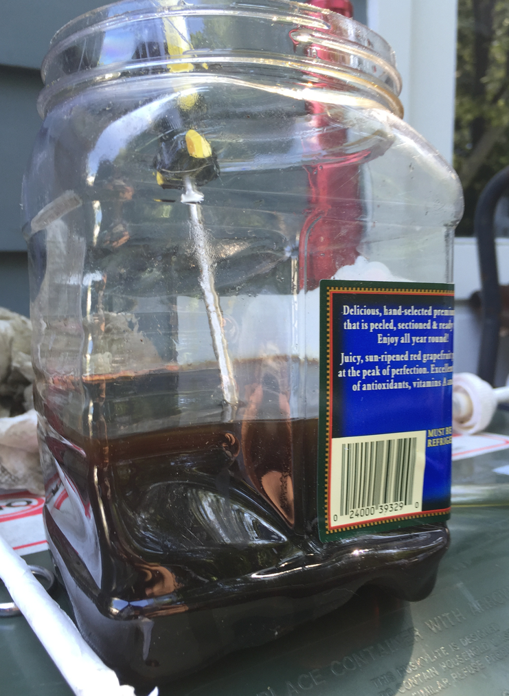

Did the deed today to celebrate passing 180,000.
I used a oil transfer pump (6.99 at Advance) to pump out 600 mL of PS fluid from the reservoir (next to the coolant tank on the 1999), filled to slightly overfull with PS fluid, drove to Advance to pick up new fluid, emptied tank again, then topped to correct level
Total flow through was 1.2 liter. Capacity is listed as 1 liter, so I calculate I now have 86% fresh, give or take.
Old fluid was nasty dark.
Screen Shot 2016-08-29 at 10.44.40 AM.png (1.36 MiB) Viewed 815 times
