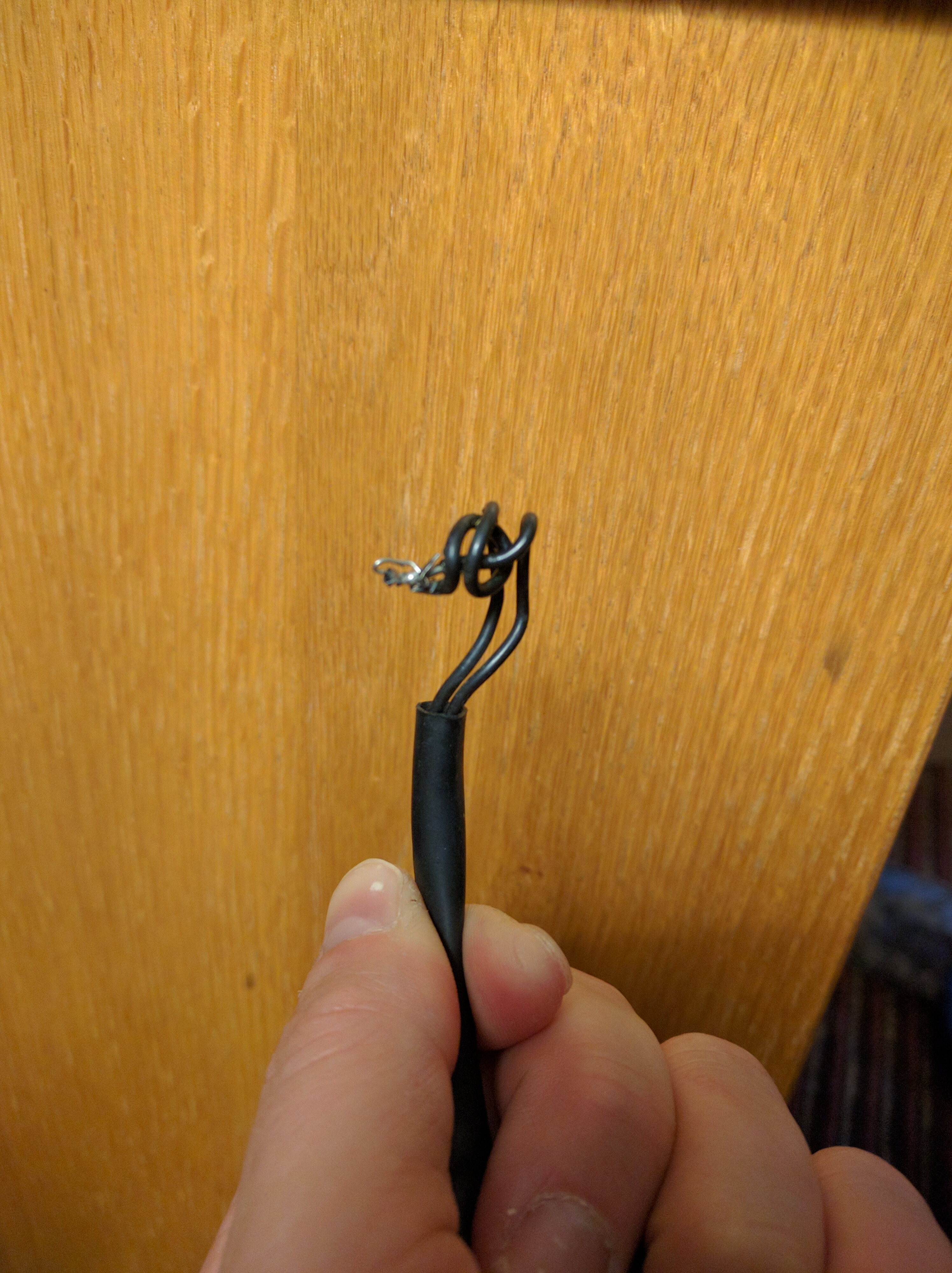

My 1999 S70 (otherwise known as Sophie the Sweedish Fish, for her lovely red color). I recently changed the expansion tank to fix a leak which worked. But as I changed the tank, I saw that the previous owner had yanked out the coolant sensor wires and twisted them together (see pic).
That is when I realized I should replace the sensor, especially because my Low Coolant light never came on when I had low coolant... which is dangerous.
Previous owner must have done this to make sure the light never illuminated while trying to sell the car as: "Totally Not Leaking Coolant, Everything is Fine! 8) " But it wasn't fine, it had coolant leaks from the heater core and expansion tank. But I fixed all the leaks and she is good as new, however...

The photo you posted above, what is it?
Cees Klumper
Posts: 365
Joined: 28 Dec 2013, 13:24
Year and Model: 2002 S80 T6
Location: De Luz Heights, Southern California
Has thanked: 46 times
Been thanked: 33 times
Post by Cees Klumper »
TS explained that the photo shows the way he found the coolant sensor wiring: tied together and not connected to the sensor.
