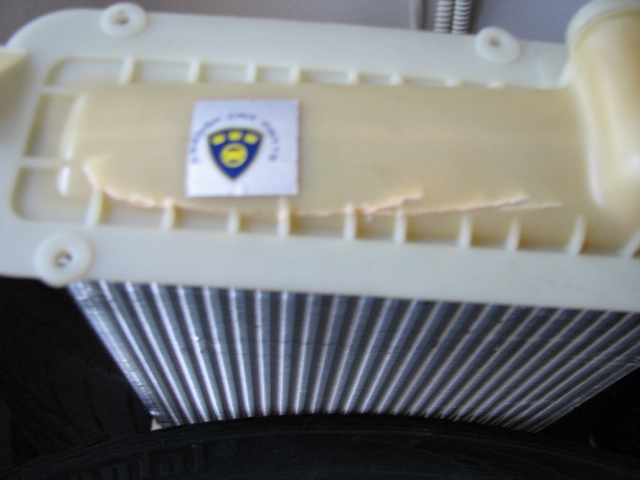

It is one month less than two years since had installed it.
I really didn't need a new one, but had to replace the fire wall coupling. I figured why not replace the heater core while I have it out.
I had replaced many things while I was in there.
Anyway, A couple weeks back, On my way to a gig in Traverse City, MI I had fueled up in Grayling, MI.
The system must have built some pressure while not running and I may have driven too soon.
Either way, this should not have happened.
Two blocks from the gas station a huge blast of steam came through the vents for about two seconds.
Long story short, the bottom tang blew on the two year old Swedish car parts heater core.
I will be putting the original one back in for now.
If the price seems too good to be true, there is probably a reason.
Swedish Car Parts Heater core Done.

I installed the same part about a year and a half ago and have had no problems. However, I too have always been a little surprised at how much loyalty there is to this part. I don't think anyone's had it installed long enough to really say it's as good as OEM, but that's been the conventional wisdom here.
Next time I change my coolant, I'll think about swapping in an OEM core.

I'm not the first.
I don't remember who it was that posted, but it was two and a half years for him and it failed in the same place.
