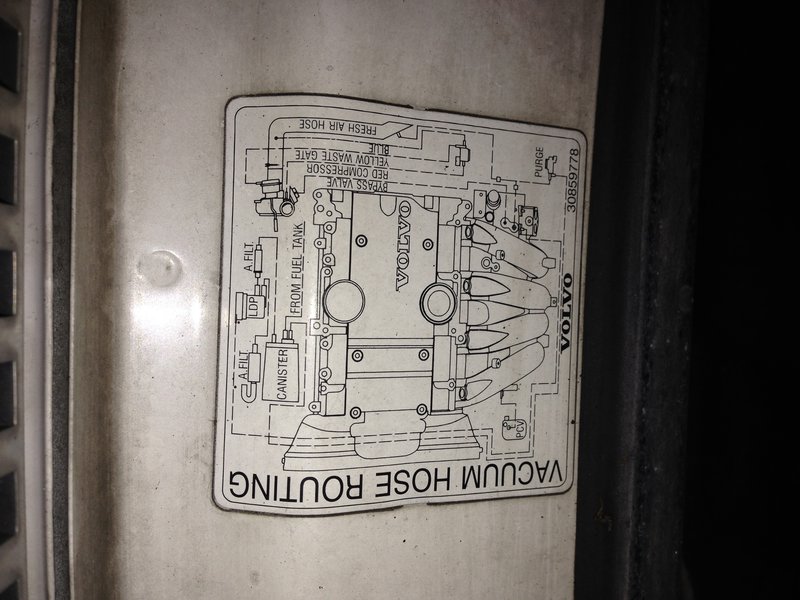

So - many hours and 125 pics later I am a little puzzled as to where a few of the many hoses
I took off / unplugged go.
All that to say - it would be greatly appreciated if anyone has a Vacuum Line diagram -
specifically for an 01 S40. There are lots of pics of 850, but no S40.
Any help would be more than greatly appreciated.
Tom

Guess what I found on the inside of my hood ??
