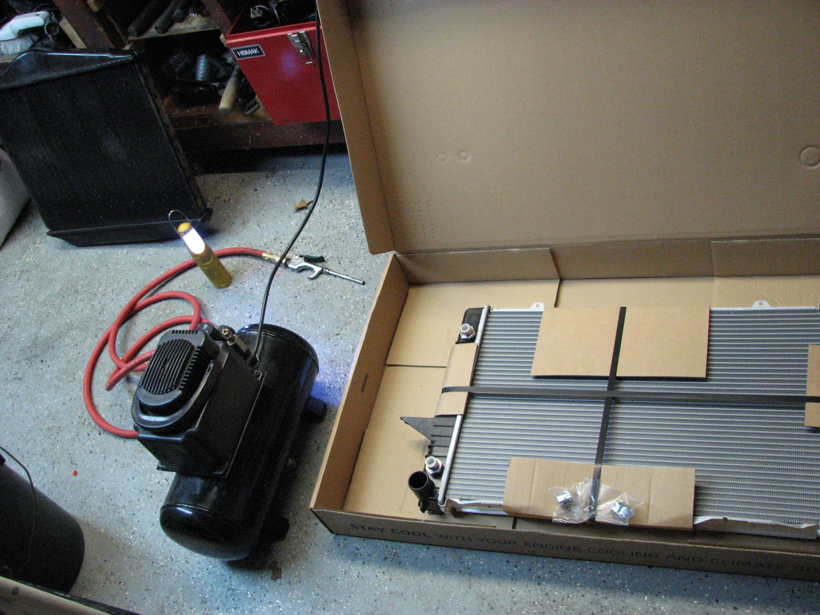

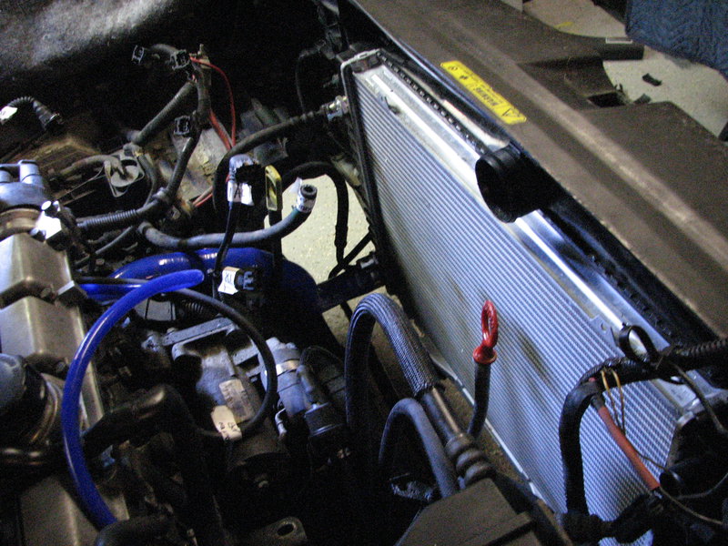

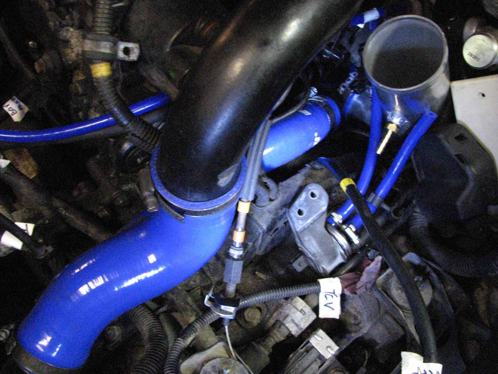

It was only last month
had had my second loss of coolant, blowing the aftermarket heater core.
It was also fortunate not to warp a head or lose a gasket after driving a mile or so.
Agree with j-dawg on Nissens. It is what is in the white wagon after the 30 degree below zero winter had purged the original. I feel I need to explain.
The first loss of coolant was a severed heater hose.
That is when I had put it up for all or the hose replacements, well, manifold, throttle body, ECU, 3" intake radiator. etc.
Two Weeks.
It had only taken that long while waiting for the Aisins Water Pump, and the radiator.
Two Weeks.
