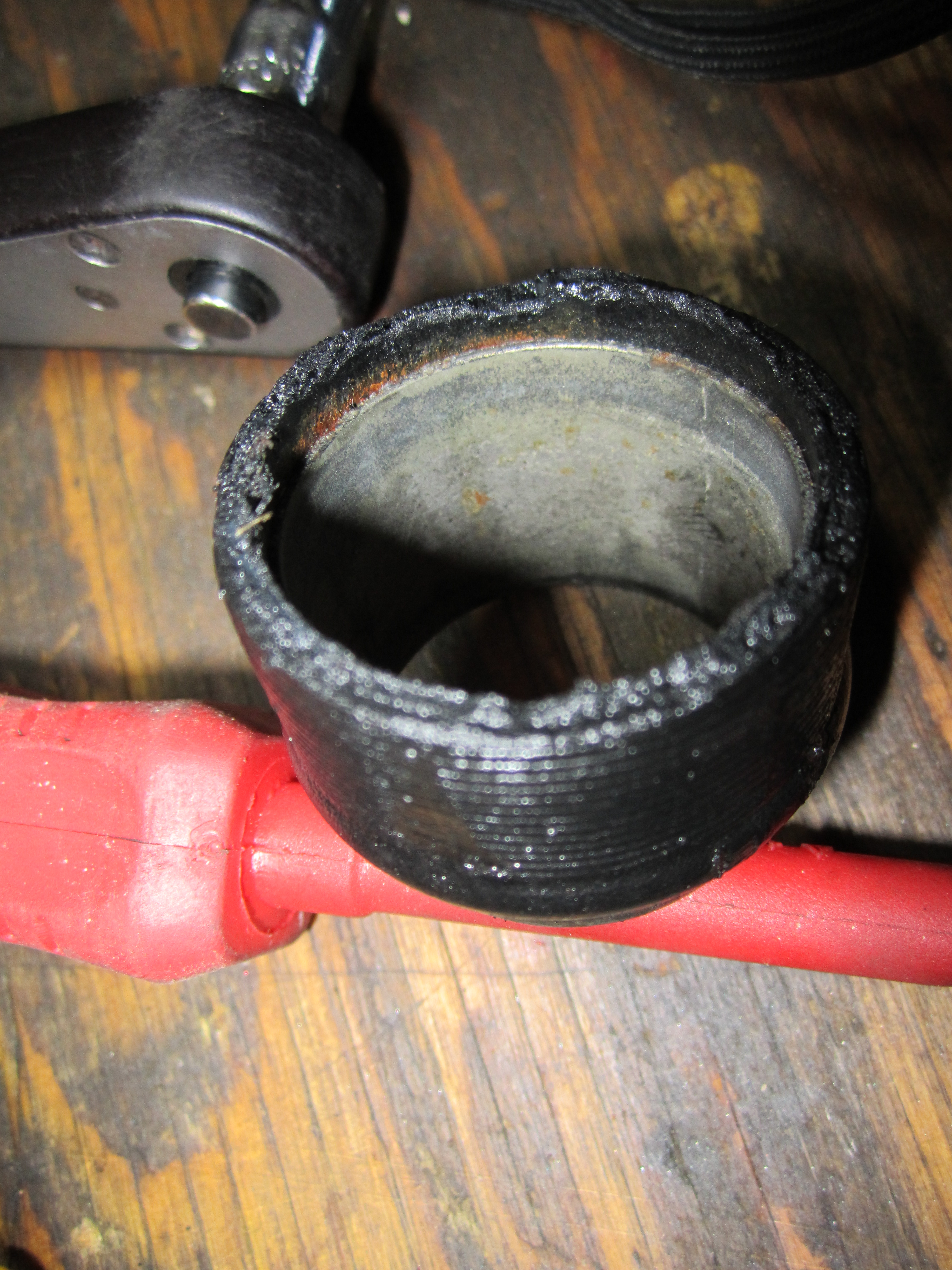

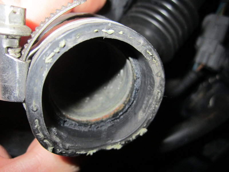

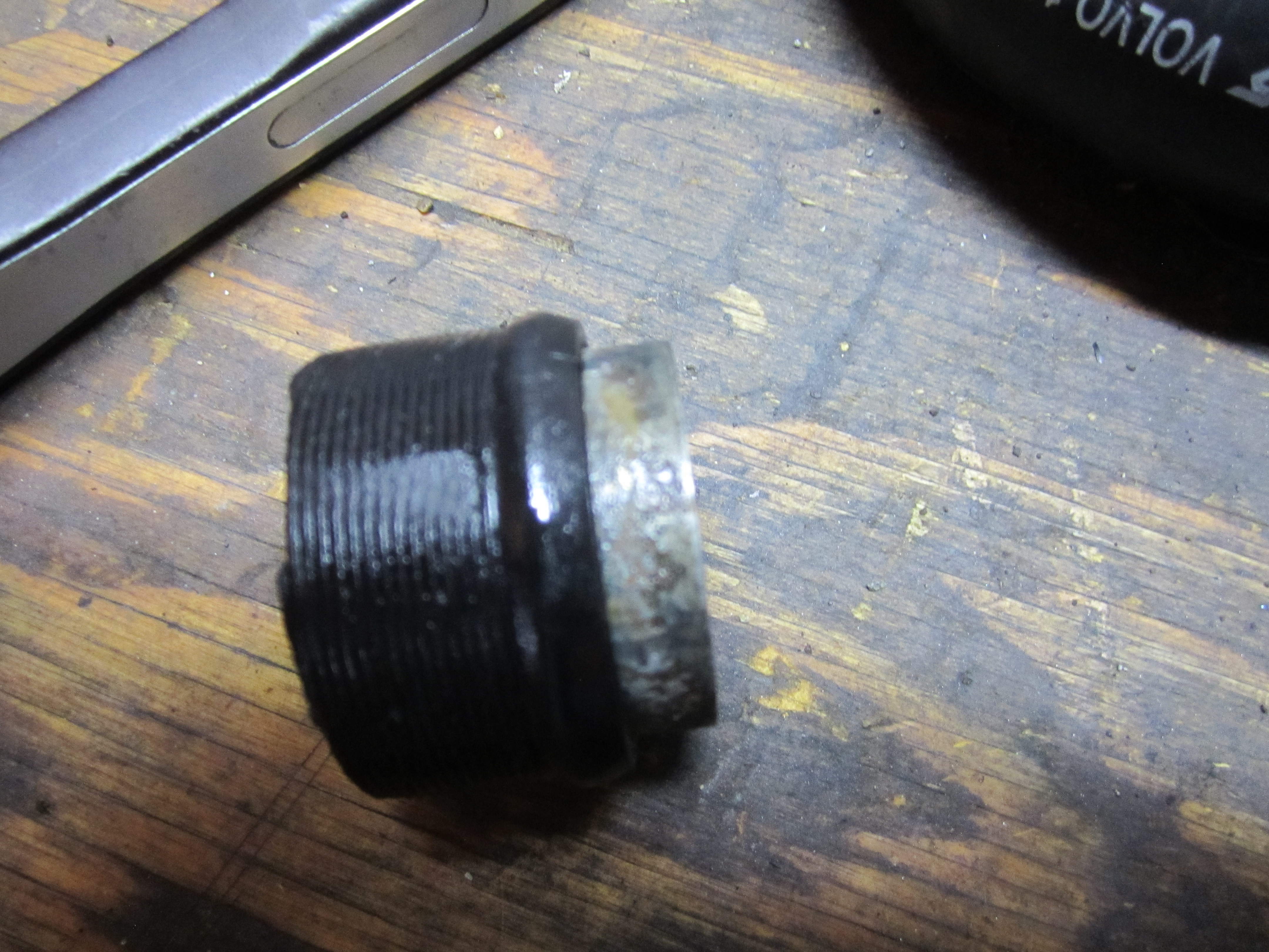

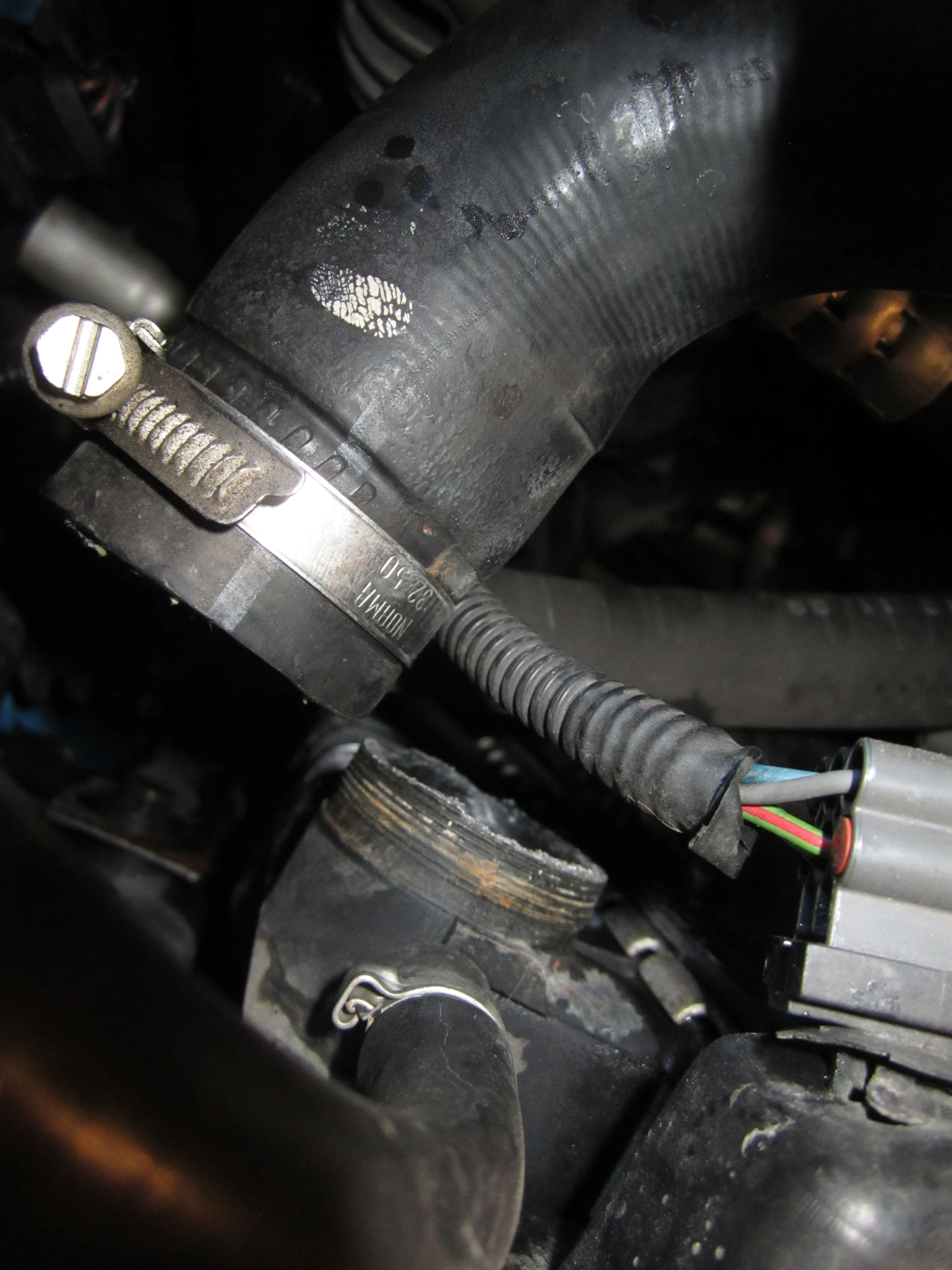

Pictures below of the OE radiator. So much for my belief the metal upper hose outlet sleeve reduced the likely snapping of the upper outlet. The best part is that the metal sleeve had slid out and it snapped where it should have been!
Makes me now think the OE part may not be worth it after all!
Thanks for the help again!

Thanks for the photos Neil. I now understand what happened. Geesh....bugger that...what a mess.
