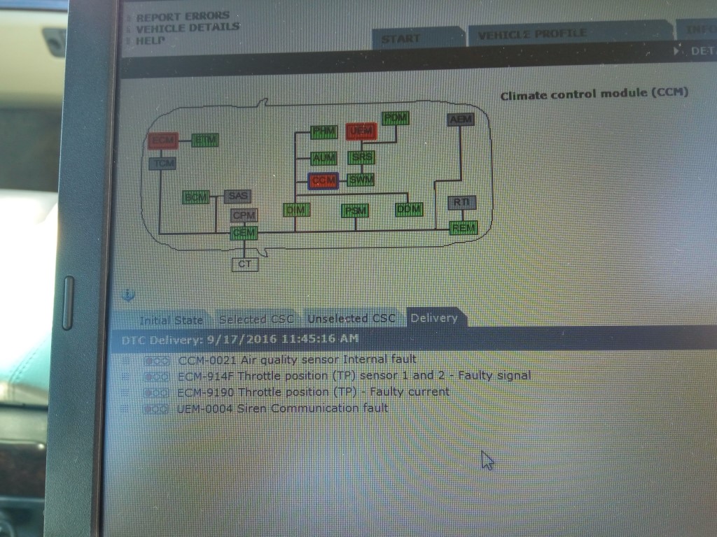

I have a 2001 S80 (2.4 170BHP) that has started running very rough, sounds like it is not firing on all cylinders, MIL light is on. I have had an error for a long time with the VVT Solenoid, so im ignoring that for now. It now has an error in reference to the Throttle Position sensor.
So i plugged in my Vida and got the attathced screenshot. Am I right in thinking that this is most likely going to be the ETM?

Looks like ETM failure, yes
Ok, is it worth seeing if I have the 2006 update and trying to run the ETM test to confirm?

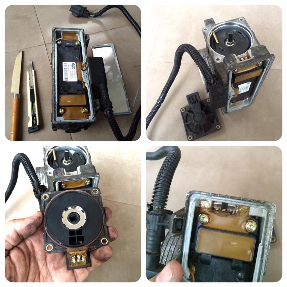

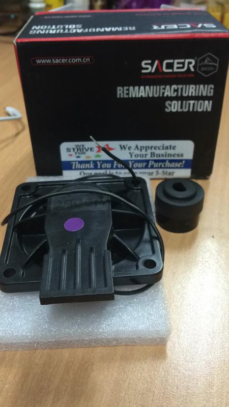

Hi Djh82uk,
I have same problem...One week ago i was tried to repair the ETM with Sacer TPS.
Alhamdulillah, it's works.
You can see the tutorial and discusing about the Sacer's installment on : https://www.matthewsvolvosite.com/forums ... 4&start=10

I don't think a Sacer will repair that particular ETM because there is a failure of both sensors at the same time (highly unlikely) and points to a faulty board.
You have VIDA so go to Communication-Network tab then highlight the ETM icon. It will report the 2 x software part numbers that your ETM has installed. Show me a screenshot and I'll tell you if it's updated or just do the ETM test. In the ETM sweep test the actual software numbers aren't revealed.
When replacing with a used ETM matching these 2 software part numbers will ensure the engine rums properly.
